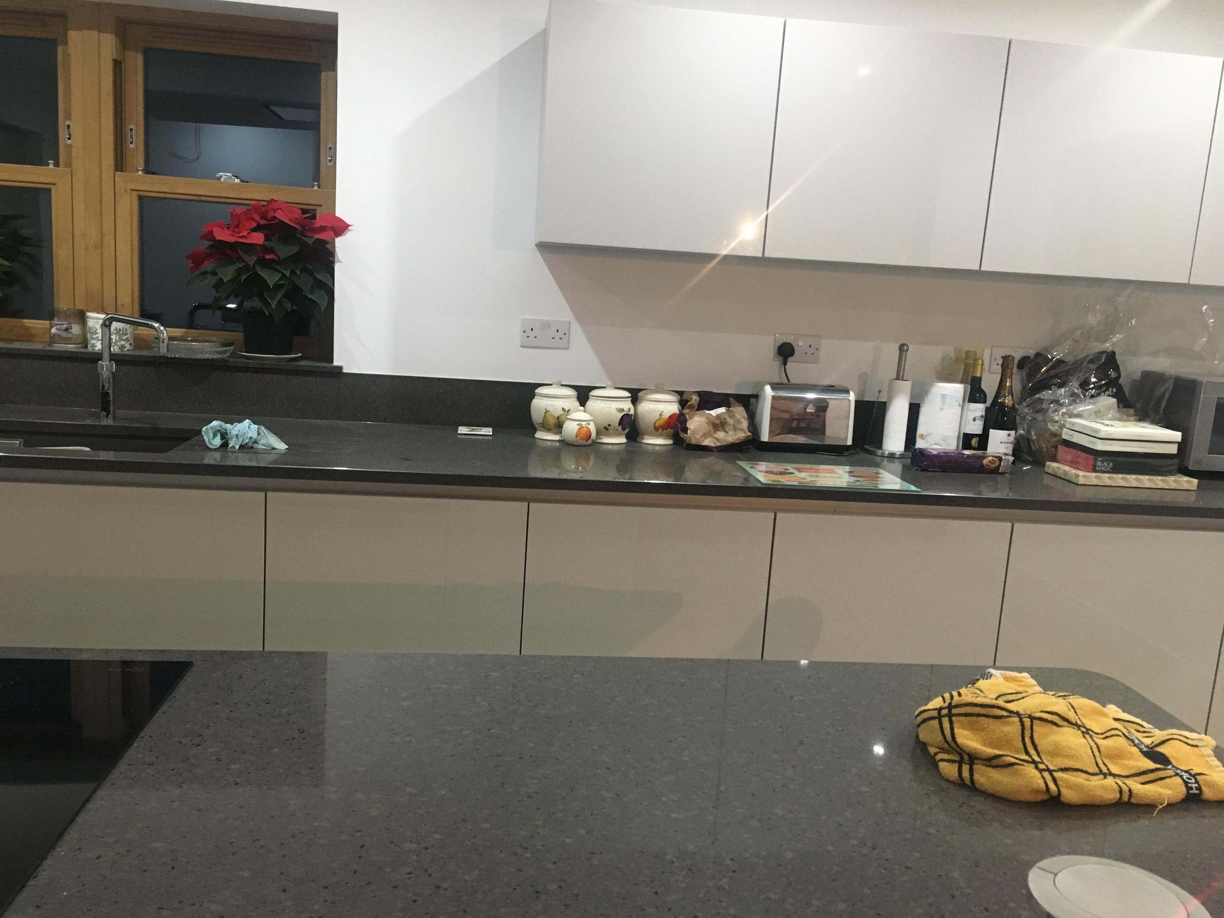

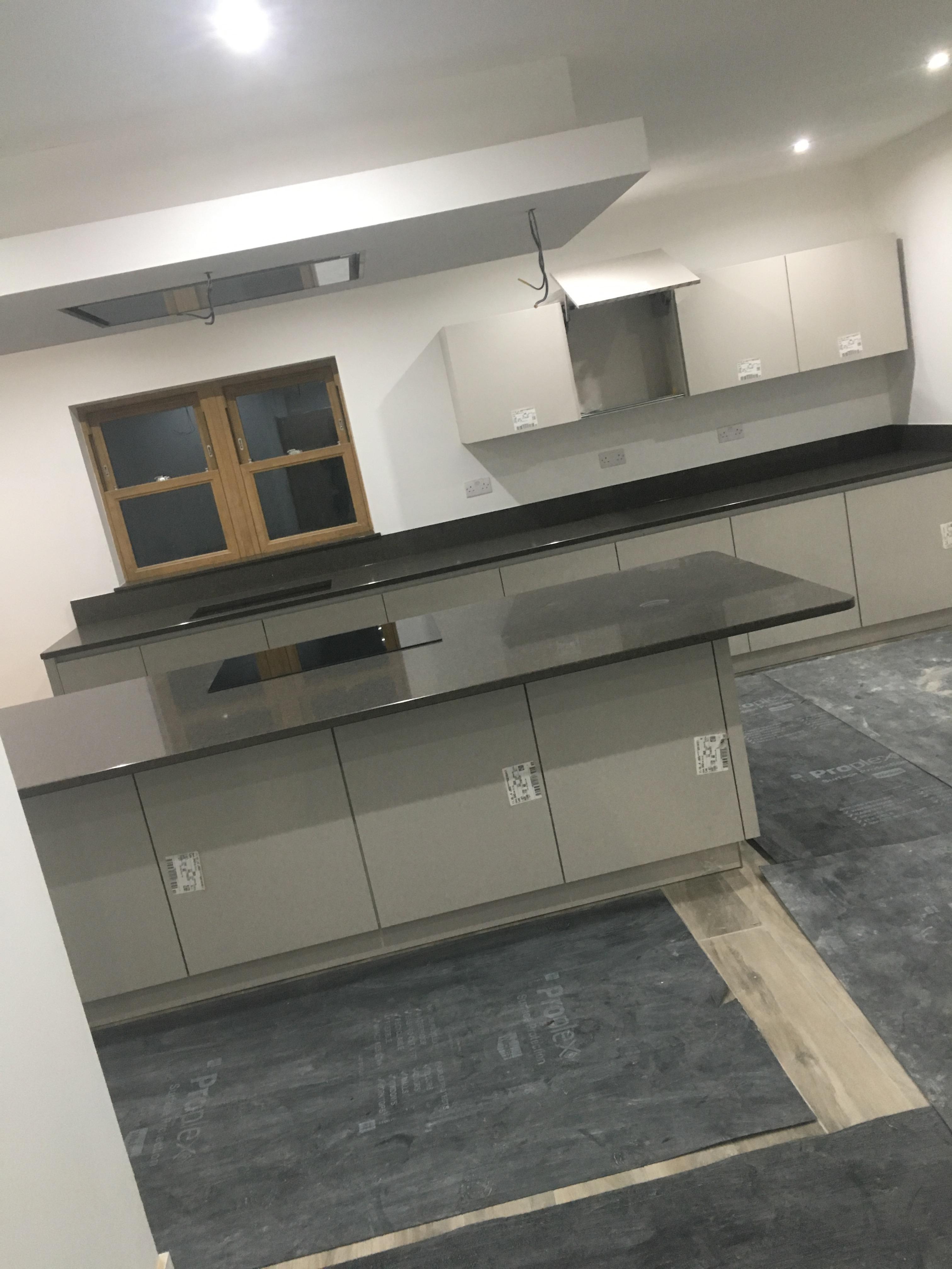

nod Posted December 26, 2018 Share Posted December 26, 2018 2 hours ago, howplum said: Thinking about our new kitchen design, I'm wondering about the best way of accommodating the various appliances and storage vessels that currently have taken up permanent residence on a fair part of the 600mm wide worktop in our current home. They include, but are not limited to, toaster, bread bin, kettle, fruit bowls, rice container and chopping board rack, occasionally joined by a broiler and/or slow cooker and/or food processor. Obviously they limit the amount of convenient working space. To further make the problem relevant my wife has problems lifting things, so storing them in a cupboard is not a viable option. One thought I had was to utilise a wider worktop, say 750mm, but this would then make access to wall cupboards tricky, although in an ideal world I would like to dispense with wall cupboards altogether, but that might be a point for discussion! I also appreciate that a wider worktop would potentially lead to wasted space behind the units, although drawer runners up to 700mm are available, which would mean deeper base units and drawers, which might have to be built to order. Still, it would mean about 40% more storage, and therefore help to compensate for the lack of wall cupboards. I am planning to have all drawers anyway, since it makes life so much easier. Another fanciful, and probably dangerous, idea I had was to have a tall cupboard with pullout shelves on which would sit the various appliances and storage containers. Any alternative ideas or experiences would be appreciated. I’ve installed a 750 worktop and it’s worked well I thought my wife was barking when she suggested it ( Insisted) But I have to admit it looks ok and does the job nicely The only drawback is the sash window is hard for her to open But at six foot four It’s nice to be of use for something ? Link to comment Share on other sites More sharing options...
nod Posted December 26, 2018 Share Posted December 26, 2018 1 minute ago, nod said: I’ve installed a 750 worktop and it’s worked well I thought my wife was barking when she suggested it ( Insisted) But I have to admit it looks ok and does the job nicely The only drawback is the sash window is hard for her to open But at six foot four It’s nice to be of use for something ? No more work to install Actually made it easier having a void behind the base units Wires and a waste pipe I needed to move Link to comment Share on other sites More sharing options...

nod Posted December 26, 2018 Share Posted December 26, 2018 30 minutes ago, Hecateh said: If you do go for wall cupboards at all I thoroughly recommend a bifold door opening upwards. When I am working in the kitchen which involves putting things away or getting them out the doors stay open without getting in the way or risk of banging head. Then closed when all is finished. Top shelves just for things that are rarely used of course 1 Link to comment Share on other sites More sharing options...
