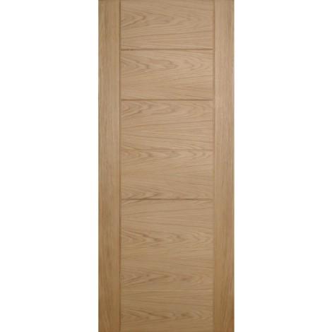

Onoff Posted December 23, 2018 Author Posted December 23, 2018 9 hours ago, joe90 said: Yup. I hate doors that stick because they are too tight in the frames, 2mm is what I use, plenty of Space for paint . Ta. Thinking an oak veneer door eventually, like this: https://www.selcobw.com/products/doors-windows-stairs/doors/internal-doors/palermo-internal-oak-door-1981-x-762-x-35mm-6-6-x-2-6-fscr Any problems with this type (veneer) in a bathroom setting? Planning as I said elsewhere to re-use the old door "for now". I am assuming it's bad very roughly fitted before. Hinges only about 2" long, barely let in. Should I aim for brass, st/st hinges? 2 or 3? At the mo the hinges are 195mm in from each end. I'll just re-cut for the new hinges at the 6" top / 9" bottom positions. Need to assess how square the existing door is and delve down the shed to see what hinges I have.

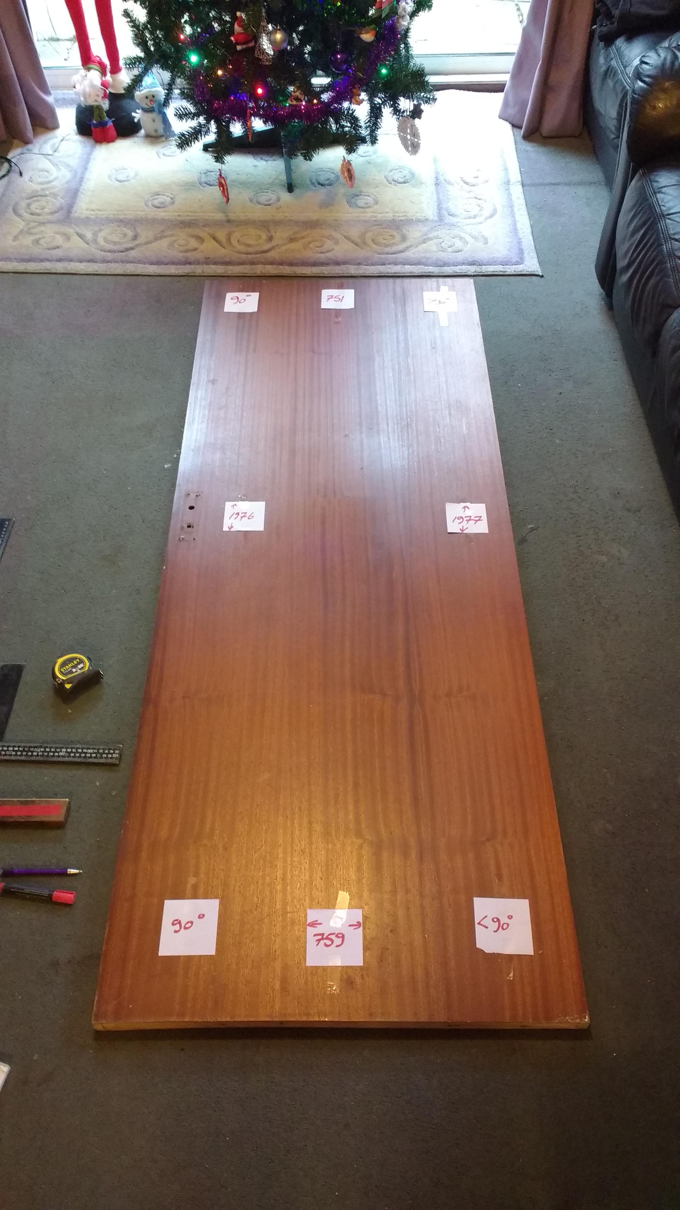

Crofter Posted December 23, 2018 Posted December 23, 2018 4 hours ago, Onoff said: You've lost me...build lining around door? Make up your lining and assemble the three pieces, leaving the jambs over long. Header should be measured to give an opening at least 4mm wider than the door. Tack a bit of batten across the top of the roughed out opening, rest your door against this with something to prop it up. Shim up the bottom of the door to give the desired clearance to the floor, and to bring it level. The brand new door should be perfectly square- mine were anyway. Lift the lining into place around the door. Determine how much you need to chop off the jamb on each side, and cut to size. Install the liner into the rough opening using packers as required to maintain the desired gap all around. Ideally you can fix it using screws which will be hidden underneath the stops. You probably knew half of that already 1
Onoff Posted December 23, 2018 Author Posted December 23, 2018 44 minutes ago, Crofter said: The brand new door should be perfectly square- mine were anyway. IF I was using a brand new door! Going to trim it down to 750mm width (it's 751 at the top) to square it up then graft a 12mm strip up the hinge side to bring it back to 762mm. Anyway it's only temporary...like the carpet... "Fire up the router!"
Onoff Posted December 23, 2018 Author Posted December 23, 2018 (edited) So I made a router jig. Worked an absolute treat. 3" hinges fit like a glove: Needs a bit of sanding... Pity I did 6" at the bottom and 9" at the top! Turned the effin door through 180 like an idiot! They're now through housings... Edited December 23, 2018 by Onoff 1
