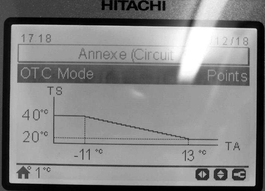

ragg987 Posted December 14, 2018 Share Posted December 14, 2018 I use the compensation control that is already built into the heat pump, so no extra stuff required other than the separate controller / thermostat. Though it took a but of fiddling to find the best heat curve, the ones pre-programmed were not suitable for our build. The flow varies from about 22C to 30C when below zero outside. I found leaving it on all the time to provide the best COP, when I use the timer it took a big hit. Presumably this is as it runs at a higher temperature differential due to cooler slab. Link to comment Share on other sites More sharing options...

swisscheese Posted December 14, 2018 Author Share Posted December 14, 2018 1 hour ago, ragg987 said: I use the compensation control that is already built into the heat pump, so no extra stuff required other than the separate controller / thermostat. Though it took a but of fiddling to find the best heat curve, the ones pre-programmed were not suitable for our build. The flow varies from about 22C to 30C when below zero outside. I found leaving it on all the time to provide the best COP, when I use the timer it took a big hit. Presumably this is as it runs at a higher temperature differential due to cooler slab. 9 minutes ago, JSHarris said: IIRC, that's not that dissimilar to the default curve that ours came with, except I have a feeling that it went to even higher temperatures under those conditions, which inevitably resulted in it doing lots of defrost cycles. I've not seen ours defrost at all now I have it set to a constant 40 deg C; it seems that our system never puts enough load on the unit for it to reach the defrost threshold. Having a unit with probably three or four times the output we actually need for heating probably helps, as it means the evaporator is over-sized for our needs. This means that the fan and compressor tend to run at about their lowest speed most of the time. Heating isn't our biggest electrical demand, either, most days it's less than the hot water demand. What I need to do is systematically work through the low power, always on, loads, as they seem to be some of our biggest energy consumers. It's things like the ~1 kWh/day to run the treatment plant and the ~ 0.8 kWh/day for the water UV treatment unit, that push our background load up. I'm currently set on a compensation curve - but the unit is defrosting more frequently than I would like, and then working hard to reach temp when the thermostat timers knock the temp down overnight, possibly too much. So it may have the wrong compensation curve, or be slightly undersized ASHP for the temperature, I did all the calcs as did others and the 9Kw unit should be enough. I think I'll try a KISS methodology and set a flow temp and limit the temperature differentials on timers on the thermostats and see how it goes. Link to comment Share on other sites More sharing options...
ProDave Posted December 14, 2018 Share Posted December 14, 2018 A few of us have found if you limit the flow temperature to 40 degrees that seems to mostly eliminate defrosting. So set a fixed temp or adjust the heat curve so it never goes over 40. In cold weather it may just be better to leave it on all day and night with no set back. 1 Link to comment Share on other sites More sharing options...

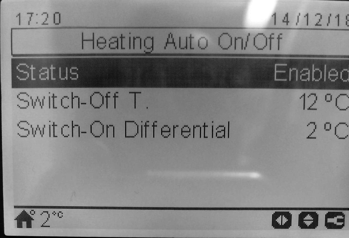

ragg987 Posted December 14, 2018 Share Posted December 14, 2018 45 minutes ago, swisscheese said: working hard to reach temp when the thermostat timers knock the temp down overnight, possibly too much I think this is what gives the poor COP, hence I leave it on all time at the same temperature. FYI, here is the custom curve I arrived at by trial-and-error, seems to work well for our low energy build. And an image of an optional setting that means I can be hands-off all year round and the HP takes care of itself. Link to comment Share on other sites More sharing options...
ragg987 Posted December 14, 2018 Share Posted December 14, 2018 Should point out - that Auto On/Off setting is based on a 24hr average. Link to comment Share on other sites More sharing options...

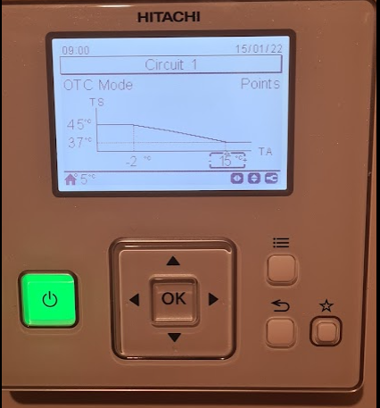

Fonyt Posted January 15, 2022 Share Posted January 15, 2022 Hi folks, I know this post is really old, but I'm at a loss and it's the only one that I could find on Google that is relevant to some issues I'm having. Our heat pump has been running constantly recently and it's costing us a fortune, about 6 months ago the machine was knocked off during a power outage and was reset to factory, I followed the recommended setup but it's not been right since. Our thermostat is set to 21°c, but room temp at 22.5°c (way too warm - verified with a separate temp gauge). The company who installed our Yutaki M Heat Pump have since gone out of business and any of the literature I've found I can't really make sense of. Could anyone explain the the points, gradient and fixed modes for me, what do the temperature relate to? Any recommendations for a generic setup for the UK climate. Thanks in advance. Link to comment Share on other sites More sharing options...

J1mbo Posted January 15, 2022 Share Posted January 15, 2022 (edited) Fixed flow temp is the worst possible configuration for ASHP. This is why the controls have sometimes almost endless configurations all centred on reducing the flow temps whenever possible. That said, if it’s an underfloor heating setup needing only 30* flow anyway, then clearly all that complication is going to yield minimal gain. Edited January 15, 2022 by J1mbo 1 Link to comment Share on other sites More sharing options...
Fonyt Posted January 15, 2022 Share Posted January 15, 2022 58 minutes ago, MikeSharp01 said: Hi - And welcome to the forum, I am sure someone who knows more than I will be along shortly. Power outages can do damage to stuff as well as resetting it so it may be that you stat is damaged, if you wind the stat right down does the ASHP stop working? At any rate probably best to provide some details of the setup. Does it also do Domestic Hot Water (DHW) or just heating? Do you have a schematic of your system you can share with us? 1 minute ago, J1mbo said: Fixed flow temp is the worst possible configuration for ASHP. This is why the controls have sometimes almost endless configurations all centred on reducing the flow temps whenever possible. Thanks for your replies. I don't have a schematic, but I can provide an overview of our system. House is 230m2 with 4 thermostat controller bedrooms Hitachi Yutaki M4 11 kW Monobloc Heat Pump & Hitachi Main Controller Air permeability 1.4 m3/h.m2 Underfloor heating throughout Hot water cylinder 1 circuit covering downstairs and upstairs Downstairs wireless thermostat controls the overall system - so in theory when it hits its temperature (21°c) it turns the both the circuits off. Upstairs thermostats are wired and only control the manifolds, they are set to close at 18°c. The system is currently set on points and looks like this: Let me know if there's any other information that would help, thanks. Link to comment Share on other sites More sharing options...
Kevm Posted January 16, 2022 Share Posted January 16, 2022 I have radiators with my ASHP and that curve is hotter than mine. Should it be lower? Link to comment Share on other sites More sharing options...
J1mbo Posted January 17, 2022 Share Posted January 17, 2022 It should be set so that the desired temperature is just reached and maintained. The idea is to have the lowest water temperature possible. Link to comment Share on other sites More sharing options...
