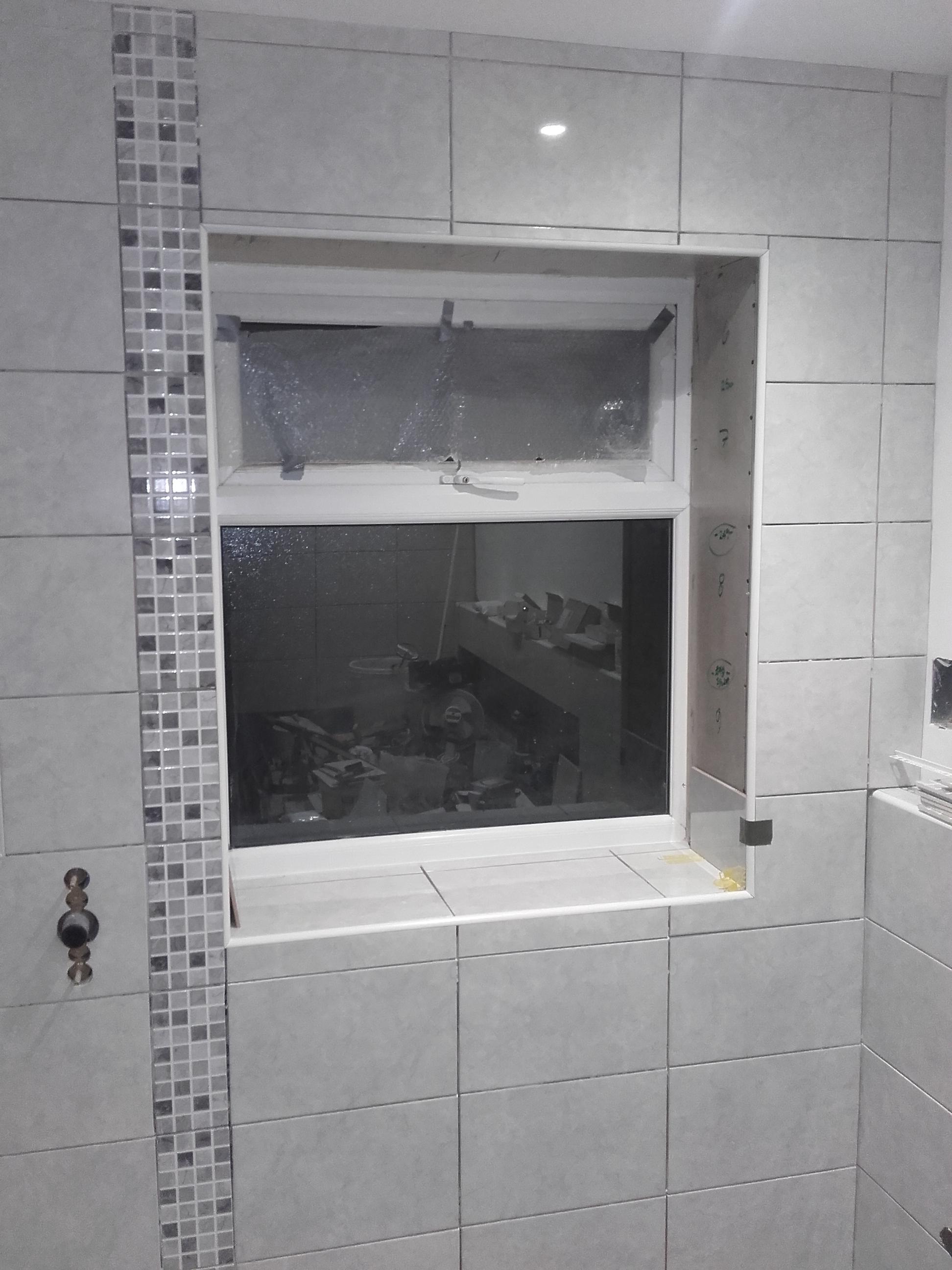

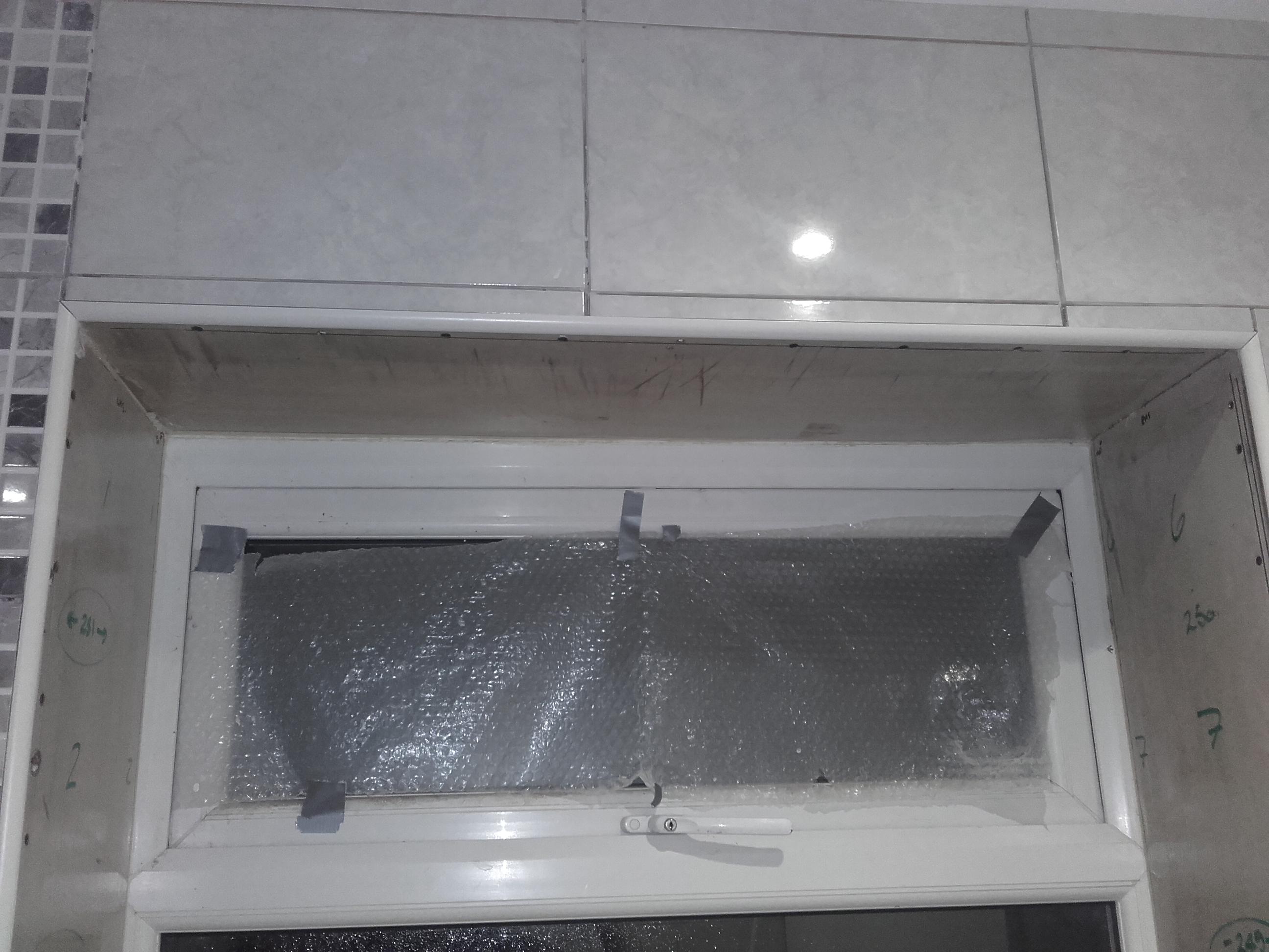

Onoff Posted November 30, 2018 Posted November 30, 2018 Do thermal blinds work? I'm figuring metallic ones must as in reflecting heat back into the room. I'd originally envisaged a blind external to the reveal to cover in part the 3 narrow rips above the reveal. I think though, once grouted they'll look OK. So now thinking a blind in the recess. Anyone used these? https://www.blinds-2go.co.uk/energy-saving-thermal-blinds.htm?
