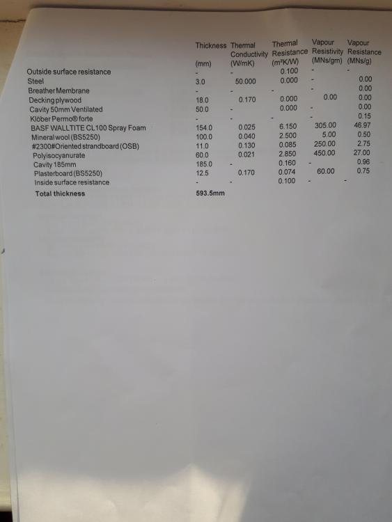

D Walter Posted December 12, 2018 Author Posted December 12, 2018 We got more detailed information on the thermal bridging from the EasiJoist webbing from two sources and it looks much better than we feared. We have decided on breather membrane on top of 254mm EasiJoists, spraying 154mm of foam directly under the membrane and an additional 100mm of soft roll underneath to fill the remainder of the EasiJoist space. We will have an additonal 60mm of PIR under the EasiJoists. There will be a ventilated 50mm batten cavity above the Easijoists with standard lay up for Tata above (18mm OSB, breather membrane and Tata). This gives us a U value of 0.1 with no condensation risk. It will also give us a really good head start on airtightness for the MVHR system. We did look at having 25-60mm of PIR (not foil backed) above the EasiJoists and spraying directly under that (with a view to countering the potential cold bridging from the steel webbing) but the calcs showed a risk of condensation. On speaking to one of the technical teams we were told that because the spray foam bonds with the PIR there should be no increased risk of condensation as there is no surface for condensation to form on but the calculation programmes cannot cope with this level of sublety so to be safe and for guarantee purposes we are going with spraying under the breather membrane instead. 1

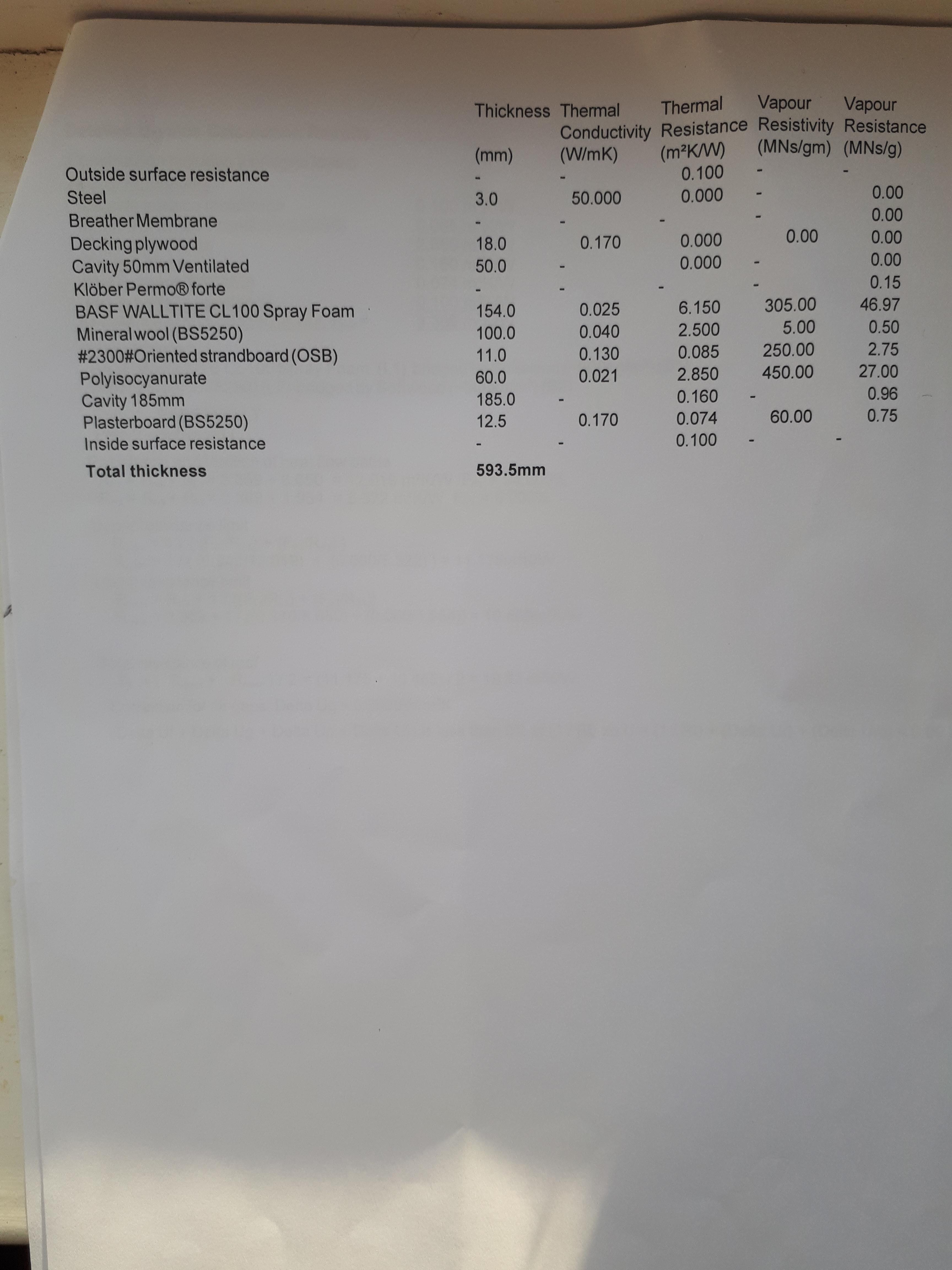

D Walter Posted December 13, 2018 Author Posted December 13, 2018 Hi Adllan, I attach one of the calcs. The other one was not quite as good but had less information. The details of the EasiJoist values are on pp 21 and 39 of the manual: https://www.wolfsystem.co.uk/media/114954/easi-joist-tech-guide-v8-6th-edition.pdf On speaking to the BASF technical team the view was that it was possible to get better overall U values and mitigation with cold bridging with EasiJoists than timber rafters as the Walltite will completely fill the gaps between EasiJoist cords and the holes within the webbing. The Wolf manual suggests no difference. 1

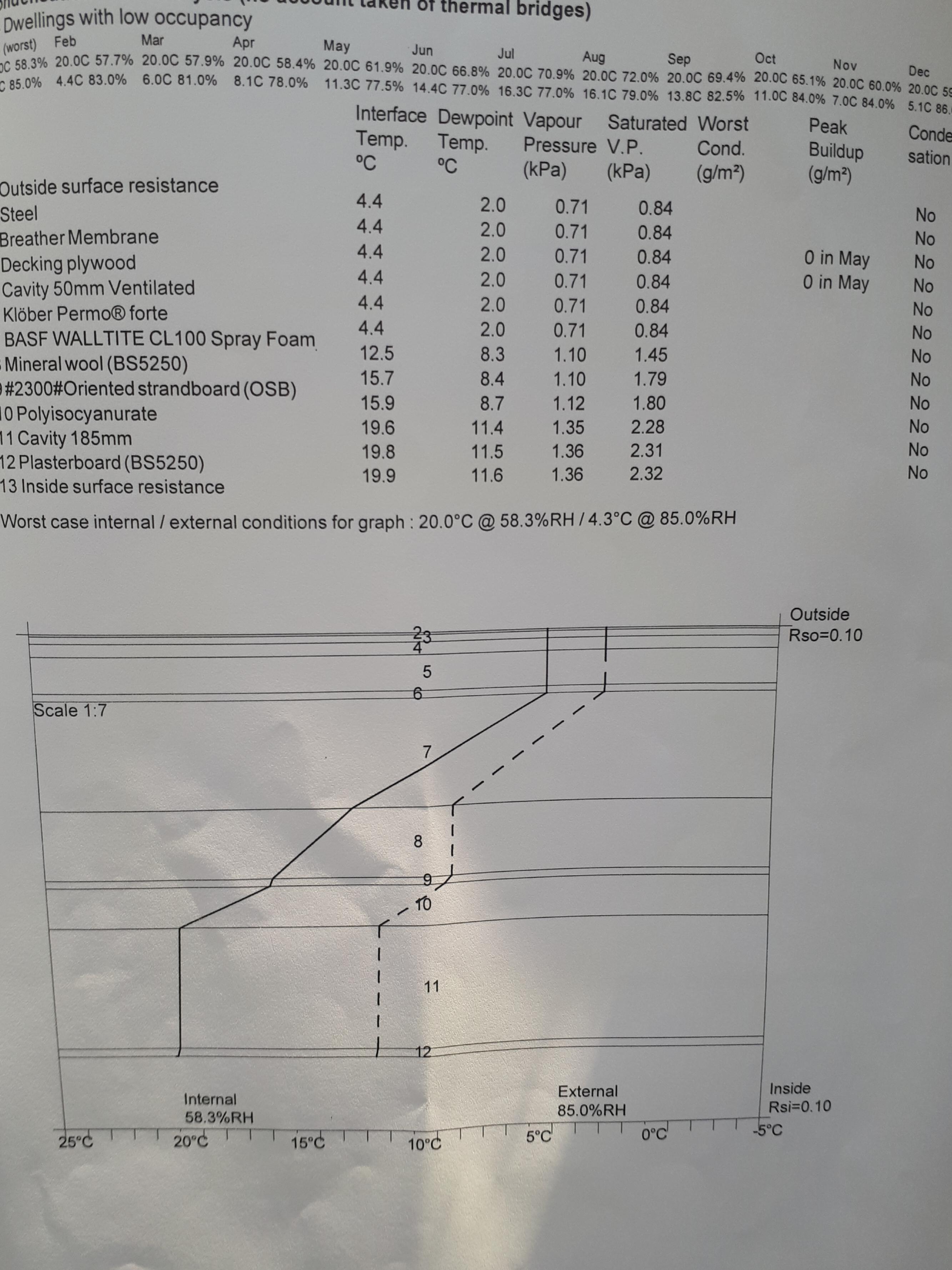

D Walter Posted December 13, 2018 Author Posted December 13, 2018 We did check about compromising the breather membrane and we are promised copies of confirmation from various manufacturers that the breather membrane will still work. The Walltite does allow some degree of vapour permeability though it is closed cell and whilst the breather membrane is primarily acting as a surface to spray against, the breathability, even if reduced by the Walltite, does have some advantage.
ADLIan Posted December 13, 2018 Posted December 13, 2018 Thanks for that. Yes the 'breathability' of the breather membrane is swamped by the materials internal/external to it so it becomes irrelevant. Just one warning the U-value does not include any correction for the metal webs (see dUf = 0.000 approx 5 lines from bottom of 1st page). All this metal bridging 2 layers of insulation will impact the overall U-value though offset to a degree by the continuous layer of 60mm PIR. The correction should be included in the calculation and may add 0.03 to 0.05 (?, more?) to the calculated value of 0.09 W/m2K.

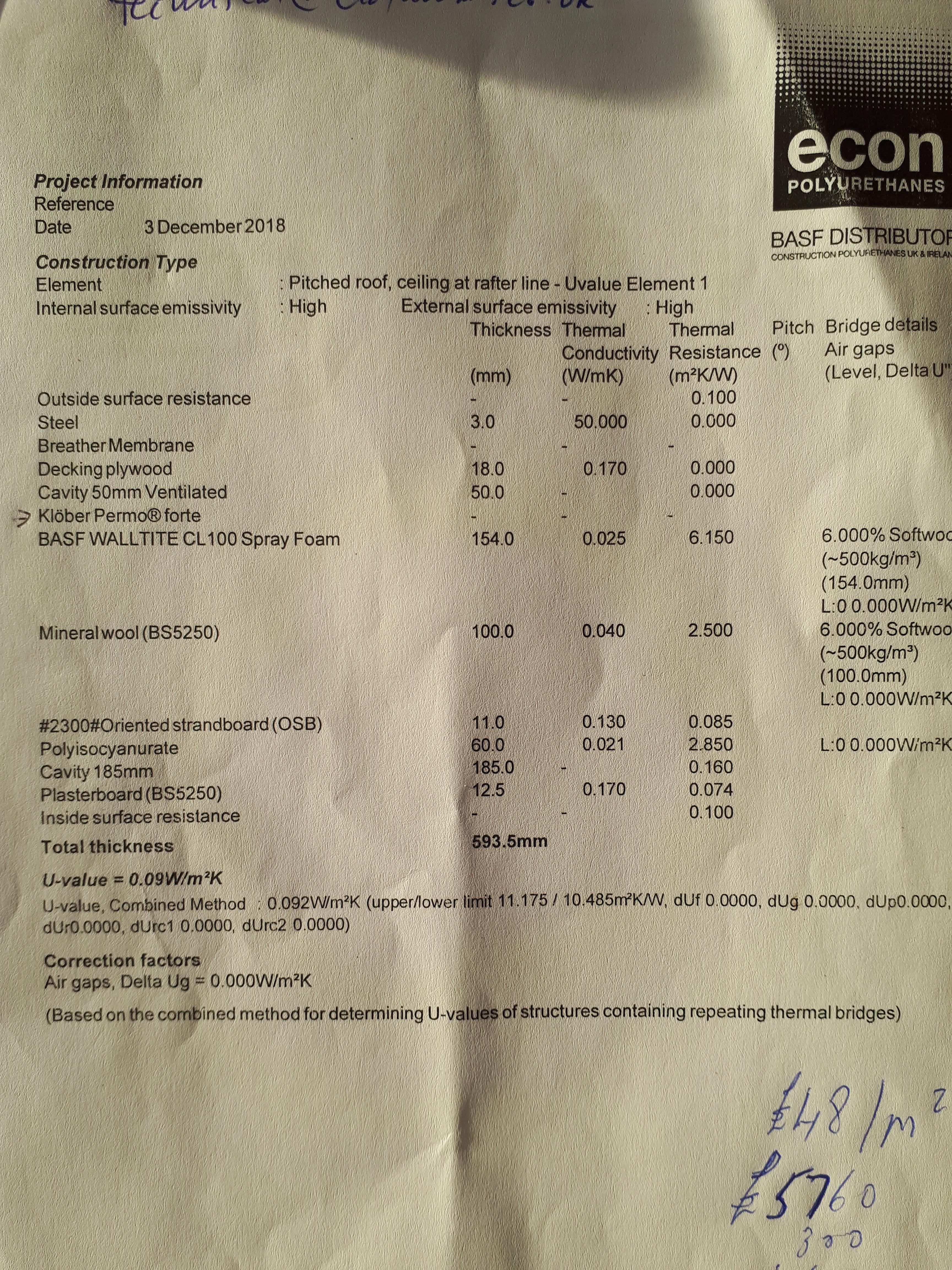

D Walter Posted December 14, 2018 Author Posted December 14, 2018 Thanks ADLlan. The attached link is to the Ecotherm calcs which are not as good but still ok. Their comment in the covering letter was: "This construction achieves a 0.10W/m²K U Value. There is no risk of condensation shown in the construction so we find this construction acceptable from a condensation risk analysis point of view.". I did discuss these calcs with the BASF technical team and they stood by their calcs as they said that the complete infilling of the EasiJoists with Walltite (including the holes in the webbing) reduces the EasiJoists' cold bridging. They also said that the Ecotherm calcs were ok as the max condensation risk shown was in the 50mm ventilation void. 5K15CB4023.PDF5K15CB4023.PDFFetching info...
ADLIan Posted December 14, 2018 Posted December 14, 2018 (edited) No problem with the condensation risk analysis - generally you have decreasing vapour resistance materials from inside to out plus the ventilated airspace so all should be OK. As you have a cold roof there should be a vapour control layer on the warm side of the insulation, this will increase the margin for safety in the assessments. However both sets of U-values do not include any correction for the thermal bridge created by the metal webs passing through the insulation layers. I've had a look at the easi-joist brochure (https://www.wolfsystem.co.uk/products/easi-joist.aspx - see page 39 of technical guide) which shows U-values including the effect of the metal webs and they add about 0.08 W/m2K to the basic U-value (higher than my guess of 0.03-0.05 above). Also the Ecotherm calculation has the chord width as 47mm when it should be 72mm for easi-joist and this increases the bridging from 12% to 18%! Ecotherm calculation also does not correctly address spray foam between the easi-joist metal webs Edited December 14, 2018 by ADLIan Upday with additional comment 2

ADLIan Posted December 14, 2018 Posted December 14, 2018 Nothing wrong with the basic construction The important issue for the U-value is to get it calculated correctly with; correct timber bridging for the top & bottom chords of the easi-joist (BASF only have it at 6% and Ecotherm at 12% when it is actually 18%) correct thermal bridging for spray insulation within the joist depth (between the metal webs) correct thermal bridging for quilt (perhaps not filling the metal web void) correction for the metal webs passing through some insulation layers (the 60mm PIR under the room will mitigate this to some extent). U-value probably nearer 0.15 W/m2K rather than 0.10 W/m2K. 1
