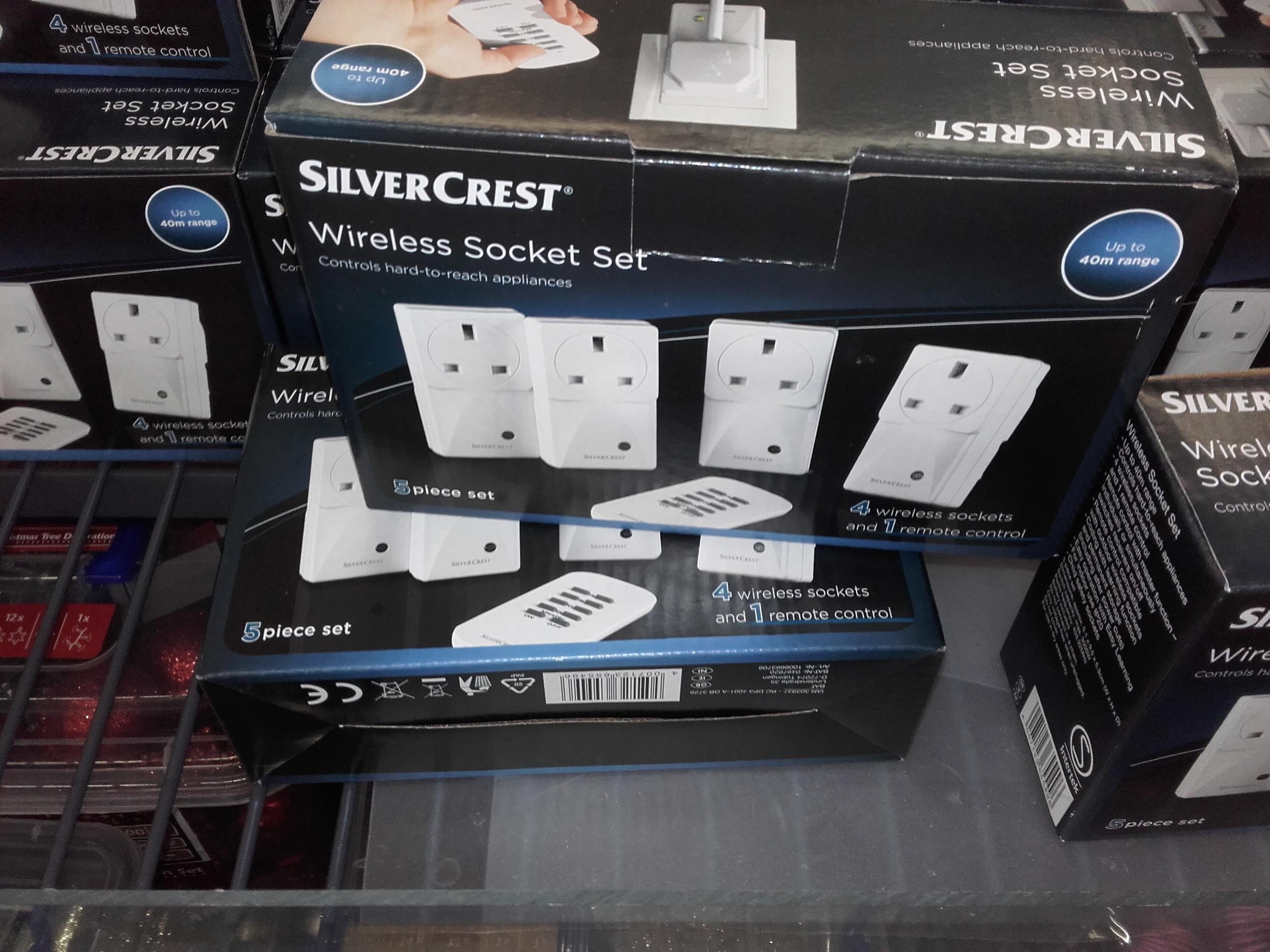

Onoff Posted November 30, 2018 Posted November 30, 2018 (edited) Saw these in Lidl today: £12.99 with 3 year guarantee. Edited November 30, 2018 by Onoff 1
Jeremy Harris Posted December 1, 2018 Author Posted December 1, 2018 Thanks, but the CPC one arrived yesterday and is about to have its guarantee voided by me hacking open the remote and turning it into a mains switched one. 1 1
