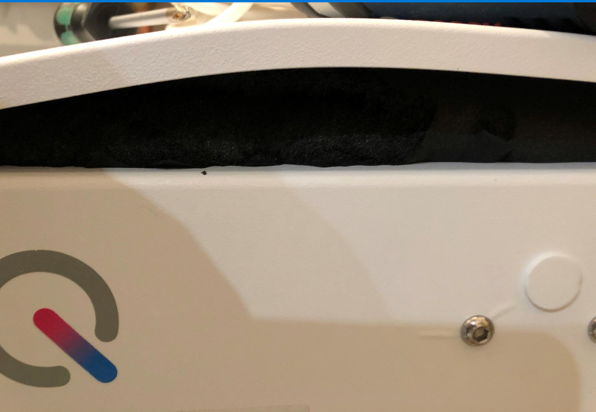

readiescards Posted November 17, 2018 Posted November 17, 2018 Difficult to photo but my PCM58 Sunamp container is bulging. The lid was also bulging and this has been replaced by Sunamp. Anyone else having their sunamps bulging? 1

Jeremy Harris Posted November 17, 2018 Posted November 17, 2018 Yes they do, it's normal. Not great, but I did look closely at the cause and called Sunamp about it, and it's not a problem. The cause is just a lack of rigidity in the large single PCM cell, and in the design of the case. They have redesigned the lid to try and overcome the distortion in that, but the flat sides of the case do still bow out a bit. Doesn't do any harm, AFAICS, but I'd like to see the case, or perhaps better, the cell casing, made a bit stiffer to prevent this. Personally I'm not losing any sleep over it. 1
Nickfromwales Posted November 17, 2018 Posted November 17, 2018 The feedback from SA was that the good folk in production were putting too much insulation in the upper section which was taking up the room for expansion. The units naturally distend a little, but not that it is problematic afaik, but taking away room for upward expansion meant the lids overly distended to a point that they were cream-krackered. They made these VERY tight, ( I imagine for space saving ), prob an inch too tight, but under normal conditions I’m told it’s ‘normal’. Agree with @JSHarris, where they could do with strapping a corset on it for the panickers. 1

Jeremy Harris Posted November 18, 2018 Posted November 18, 2018 The lid problem can be fixed by cutting the second layer of neoprene out so that it gives a bit of clearance around the pipes. This then allows it to compress more easily and allows the top layer to sit a bit better. Mine doesn't bulge like that at all now, having done this. Arguably the middle layer of neoprene should be supplied with cut outs a bit wider than the 4 pipes where they run out to the side, but I guess they don't do that because they don't know which side the customer will run the pipes. An instruction in the manual to make a series of generous slots in this section of the foam would be useful.

Barney12 Posted November 18, 2018 Posted November 18, 2018 5 hours ago, JSHarris said: The lid problem can be fixed by cutting the second layer of neoprene out so that it gives a bit of clearance around the pipes. This then allows it to compress more easily and allows the top layer to sit a bit better. Mine doesn't bulge like that at all now, having done this. Arguably the middle layer of neoprene should be supplied with cut outs a bit wider than the 4 pipes where they run out to the side, but I guess they don't do that because they don't know which side the customer will run the pipes. An instruction in the manual to make a series of generous slots in this section of the foam would be useful. Sorry to ruin the party.....but...... My insulation had wide channels cut in it to accommodate the 22mm pipework. I know that because I cut them After doing so my lids were a nice snug, but not tight fit. In my view the case design is flawed. They’ve just crammed everything in too tight. But, that is understandable as they are fairly sizeable beasts. Also interesting to note that you have re-designed lid. I’ve also received replacements but they appear identical to the originals. In what way are yours different?
Jeremy Harris Posted November 18, 2018 Posted November 18, 2018 The original lid that was supplied with mine (still have it in the garage) was a bit of powder coated heavy gauge alloy plate, with bends on the ends where the fixing screws are and no flanges at the front and rear. The replacement is a thinner gauge panel that's like a biscuit tin lid, and fits down over the top of the case. It's not as stiff as it could be, IMHO, but the flanges on the sides can't be any deeper because of the cut outs where the pipes come out. The gauge of metal used for the lid could be thicker. Making it the same gauge as the original lid (around 10g), but keeping the "biscuit tin lid" design would stiffen it up a fair bit. I had to bend my replacement lid back straight after I'd trimmed more insulation away to reduce the upward pressure, as it had a slight curve that had set in from when I first fitted it. It seems fine now, though. I did find that I had to cut the pipe slots out so they were maybe 15mm wider than the pipes, as when I was playing around trying to get it all to fit in neatly I noticed that as the top layer of insulation was compressed down the middle layer needed to be able to expand outwards in order to compress more easily. I agree it's all a bit too tightly packed. Another 10mm on the case height would probably completely eliminate the problem. Another thought I had was to remove the top and middle layers of neoprene and cut a bit of 50mm PIR to fit over the pipes, on top of the lower layer of neoprene. It'd be a much better insulator (around 2 1/2 times better than neoprene foam) and being rigid would keep the lid from bowing up. It would need a thin bit of neoprene around the edges, to get under the lip at the top of the case, but that should be easy to do.
