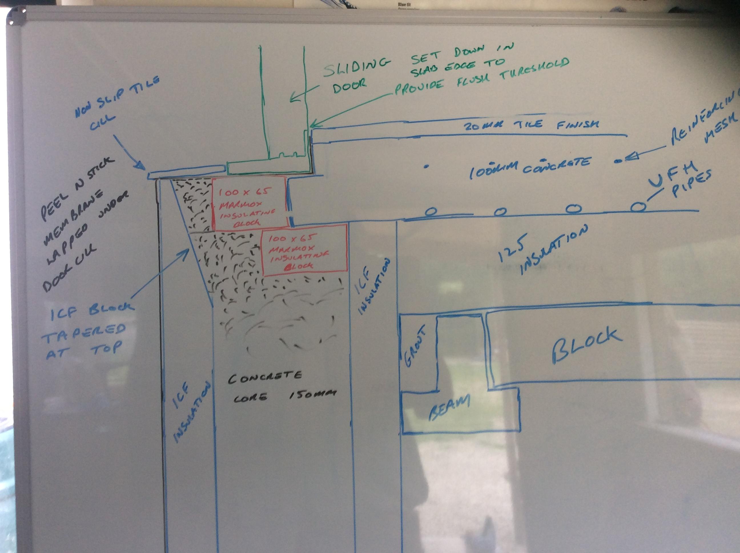

Ashdown Posted November 9, 2018 Posted November 9, 2018 We are using sliding doors (Reynaers CP130) fitted into traditional cavity walls - 100mm brick, 100mm full-fill PIR, 100mm blockwork. The challenge is to adequately support the track which will largely end up over the cavity. The aluminium track has a plastic thermal break meaning it has little lateral strength and cannot bridge the cavity and carry glass up to 200Kgs without a substantial substrate beneath. Ideas have included mass-filling the cavity with concrete and steel plates across the cavity. However these will both provide significant thermal bridging. A solution we are currently looking at will be to fill the cavity under the track with Leca Insufil and compact by light hand-ramming (it will compact by around 10%). Above this a layer of CF board (Purenit) 40mm or so. Hopefully this combination will provide a firm base which will have low thermal conductivity and minimal impact from moisture, but we are not familiar with these materials used in this type of application. Any thoughts please? Many thanks Peter

Ashdown Posted November 10, 2018 Author Posted November 10, 2018 Thank you for the useful data - the Leca insufil is a version of the lightweight expanded clay aggregate used under roads and bridges and has a compressive strength of 0.7MPa which we were considering using just in the cavity directly under the door track (PIR elsewhere). https://www.leca.co.uk/sites/default/files/DoP_DK_15210000xxx_EN 15732_UK.pdf The Purenit is a very dense PIR product which claims a compressive strength of over 5MPa and shear strength of 1 to 1.5MPa. http://www.cfsfixings.com/products/purenit This we are considering fitting across the cavity directly under the track - sketch attached. One concern is that if the Leca settles, then the Purenit will be asked to bridge the cavity, which is where there will be a combination of shear and compression on the edges. Not being a mechanical engineer I can't really tell what would happen but I expect we may need to try some and test it. It it works though it would be an easy solution for anyone to use. I will go and look up foamglass, fibreglass and marmox!
Russell griffiths Posted November 10, 2018 Posted November 10, 2018 Looking at you sketch, I think you need to include your finished floor, will your floor structure not continue into the door reveal area? As it looks are you not creating a straight joint in front of the door, depending on floor finish this could lead to cracking in the finished floor. I have spent a good good few hours thinking of this detail, mine is icf block and I’m going to install marmox blocks in the inner core and have the floor screed continue into the door reveal to prevent any straight joints.

mvincentd Posted November 19, 2018 Posted November 19, 2018 On 10/11/2018 at 11:31, Russell griffiths said: I’m going to install marmox blocks in the inner core Im sure in practice your marmox will work as shown but just to check you're aware you cant build in multiple courses with them.
Russell griffiths Posted November 19, 2018 Posted November 19, 2018 I sent my details to marmox and they we’re happy. I wouldn’t use ply under a slider for two reasons 1 it could get wet and rot 2 it will compress i think somebody on here already did this and found they have a dip in their bottom track
