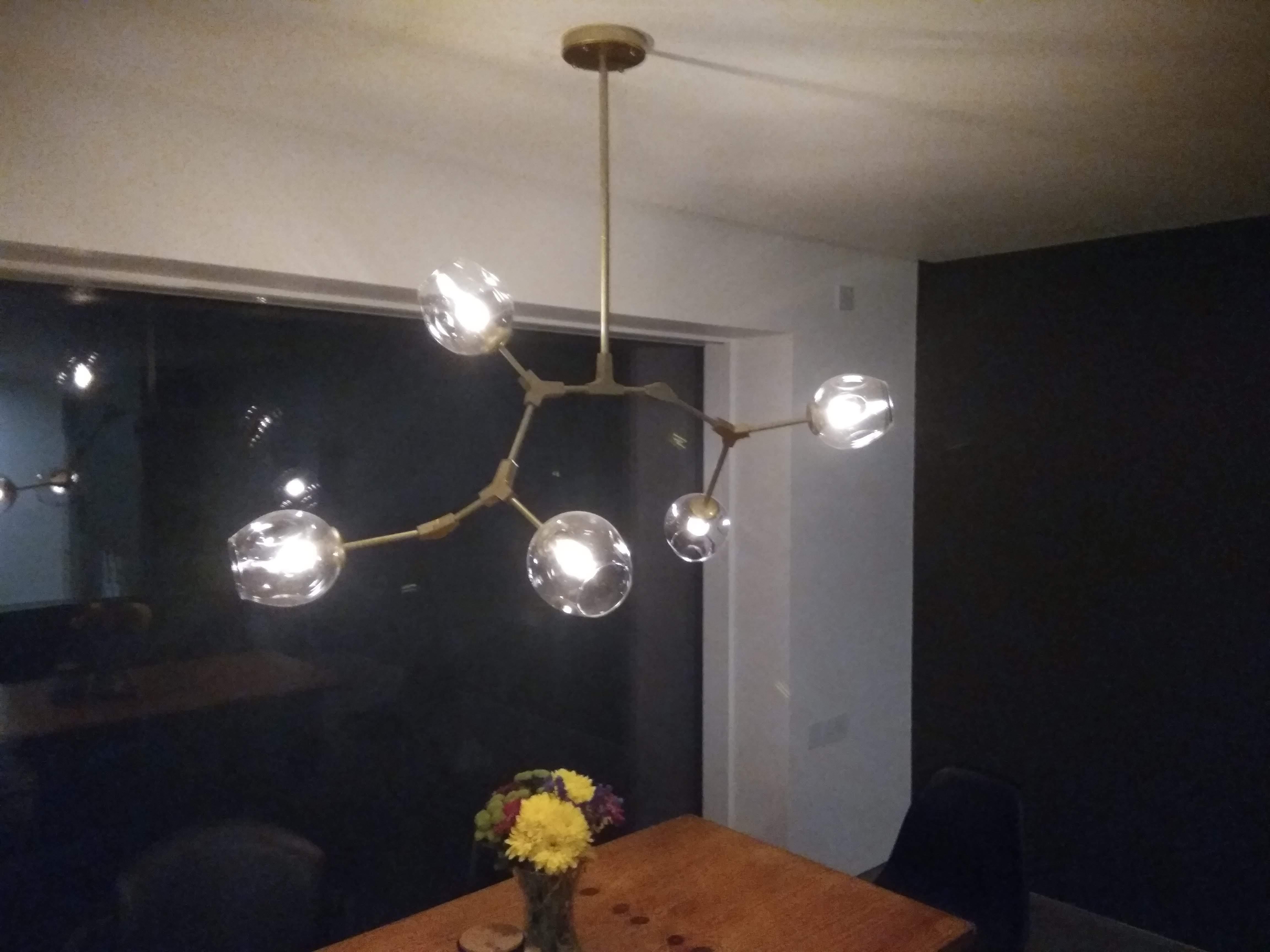

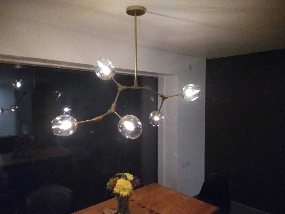

Dudda Posted November 9, 2018 Posted November 9, 2018 This light cost about £27,000.00 for the original http://www.lindseyadelman.com/bb0939#1 I purchased a reproduction for about $130.00 https://www.aliexpress.com/item/Designer-chandeliers-in-the-Nordic-idea-branches-pendent-lamp-glass-ball-lamp-droplight-of-post-modern/32692080299.html Sorry it's a poor quality photo attached but I really like the light and very happy with my aliexpress purchase. I'd have no problem recommending this website and you may find a reproduction of the light you're wife wants for a fraction of the cost. 1 1
nod Posted November 9, 2018 Author Posted November 9, 2018 16 minutes ago, Dudda said: This light cost about £27,000.00 for the original http://www.lindseyadelman.com/bb0939#1 I purchased a reproduction for about $130.00 https://www.aliexpress.com/item/Designer-chandeliers-in-the-Nordic-idea-branches-pendent-lamp-glass-ball-lamp-droplight-of-post-modern/32692080299.html Sorry it's a poor quality photo attached but I really like the light and very happy with my aliexpress purchase. I'd have no problem recommending this website and you may find a reproduction of the light you're wife wants for a fraction of the cost. Looks really good
Jeremy Harris Posted November 9, 2018 Posted November 9, 2018 The only word of caution I would add is that it's very well worth checking to make sure that the fittings are electrically safe before fitting them. If they are metal, then check that there is an adequate CPC connection (earth) and do an insulation test; it needs to be >1MΩ at a test voltage of 500 V to pass; ideally needs to be very much greater than this. >200MΩ would be fairly typical. Also check that any cables used are really copper wire with an adequate current rating. It isn't at all unusual to find that the cable used in some budget Chinese items is copper-coated steel and massively under-rated, often with poor internal insulation. Even if items need to be internally rewired to make them safe and reliable they are still very good value, as it's not much work to just add an earth connection or run in new flex. 1
