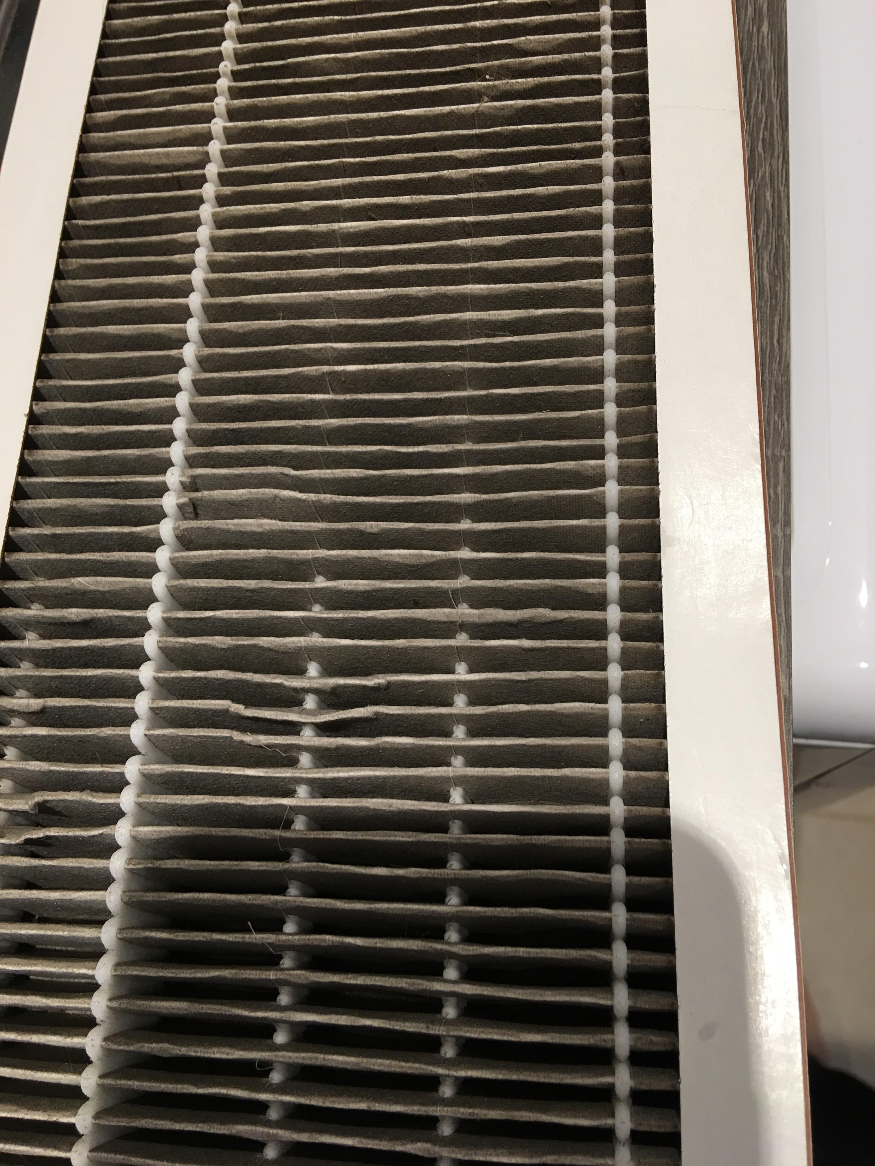

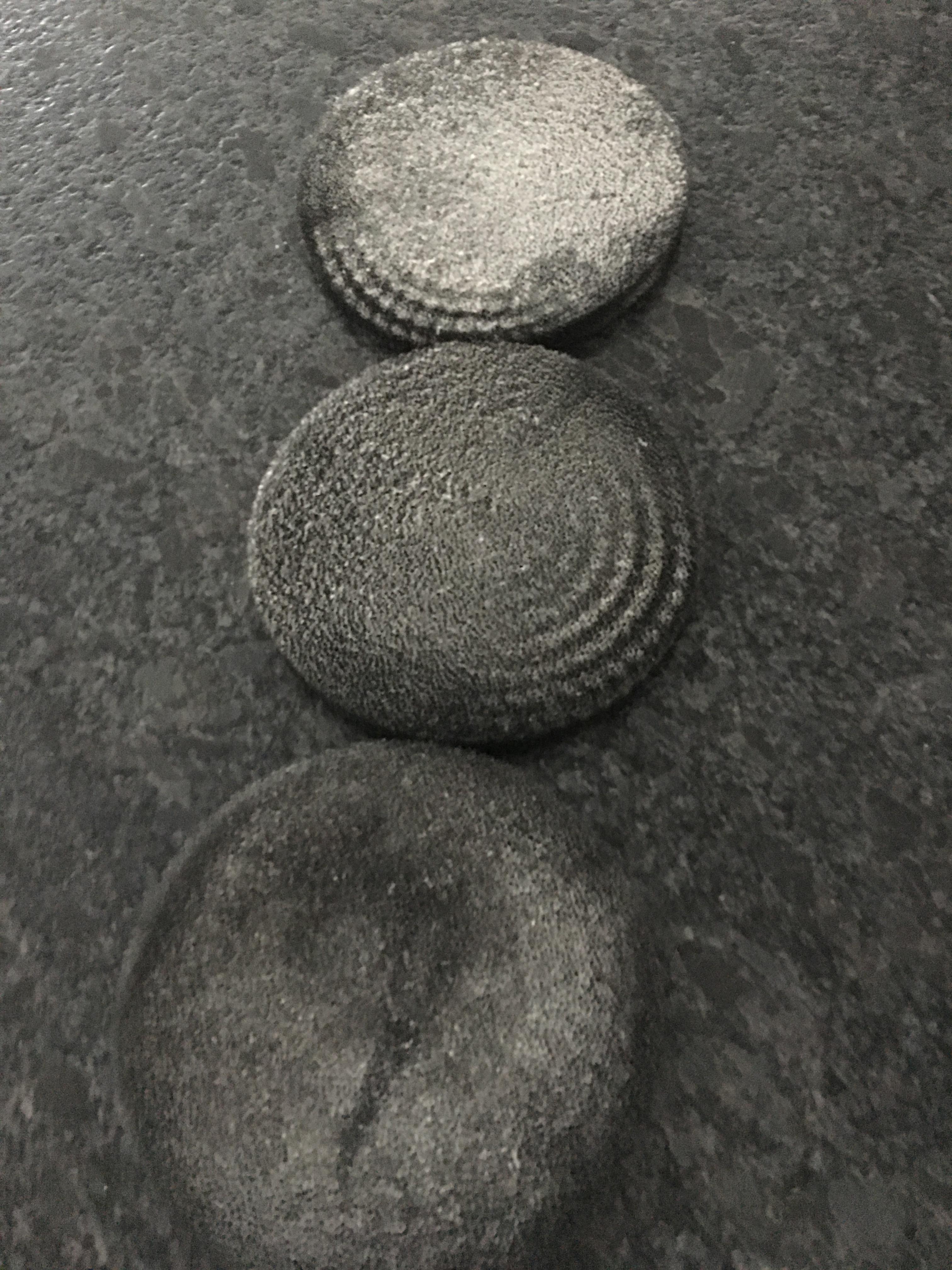

lizzie Posted October 27, 2018 Share Posted October 27, 2018 Bit of housekeeping today, changed filters on the unit. Been in since mid Aug and I have given them a periodic shake out during that time but they were ready for a change. In my ceiling extract point I have removable filters too. I have rinsed them a few times and resused but today I put new ones in as I think it was time. This pic is of the removed ones from bathrooms and dressing area....about 6 weeks since I last rinsed them out and they were filthy today. Wierdly the kitchen ones were quite clean (inc grease filters) so I didnt change those. Plant room , utility and w.c. were not bad but I changed them anyway. Given state of bathroom filters how often do you think I should be checking them? I need someone to be here with me to do it as I am not steady on the ladder LOL Link to comment Share on other sites More sharing options...
Mr Punter Posted October 27, 2018 Share Posted October 27, 2018 I have only done one MVHR and it did not have any filters in the room vents or extracts - just on the main unit. Have you been having barbecues in the bathroom? 1 Link to comment Share on other sites More sharing options...
newhome Posted October 27, 2018 Share Posted October 27, 2018 Affected by the fire you had? Still some gunk in the ducting causing that? 1 Link to comment Share on other sites More sharing options...
lizzie Posted October 27, 2018 Author Share Posted October 27, 2018 No done twice since fire........ Room filters are optional extra, hopefully keep pipes nice and clean. I didnt want anything lurking up there growing bugs I might breathe in, once had a flat with warm air heating never forget the filthy mess that built up in that. OH is a talc fiend so could understand his bathroom one being so bad but mine is almost as bad and I never use any dusty products and his bathroom is well away from mine. Seeing all that is a worry, god knows what is being breathed in. The unit incoming filter is grey and yukky as you would expect, the unit extract filter is pretty clean as most must be captured by the room vents. Link to comment Share on other sites More sharing options...
ProDave Posted October 27, 2018 Share Posted October 27, 2018 Interesting indeed. I did ours not long back. The only filters are either side of the heat exchanger core inside the mvhr. They are what I cal "cooker hood filter" material, just a woven sort of plastic mesh, though much much thicker than used in cooker hoods. When I checked ours, they were just a bit grey with what looked like ordinary fine, dry "house dust". I removed them, beat them outside, hoovered them clean, and put them back. I take it those filters did not start life black in colour? Link to comment Share on other sites More sharing options...
lizzie Posted October 27, 2018 Author Share Posted October 27, 2018 @ProDave yes they are black mesh. The grey is the dust and gunk. Link to comment Share on other sites More sharing options...

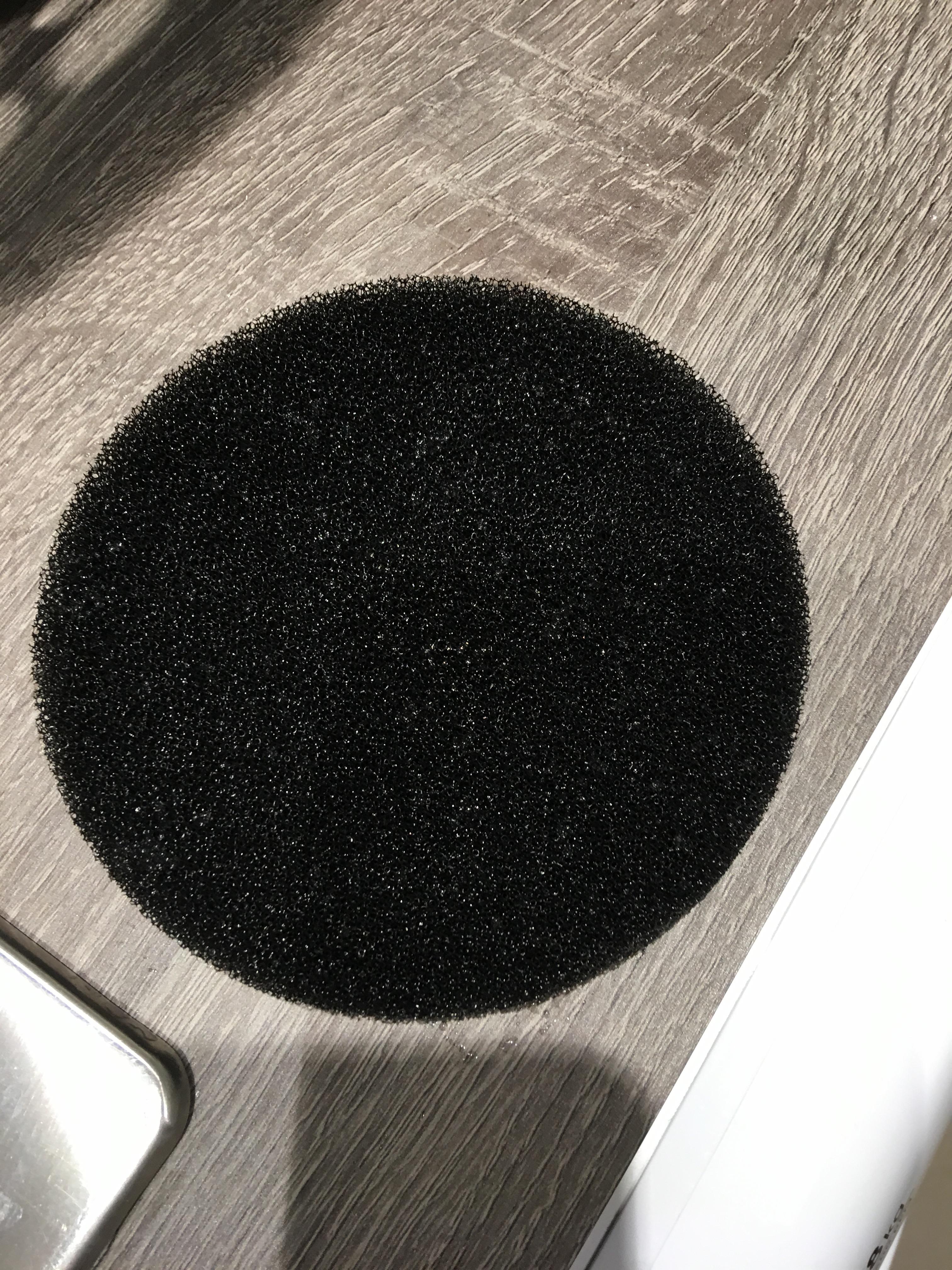

lizzie Posted October 27, 2018 Author Share Posted October 27, 2018 (edited) This is my dirty unit intake filter and this is a clean room extract vent filter Edited October 27, 2018 by lizzie Link to comment Share on other sites More sharing options...

MJNewton Posted November 1, 2019 Share Posted November 1, 2019 (edited) @woodman I think BPC just recommend stuffing a coarse filter inside your normal vent? Perhaps a 1m2 sheet of G3 filter media cut up and used in a similar way would suffice? Edited November 1, 2019 by MJNewton Link to comment Share on other sites More sharing options...
woodman Posted November 2, 2019 Share Posted November 2, 2019 Hi, thanks for this info. I'll be getting some of this- perhaps also good in the external intake to prevent flies etc also? I'm just a little concerned about the cost- 1m2 used in two all my intakes would last only approx 300 years!! ? Link to comment Share on other sites More sharing options...
JOE187 Posted November 3, 2019 Share Posted November 3, 2019 I use this one on external intakes and on kitchen extract https://uk.rs-online.com/web/p/filter-media/1221772/ this size will last along time and free delivery. 1 1 Link to comment Share on other sites More sharing options...
