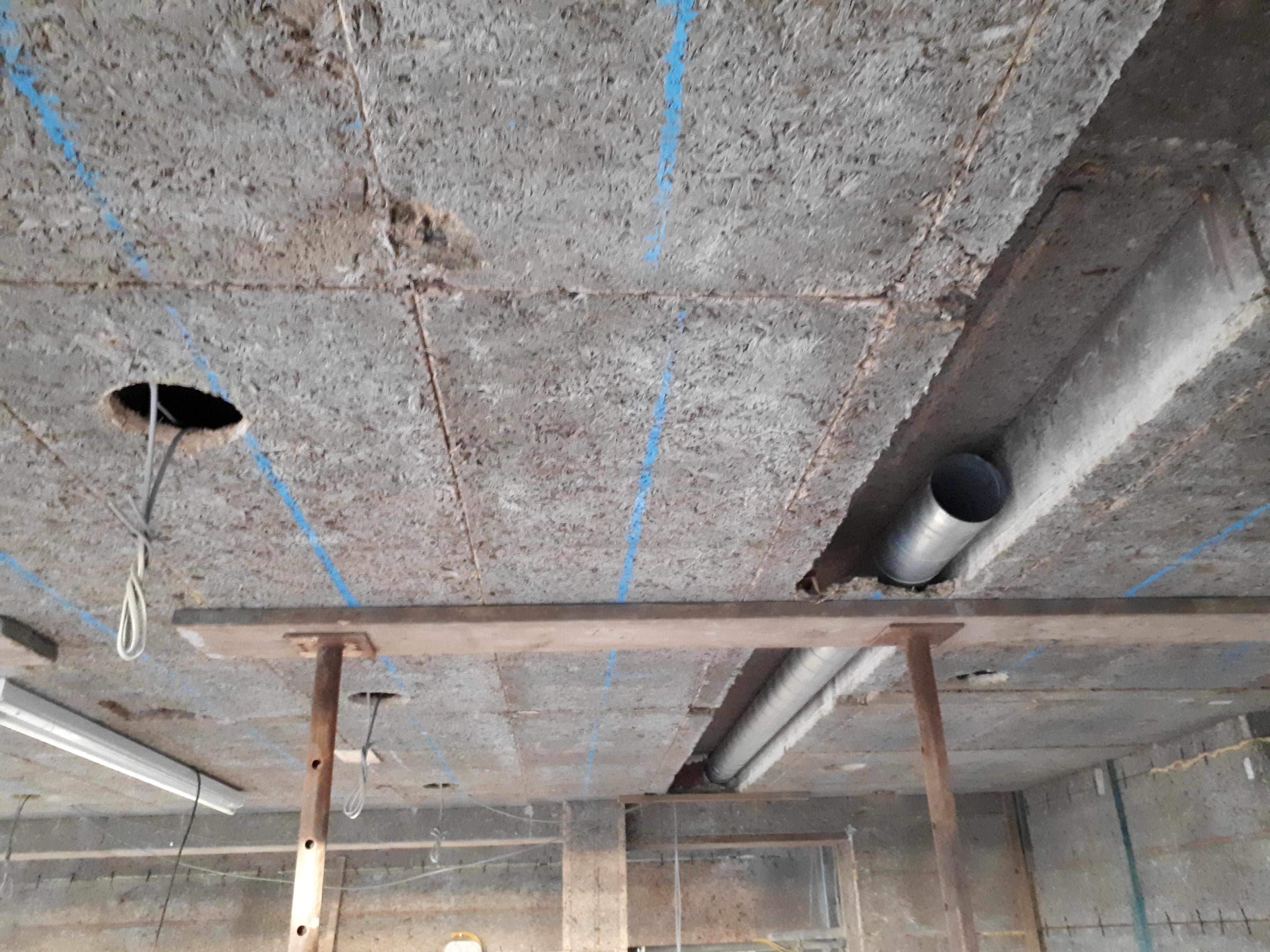

D Walter Posted January 17, 2019 Share Posted January 17, 2019 First fix underway with the voids in the Velox ceiling modules being utilised for MVHR ducting and cabling. 1 Link to comment Share on other sites More sharing options...
