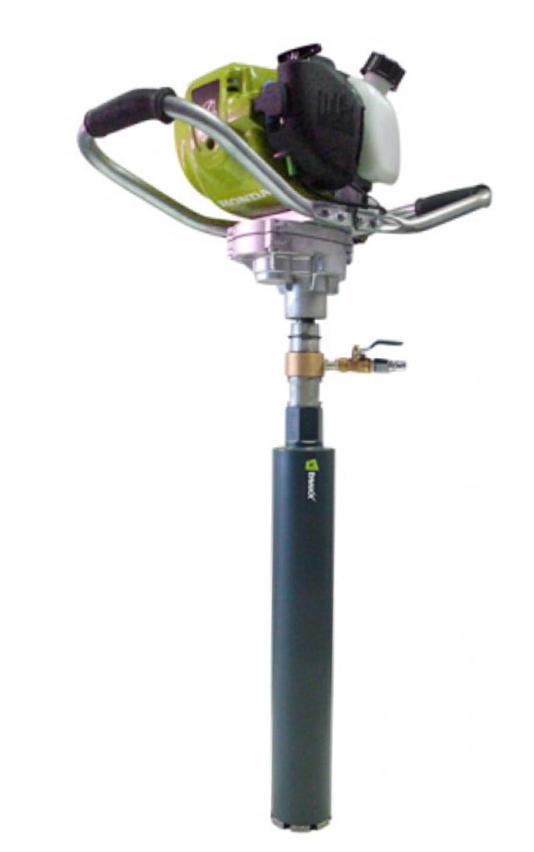

Cpd Posted October 15, 2018 Posted October 15, 2018 I used a petrol core drill for years, drilled uncountable 25mm and 60mm holes and hundreds of 110mm holes into bedrock it looked a bit like this but was red.... eventually it chewed up the main drive cog / Shaft and I am yet to find a replacement. It was brutal as it had no clutch, but you just hugged it a tight as fek and got on with it....... 1
Alexphd1 Posted October 15, 2018 Posted October 15, 2018 (edited) 24 minutes ago, Cpd said: I used a petrol core drill for years, drilled uncountable 25mm and 60mm holes and hundreds of 110mm holes into bedrock it looked a bit like this but was red.... eventually it chewed up the main drive cog / Shaft and I am yet to find a replacement. It was brutal as it had no clutch, but you just hugged it a tight as fek and got on with it....... I could just see the housewife/house husbands face when I start that bad boy up in the middle of their 50k kitchen to core out a small waste hole?? that is some piece of kit! Edited October 15, 2018 by Alexphd1 1
PeterW Posted October 15, 2018 Posted October 15, 2018 That looks like a post hole borer with a core drill welded to it ..!! I sooooo want one ...!!!!!
