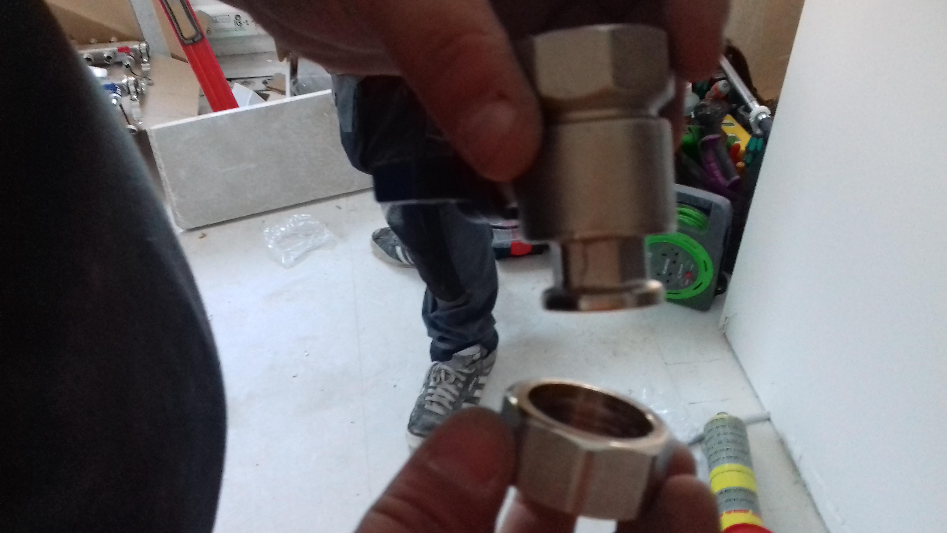

My plumbers are concerned about this fitting on my Wunda system.

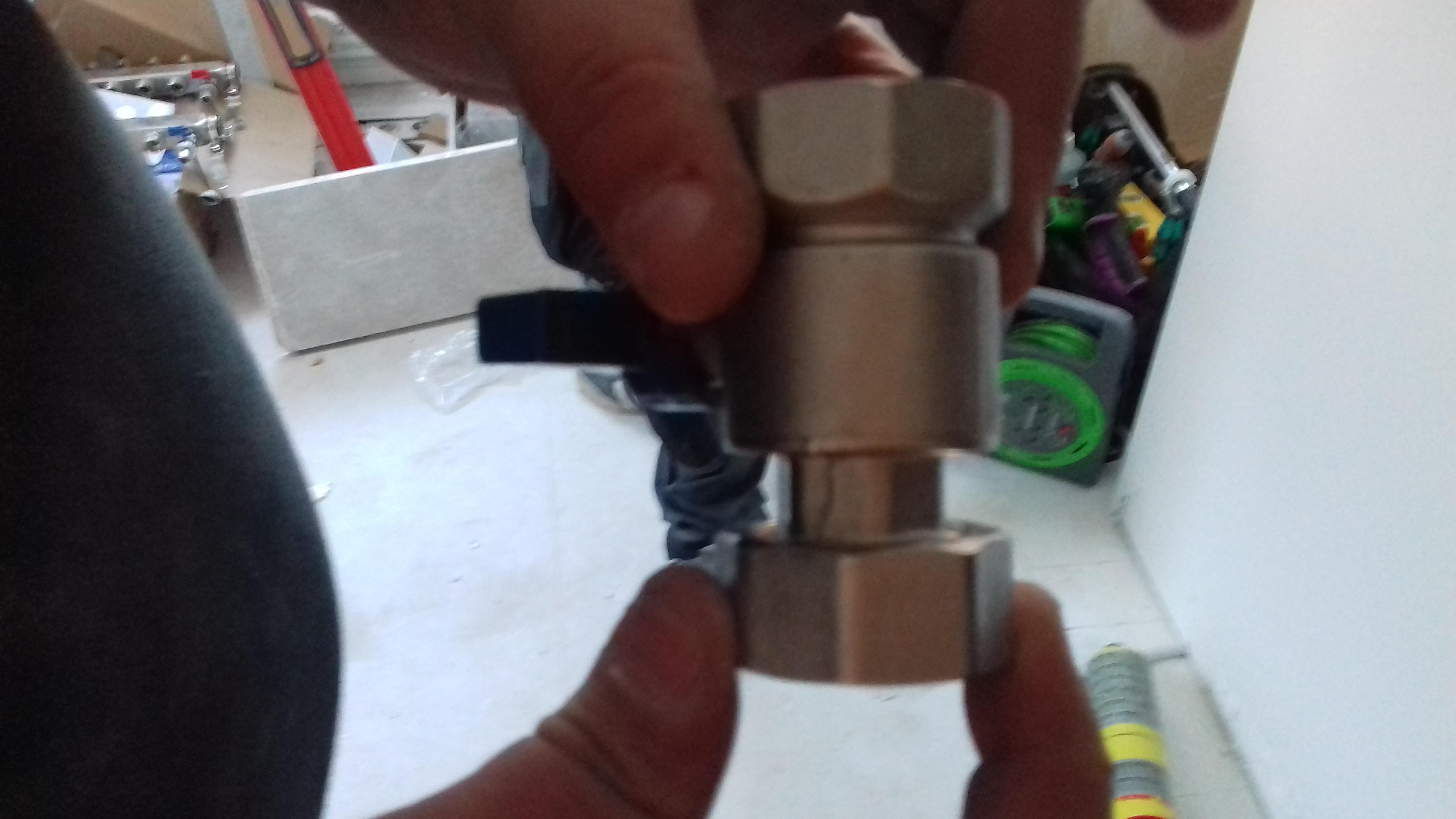

These two bits fit very loosely together. There is only a partial small lip that keeps them from coming apart. They haven't done ufh before and are willing to concede it may be as it should be but it doesn't seem right to them.
They are going to get it checked at their own heating place but they have already said that their place doesn't rate Wunda or Grundfos.
Has anyone any information or ideas please?

nope - that's just loose and fell apart as he held it.  I know nothing but must admit it doesn't look very safe
It should be loose before it's put together, but it shouldn't come apart like that. I'd call Wunda

That’s a standard loose nut - it has a groove in the flange so that the nut can be fitted to the casting as otherwise the valve would rotate when it was tightened both ways.
Stupid question but have they read the manifold instructions as it’s pretty clear how that lot goes together.

The two valves fit at the bottom as shown and then they need to fit a 1” to 22mm compression into the bottom of the valves as shown on the picture for supply and return.

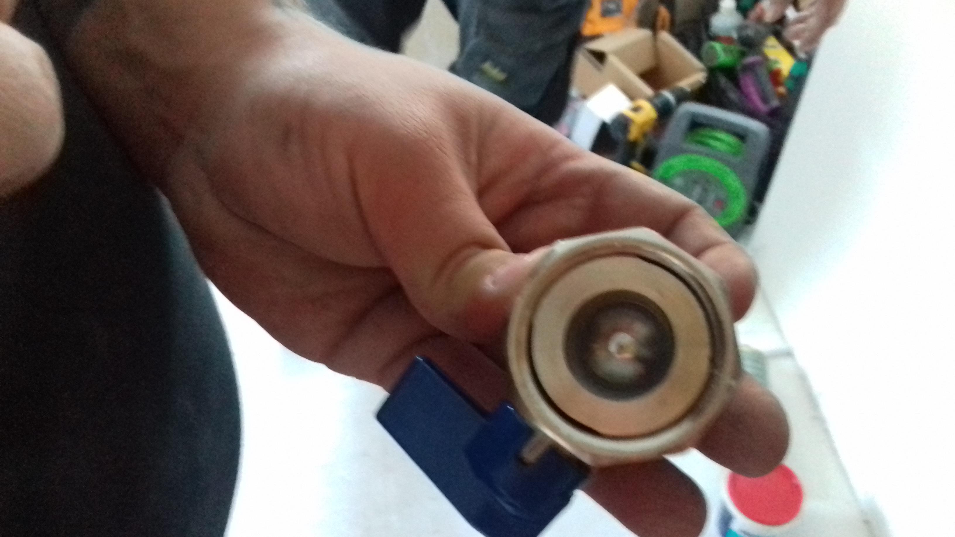

The flat face has the nylon washer against it and the nut tightens against the pump assembly Union. That cause the lot to tighten up. If the nut freely slips over the fitting it has parted company with then it may be damaged or slightly oversized, but the norm is a nut and flange which have flat spots to allow the nut to slip over and become captive, then the nut will rotate flat and tighten up without coming off.
Check with Wunda, as I really can't remember.

There doesn't appear to be a washer in this bit

There isn’t a washer from memory as it’s a pair of machined faces between the bottom of the mixer set and the isolators. If they are worried then a smear of JetBlue or other PTFE paste will suffice.
They must use a reamer to sort the top edges of the pipe as it will snag the O Rings and they will leak otherwise.

Can we have a pic of the end of the fitting ? It should show flat edges on the circumference.

Should there not a be a split collar to spring over the flange and retain the nut?

Nope there is just a gap about 15mm on opposite sides of the nut and a couple of flats on the body - same as a lot of pump isolators are designed.
