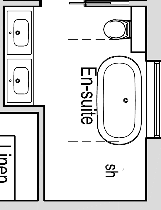

Images would be better I agree.  Here we go.
Shower 1: 1500 x 800 shower tray.  Does anyone think that 600mm is more appropriate than a 500mm gap?
(a skinny teenager will be using it primarily but I may want to welcome larger visitors......)
Shower 2: looks like a wetroom on the drawing but we are planning on a 1500 x 900 shower tray.  The length is just over 1900mm and there aren't any trays that fit that space perfectly.  Thought we'd go a bit shorter and maybe use the end space for something (if it isn't getting wet).

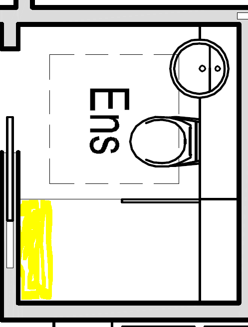

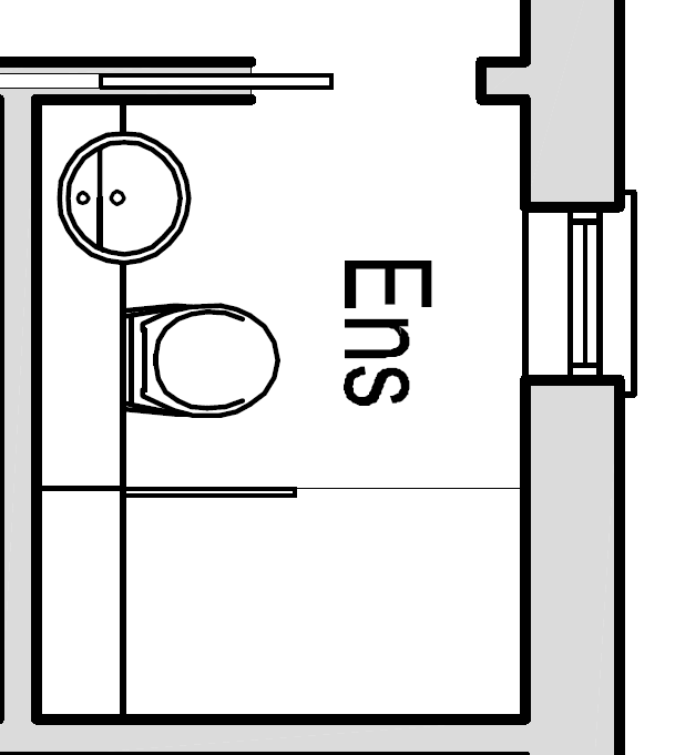

Shower 3: Have had to reduce shower tray to 1200 x 800 as the shower waste on every other size kept hitting the joists.
So now there is a gap of about 300mm (shaded in yellow).  Should we screen off that bit - will the water come out the back of the shower?

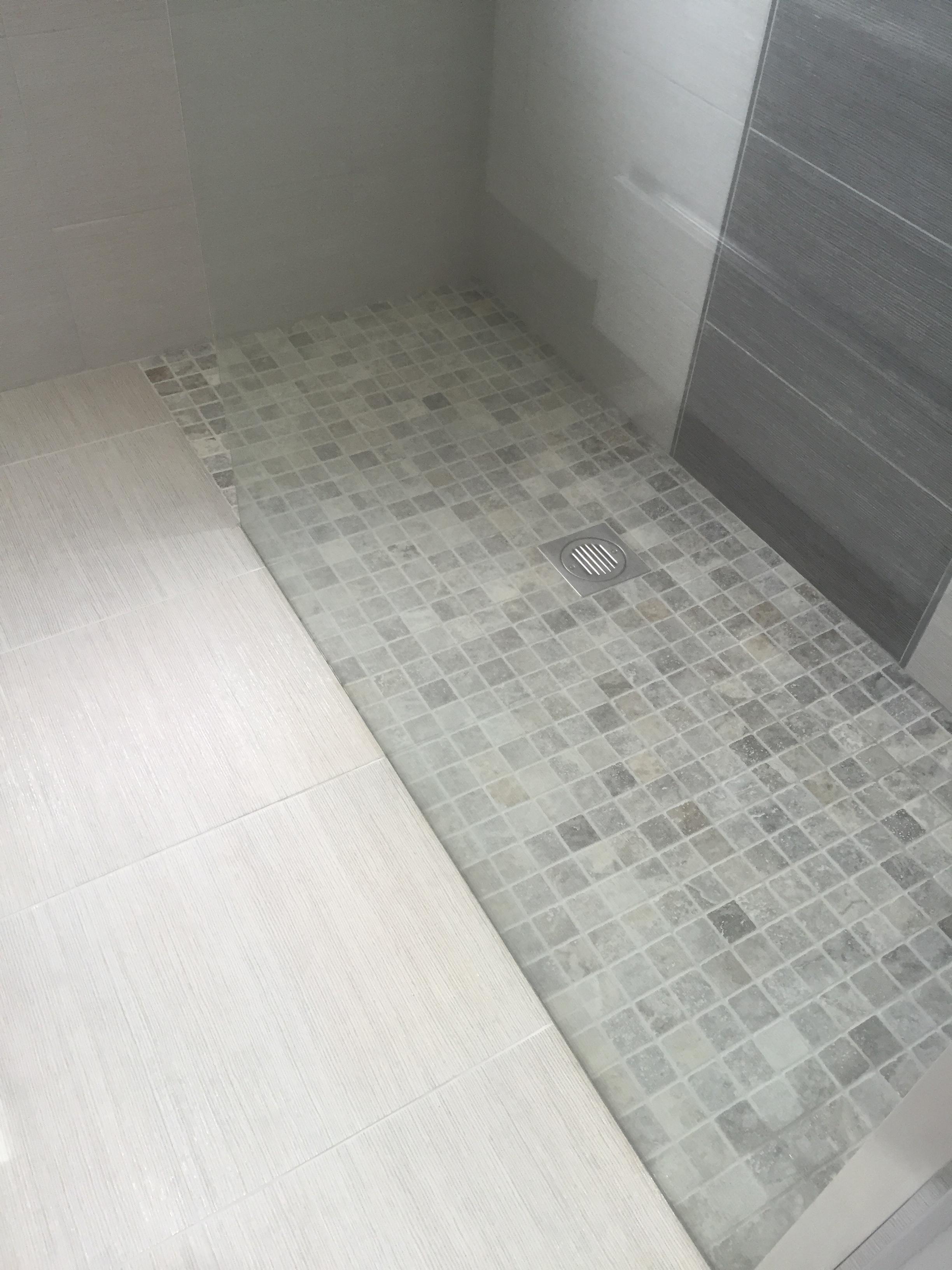

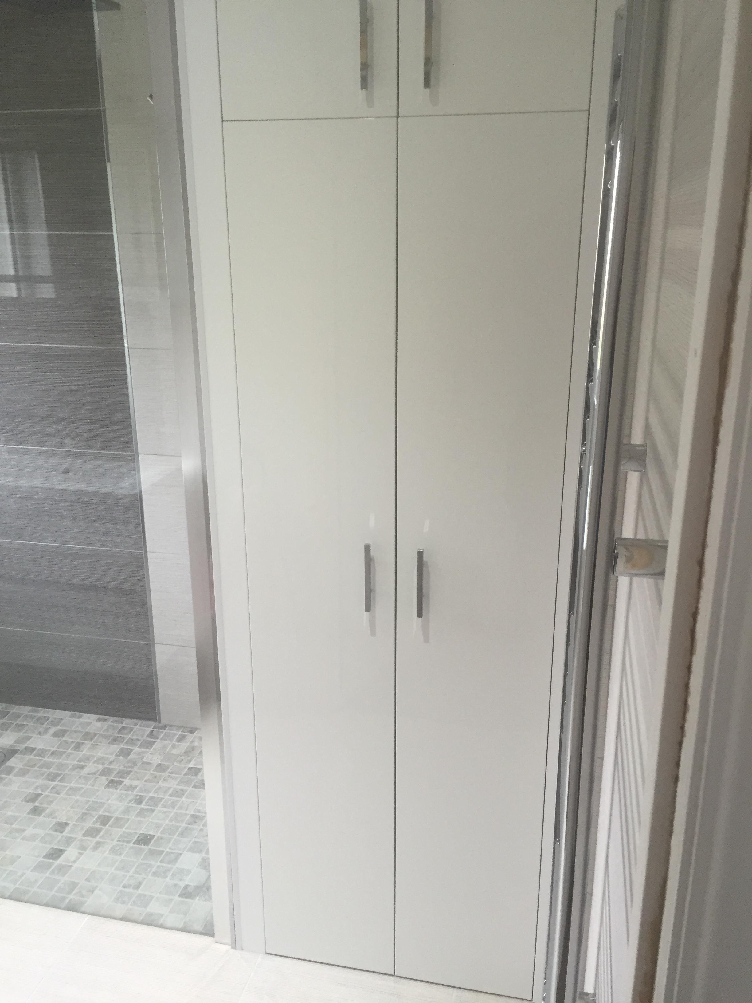

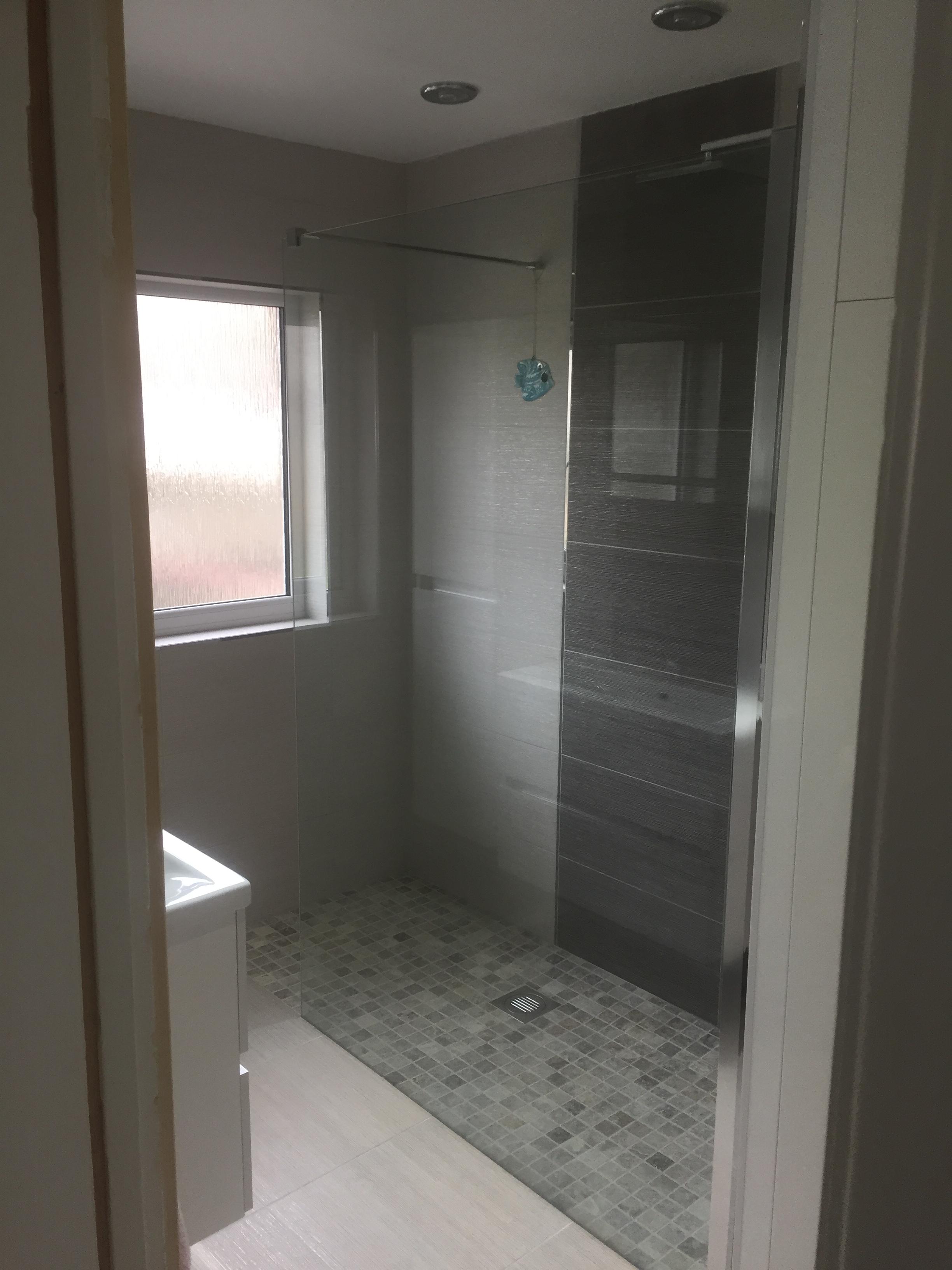

I have two en suites similar to the first picture, see below. I designed them with a 1000mm screen and 600mm gap but the bulkhead was built wider than it should have been so the gap ended up being around 500mm. I thought it looked narrow but it works fine. The bathroom people were adamant that the water would come around the end of a 900mm screen. I think in terms of hassle the narrower gap and not soaking the floor is better. Very little water comes around the end of a 1000mm screen, most of the water transfer comes from wet people getting out of the shower.
For the second room, I'd try to get a 1700x900 tray and build a bulkhead at the end to take a niche for shampoo and pipework. The bulkhead would match the one behind the WC at the other side and frame the bath. Especially for a longer shower like that I would want the controls on the side wall across from the entrance and the head at the end, do you have a cavity to run the pipes in and put the valve into? It looks like that is an outside wall on the side and end of the shower. If you cannot make room in the side wall for the valve it would go in a bulkhead. A 1000mm or 1100mm screen would be fine here.
In the third one I'd just tile the 300m of floor, not much water will get more than 1200mm back.The back wall doesn't really get wet on mine, but I think I'd want to tile it also. I'd be very surprised if you couldn't find a shower tray that works at 1500mm, it might just require getting onto Google for an hour.

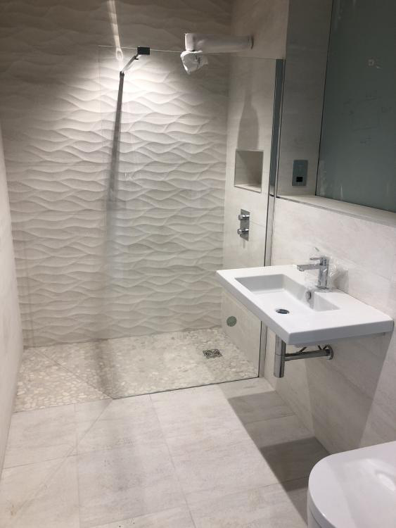

In all three I would try and put the controls opposite the entrance if possible and in the two with bulkheads I would have a niche in the bulkhead to store shampoo etc. I had a picture to hand of one of my ensuites, the shower controls are at the end as the wavy tiles aren't flat enough for them.

Thanks @AliG. Have gone for the 1000mm screen on the 1500 tray (shower 1). Have taken your advice and upsized to a 1700 shower tray for shower 2. Not done final decision on screen but will prob put in 1000 or 1100. And will tile the end wall. There is a cavity for the valve so that works well.

There does seem not seem to be any space around the double basin in shower 2.
Where will all the gubbins go?
I do not know what others think about the working area that is needed, but eg where will you stand things.
Hopefully the middle oval is the basin , so there is space around.

Will the water spill out the back of a 1200mm tray?
I wondered this with ours, 1200 x 800 tray with 1200 shower screen but we added a flipper panel at 300mm to stop water tracking along the screen and ending on the floor. In reality it works very well (originally I wanted a door) and am very pleased, glad we didn’t get a door in the end.

The space is about 1600mm but we have chosen a double basin unit that is only 1250mm so the towel rail etc can be on either side.  There is space in a behind the wall void for all the pipework /waste.  If gubbins means toiletries and the like, the basin is the inset bit so there is room round the outside for that.  We did look at a large 1500mm double unit with huge basins but lack of space for gubbins was the main concern.
@joe90  Wish we could fit 1200mm plus 300mm in but it won't give her any room to get into her shower.  Can get a 1000mm screen in but could def extend to the full 1200mm with a flipper panel (but def adds cost....)
