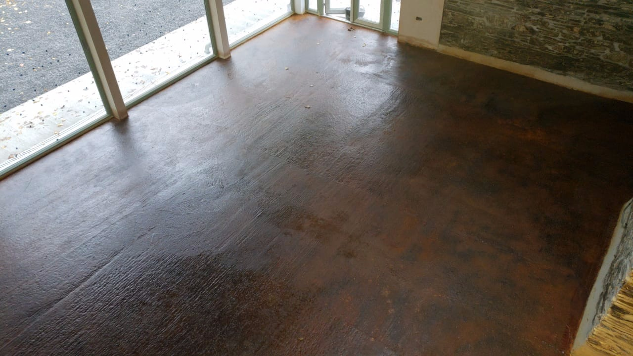

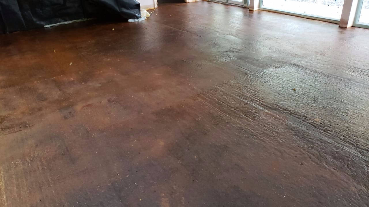

I'm pretty happy with the result. I'd recommend this technique to anyone that wants a cheapish way to get an interesting finish to a concrete floor.
It was fairly easy - the most time consuming part was getting the floor really clean to start with. A pressure washer with surface cleaning attachment and a wet vac was very useful for this.
- reddal
Nice colouring on that - very rusty looking.
6 hours ago, Nickfromwales said:
Yup. Looks like a giant block of mahogany to me.
End cost per m2?
About £4/m2 for the acid stain (you could probably find it cheaper), maybe £2/m2 for the concrete sealer, and then some labor. Probably under £10/m2 - less if you do all the work yourself.
If anyone wants to know more about the process, just let me know and I'll detail what was involved.
- reddal
