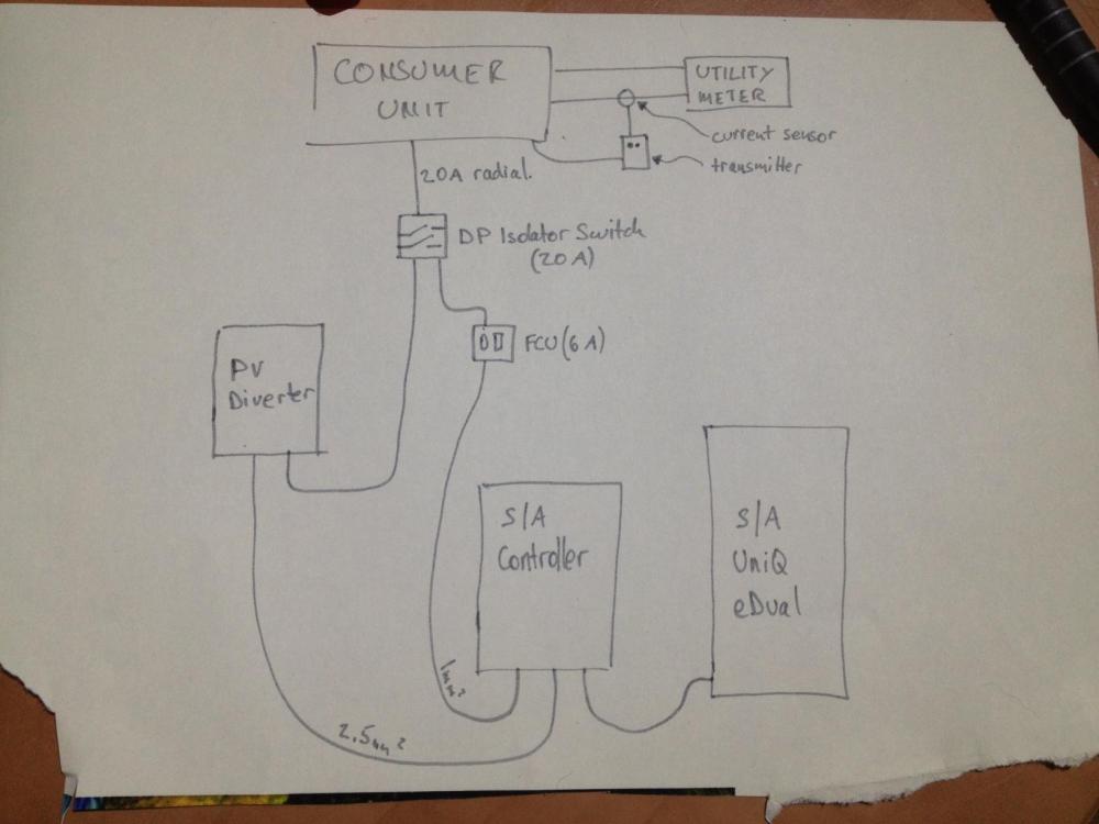

Nickfromwales Posted October 11, 2018 Posted October 11, 2018 The SA dPV is now live, and is aimed exclusively for direct DC injection. The ( early ) figures showed around 13% increase in efficiency due to no inverter. 38 minutes ago, A_L said: but it appears to be all the PV output is sent to the Sunamp. Which would be a waste in summer and not enough in winter. Yes, it’s a design which is best specified if going off grid for eg. I’ve yet to look closely at it and am apprehensive as to its appeal right now. When I now more I shall update with pros / cons. For now, I can’t recommend enough producing 240v AC and using it wherever it’s needed. However, if you fit a DC system and go for SA plus battery storage you may lift your efficiency overall by up to 30%. As I said, it’s a design consideration with serious number crunching needing doing way in advance.
stevethayne Posted October 12, 2018 Posted October 12, 2018 On 11/10/2018 at 07:40, Nickfromwales said: Hi Steve. The problem you will have is generating the high grade heat that you’ll need for space heating, unless you intend to / already have seriously upgraded the insulation and airtightness of the existing fabric of your home. DHW ( domestic hot water ) is a no brainer so I’d try to assess what you’re going to do for heating first and then compliment that with the DHW setup. If you can improve the house enough to lend itself to say oversized lower temp radiators then you definitely would be able to go for a heat-pump, but to go to a SA ( Sunamp ) unit(s) for space heating will have its problems. It’s do-able, but the issue is getting the kW input vs the kW required, especially when it’s the depths of winter. The SA units with an ‘e’ prefix have a 3kW immersion heater, and they don’t do a bigger one, so to get, for eg, 18kW of space heating via direct electric > SA you’d need 6 x ( albeit the smallest in the range will suffice ) SA units to get the conversion capacity. An option for you may be an electric boiler, fortified with the PV + battery storage system, but that would be a hell of a load to try to offset. If you’re happy to munch through electricity then without improvements I’d say electric boiler + SA for DHW. Really useful, thanks Nick. I definitely intend to do work on the insulation of the house. It is double glazed but they need work to repair. Has good insulation in the loft. But aim for it to be as well insulated as possible. So if I am understanding right, to get enough rate of flow to provide heating from Sunamp units alone via the radiators would require multiple units? It is not just about the storage capacity i.e. how long the units can provide energy for before they run out and need to be recharged? I understand as well that the temp of the water coming out of the SA units is much cooler than from the gas boiler, is that what you mean by "high grade heat"?
stevethayne Posted October 12, 2018 Posted October 12, 2018 On 11/10/2018 at 08:33, ProDave said: @stevethayne It sounds like your house was originally heated with an Electricaire unit, which is a big central storage heater with a fan to blow warm air to all the rooms. They are still made, though now targeted at commercial use https://www.dimplex.co.uk/product/electricaire-r1073 The smallest one has a heat storage capacity of 73KWh and typically will run a 10KW heating element for the 7 hour off peak period to achieve that. This will give you some idea of how much heating you will need for your house in order to size the system, so you will need typically three 3KW heaters just to store enough for space heating requirements I would seriously consider changing to economy 10 which gives you 10 hours of cheap rate but delivered I believe in 3 off peak periods, so it is never so long until the next top up. Thanks ProDave. Really interesting. Will look into Electricaire. Wonder why people stopped using them, was it just that North Sea Gas came along and was cheaper? Will consider Economy 10. My electric car takes 4 hours to charge at 6.6 kwh though so will need to weigh that in.
ProDave Posted October 12, 2018 Posted October 12, 2018 I wasn't suggesting you put an Electricair back in again, merely saying that might give you an idea of the heating requirements of the property (assuming the Electricair had proved adequate) I know they were not popular around here. But then storage heaters in general are not popular, people prefer gas or even oil rather than electric storage heating. And it's also possible it proved inadequate in cold weather.
