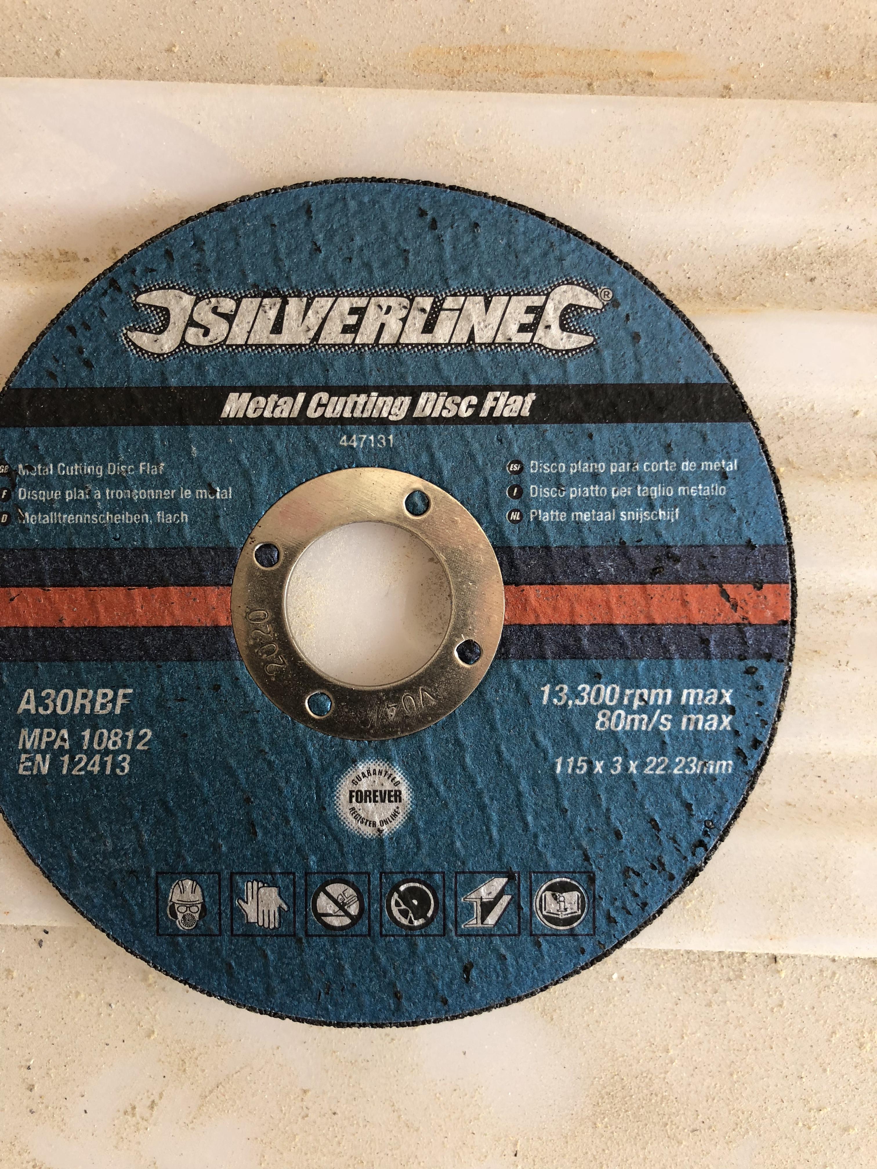

Pocster Posted October 1, 2018 Posted October 1, 2018 Hey Bought some of these off eBay ( probably my first mistake ) . Get a nice fireworks display but very little cutting ! Someone kindly direct me to some 115mm discs that will glide through 3mm galvanised..... cheers in advance
wozza Posted October 1, 2018 Posted October 1, 2018 Those discs that PeterW has suggested will cut much better as they are much thinner - be careful when cutting anything galvanised, it is toxic. 1
Pocster Posted October 1, 2018 Author Posted October 1, 2018 7 minutes ago, PeterW said: These Thanks ! Not sure why my eBay “metal cutting” discs did very little ?
Declan52 Posted October 1, 2018 Posted October 1, 2018 17 minutes ago, pocster said: Thanks ! Not sure why my eBay “metal cutting” discs did very little ? That big long name with the spanner sticking out each side would be a clue.
Pocster Posted October 1, 2018 Author Posted October 1, 2018 1 hour ago, Declan52 said: That big long name with the spanner sticking out each side would be a clue. Quality brand then ?

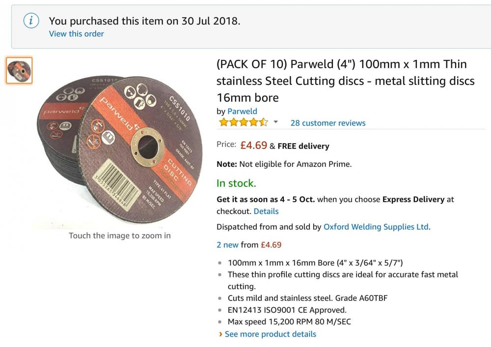

Cpd Posted October 1, 2018 Posted October 1, 2018 Been using something similar but even thinner..... It’s just like a hack saw cut. Great find. The ones Peter recommends look even better, will order some when I run out. 1
Onoff Posted October 2, 2018 Posted October 2, 2018 The Rhodius 1mm ones from Toolstation are good. Even better Abracs Proflex. You won't go back. I've been chopping up steel for 35 years.

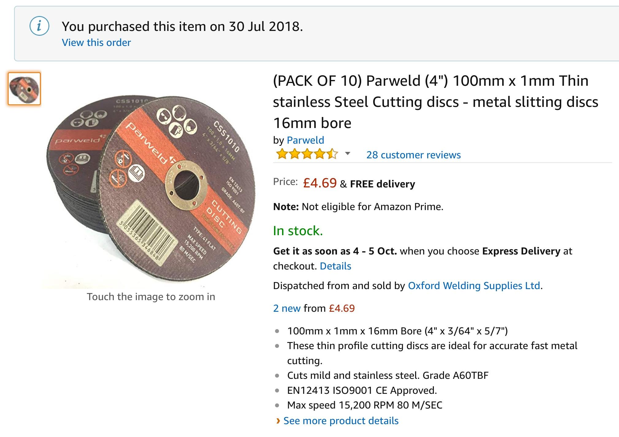

Cpd Posted October 2, 2018 Posted October 2, 2018 These are the ones I am using, seem very good and not had one shatter yet.
