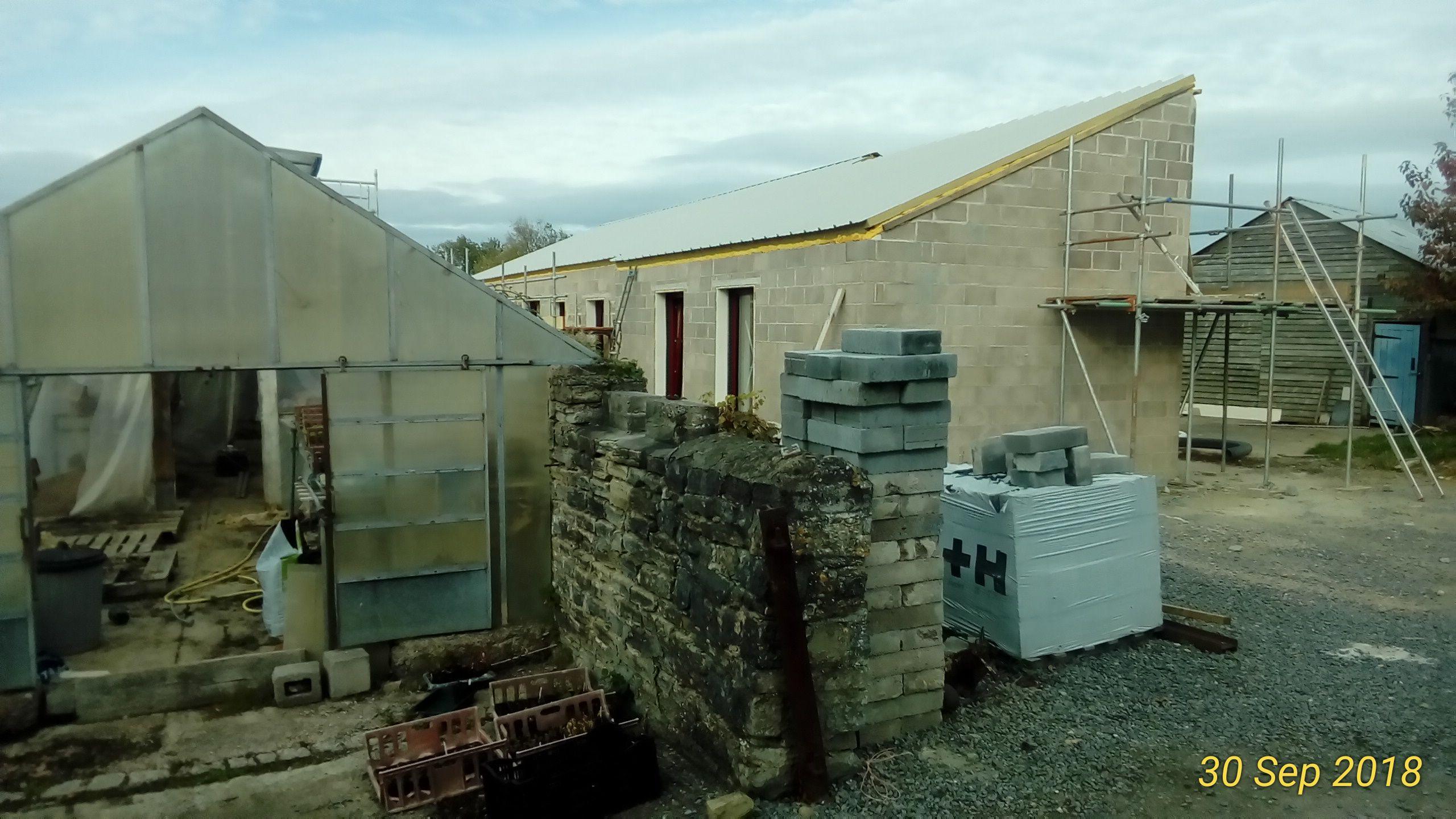

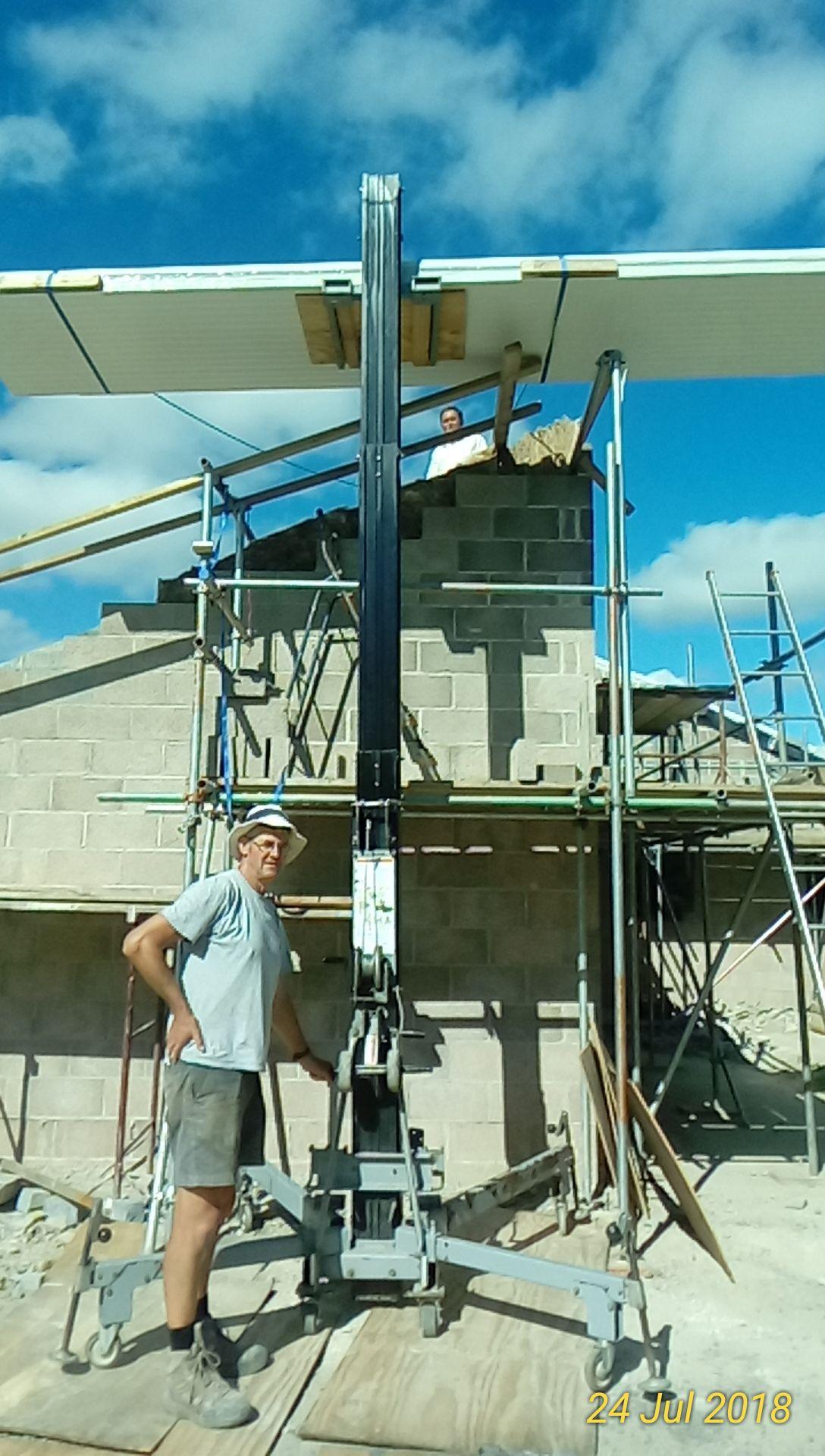

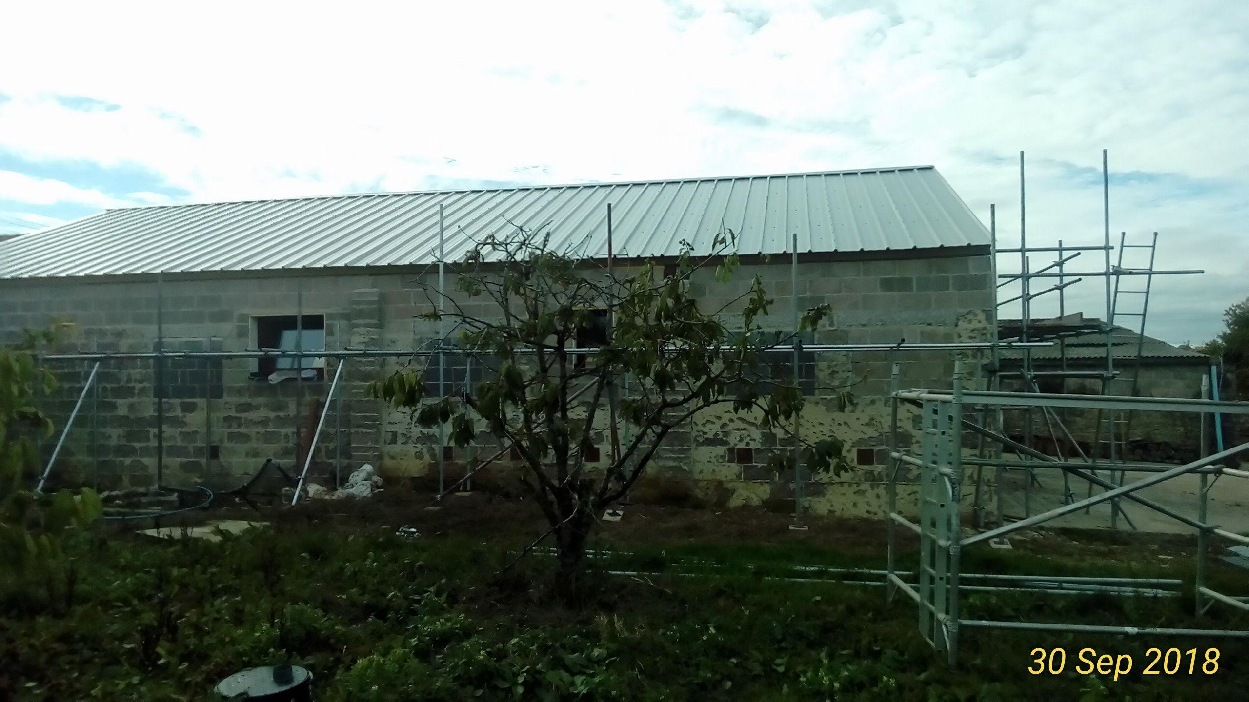

Simon Brooke Posted September 29, 2018 Posted September 29, 2018 We have just finished the roof on a 1950's barn conversion using Kingspan ks1000 sheeting with 150mm quad-core insulation. This has given a u value of 0.12 which we needed for our passive house. Our sheets were 5.5m long and weighed about 90kg each so were awkward to lift. We have fixed directly onto either metal z purlins or timber and both were ok to do. Generally we are very pleased and would recommend but we wanted an 'industrial' finish.

Simon Brooke Posted September 30, 2018 Posted September 30, 2018 Couple of pictures attached. Rendering should take place over the next few weeks if we can decide on which through colour render to use! Recommendations welcomed. Kingspan rate their roof at 3 air changes so not good enough for us. To beef it up we have used pro clima at all junctions including the ridge. Time will tell if this will be enough but it was quite easy to put on. At the moment we can hear the rain but are quite happy with this as we had a tin roof when we lived in Australia. It is not too noticeable and we haven't got ceiling up yet. U value was the driver as the barn shape is not ideal for a passive house. We are based in Somerset and would be very happy to receive a visit to view in the flesh. 1
kxi Posted September 30, 2018 Posted September 30, 2018 @Simon Brooke Thanks very much. Looks fantastic. To clarify - you just taped the joins? (I.e. pro clima tape, not the additional membrane). Isocab have similar quadcore panels (they are part of kingspan I think) and say that when joints are ‘finished’ they give <0.04 m3/hm2 at 50pa http://www.ecohomepanel.com/brochure_en/18/ which suggests it's doable. If you are putting a ceiling up under them, I suppose you could add some mineral wool in between the rafters/purlins if the noise was bothersome. What have you done/plan to do for the wall build-up, as I assume insulation will be internal? I couldn't see any quad core sheets available. They do do the karrier wall panels, but that seems an expensive approach inside a wall.
Simon Brooke Posted October 3, 2018 Posted October 3, 2018 Yes we have just used tape and no membrane. Not really what the architect advised but her solution was overkill. We could put some more insulation between the ceiling and the roof panels but we are quite relaxed about listening to the rain. Our walls are unusual in that we had a largely existing rendered block wall which we were not allowed to extend beyond so we built a second inner skin of insulated blocks and did a full fill of knauf earthwool to provide the necessary u value. The earthwool was very nice to use and much better than the old style spun glass. 1

Simon Brooke Posted January 13, 2019 Posted January 13, 2019 Yes it was done last week. The figure of 1.48 was a bit disappointing but we had been forewarned by the assessor that the shape and retrofit nature of the build would make it impossible to achieve our .6 target so i was quite relaxed. We still have ceilings and walls to line wth plasterboard so we may yet get it a bit lower. The assessor was excellent and spent a fair bit of time identifying air leaks in the fabric which should also help us improve the result. Interestingly, whilst there may be small air leakage through the roof this is not where we have to concentrate our efforts.
