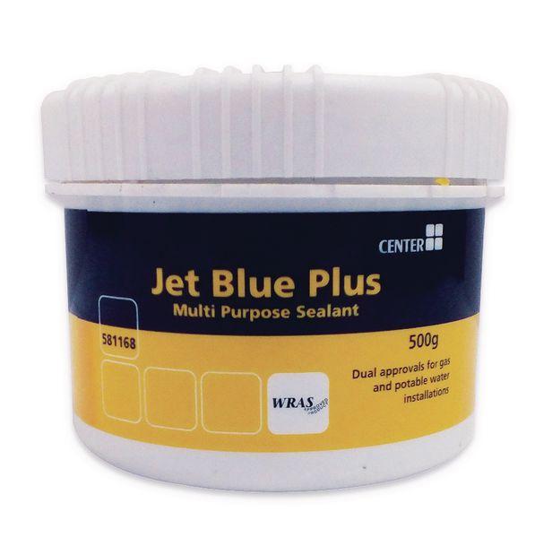

Onoff Posted December 12, 2018 Author Share Posted December 12, 2018 PTFE tape wrap before or after the compound? Link to comment Share on other sites More sharing options...
PeterW Posted December 12, 2018 Share Posted December 12, 2018 Before - two or three wraps on the olive. Looking at that sludge I would also plan to put a mag filter in the circuit somewhere and whack inhibitor in after running some system cleaner through it for a few weeks. Look on BES, they have a Cura branded one that is really tidy and cheap - their inhibitor and desludge is good too at about £3 a bottle. 1 Link to comment Share on other sites More sharing options...
Onoff Posted December 12, 2018 Author Share Posted December 12, 2018 Can get to the olives on these two ends: But not this as there's a straight coupler stopping the but going back: Link to comment Share on other sites More sharing options...
PeterW Posted December 12, 2018 Share Posted December 12, 2018 Put the valve in, wrap PTFE across the join between the olive and the brass body and then do it up with some of your favourite goo on it ... Link to comment Share on other sites More sharing options...
