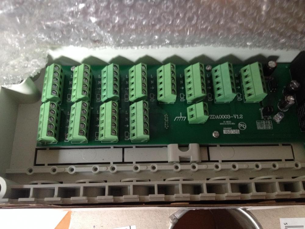

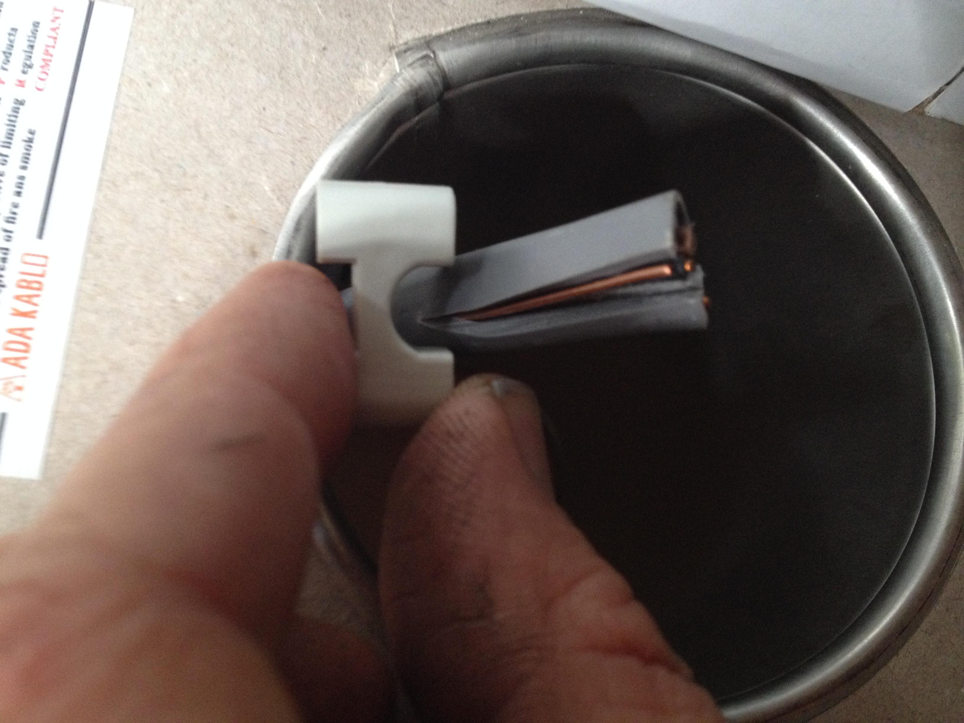

oranjeboom Posted October 2, 2018 Author Posted October 2, 2018 On 16/09/2018 at 19:00, ProDave said: 1mm is better. There is not much room in those wiring centres to get all the cables in, so the smaller the better. Can someone tell me if I've ended up getting the wrong cable? I went and bought 6243Y 3X1+1 1mm from TLC: https://www.tlc-direct.co.uk/Products/CA1slash3G.html But it seems overkill to me (bearing I am no electrician) for what is only linking the thermostats to the ufh control board. Even the cable clamps in the wiring centre won't be able to clamp that cable down: Did I get the wrong stuff? Surely this would suffice? https://www.tlc-direct.co.uk/Products/CA0dot75HR4.html If not, it'll be a bugger to get the wiring centre all connected (leaving that for electrician):

Nickfromwales Posted October 2, 2018 Posted October 2, 2018 2 hours ago, oranjeboom said: Can someone tell me if I've ended up getting the wrong cable? I went and bought 6243Y 3X1+1 1mm from TLC: https://www.tlc-direct.co.uk/Products/CA1slash3G.html But it seems overkill to me (bearing I am no electrician) for what is only linking the thermostats to the ufh control board. Even the cable clamps in the wiring centre won't be able to clamp that cable down: Did I get the wrong stuff? Surely this would suffice? https://www.tlc-direct.co.uk/Products/CA0dot75HR4.html If not, it'll be a bugger to get the wiring centre all connected (leaving that for electrician): You should have got flexible cable, number of cores to suit, as the solid core stuff is for fixed wiring only. The Basic stuff is for wiring between the CU and the fused disconnection unit, and then you can use flexible cable, suitably protected in a trunking where practicable, which would be far easier. Also no need to earth sleeve anything as the earth will already be a PVC coated core.
oranjeboom Posted October 3, 2018 Author Posted October 3, 2018 Thanks @Triassic and @Nickfromwales. I thought I'd gone wrong. I'll get some 0.75mm2 flex. On offer from SF at the mo at only £18 not including my 10% off! https://www.screwfix.com/p/nexans-heat-resistant-flex-3094y-4-core-0-75mm-50m-white/6848t#product_additional_details_container
