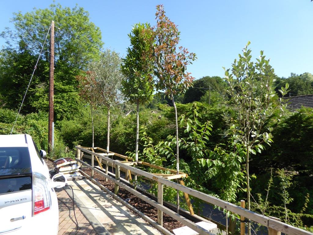

Jeremy Harris Posted August 31, 2018 Share Posted August 31, 2018 Glare was a minor planning issue for us, as we have 25 solar panels on the South elevation, but the planner was happy because they were screened from the neighbour over the road to the South by a tall Leylandii hedge along his boundary with the lane. The neighbour has since cut the hedge down, creating a privacy problem for me (which I've fixed by planting some fairly tall trees) but I've heard mutterings that the glare into his daughters bedroom window is very harsh. He's not said anything directly to me, but I don't think he can do anything about it anyway, realistically. In your case I'd ignore the neighbour and do as suggested above, apply for a retrospective change of materials. I did this twice when things changed after we'd got PP, including changing the roofing material from Tata Urban steel sheet roofing to IkoSlates, and the planning officer treated it as a minor amendment both times Link to comment Share on other sites More sharing options...

Jeremy Harris Posted August 31, 2018 Share Posted August 31, 2018 1 hour ago, dnoble said: Hello Jeremy. That's interesting as one option I was considering was to cover this roof in solar panels(though it's NW facing) on the assumption they absorb most of the light rather than refect it! What trees did you plant out of interest? In terms of applying for retrospective change aren't I on a bit of a sticky wicket if there's already a complaint in and I didn't follow procedure correctly? The solar panels have an anti-glare glass, but they still cause a fair bit of glare at times, not that you can see it from ground level. The screening trees we planted were a couple of cherry trees, a couple of red flowering hawthorns, a couple of photinias, a whitebeam, a flowering crab apple, a bay tree and a fairly large olive tree. This is what they looked like in March: And this was taken in July (we've since added a close board fence along the top of the retaining wall at the back and around the garden, on top of the dwarf stone wall): Link to comment Share on other sites More sharing options...
