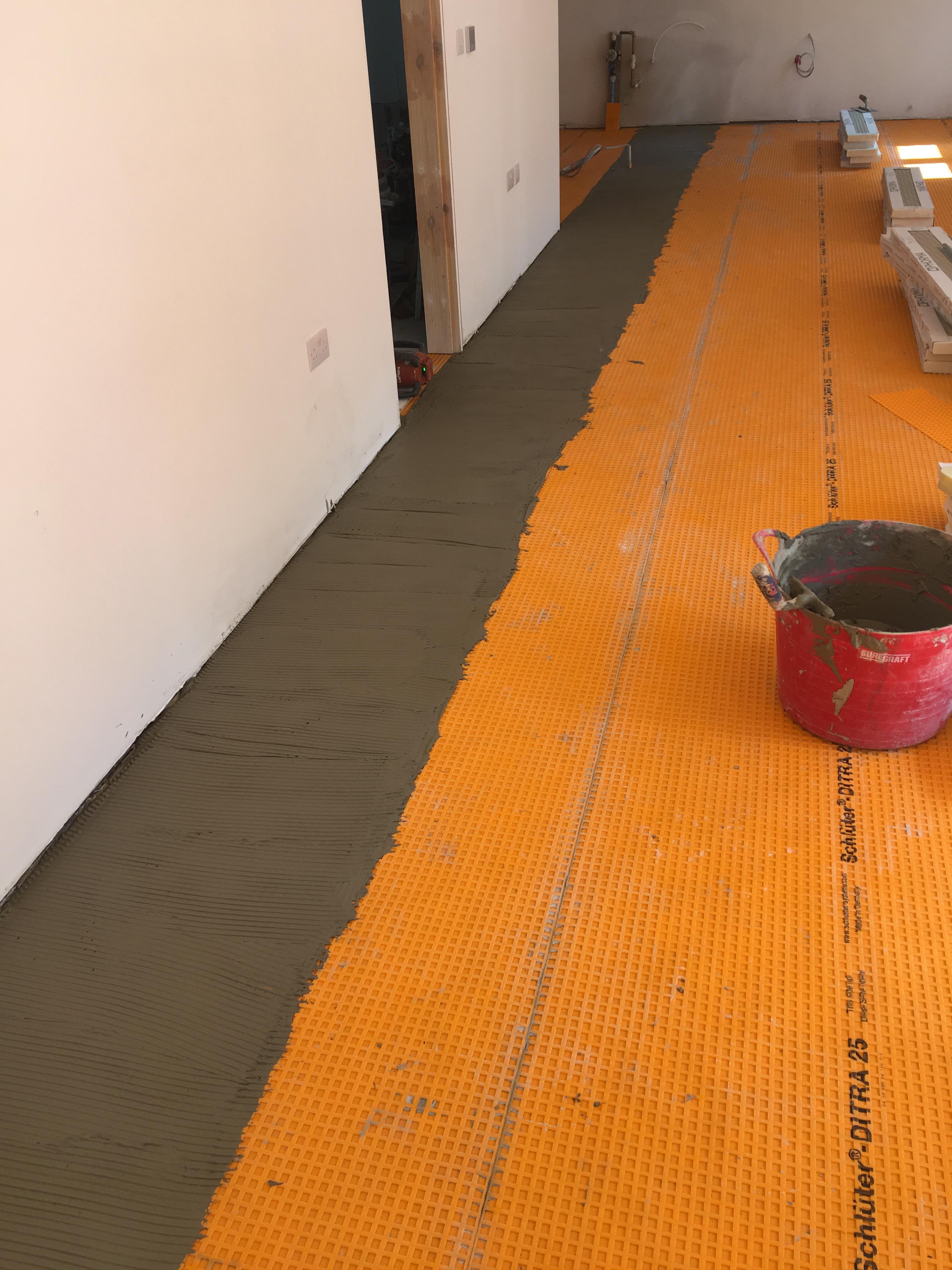

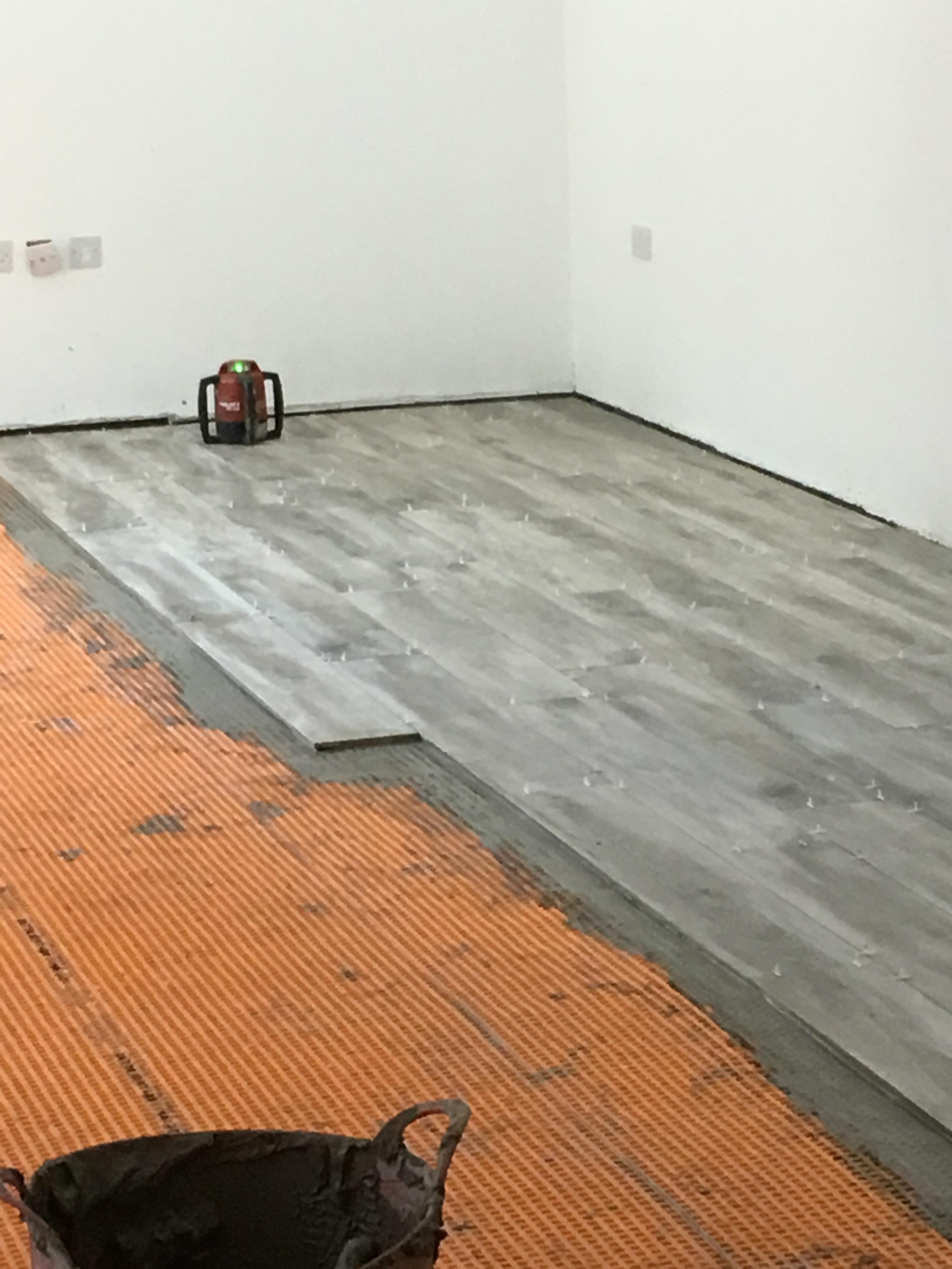

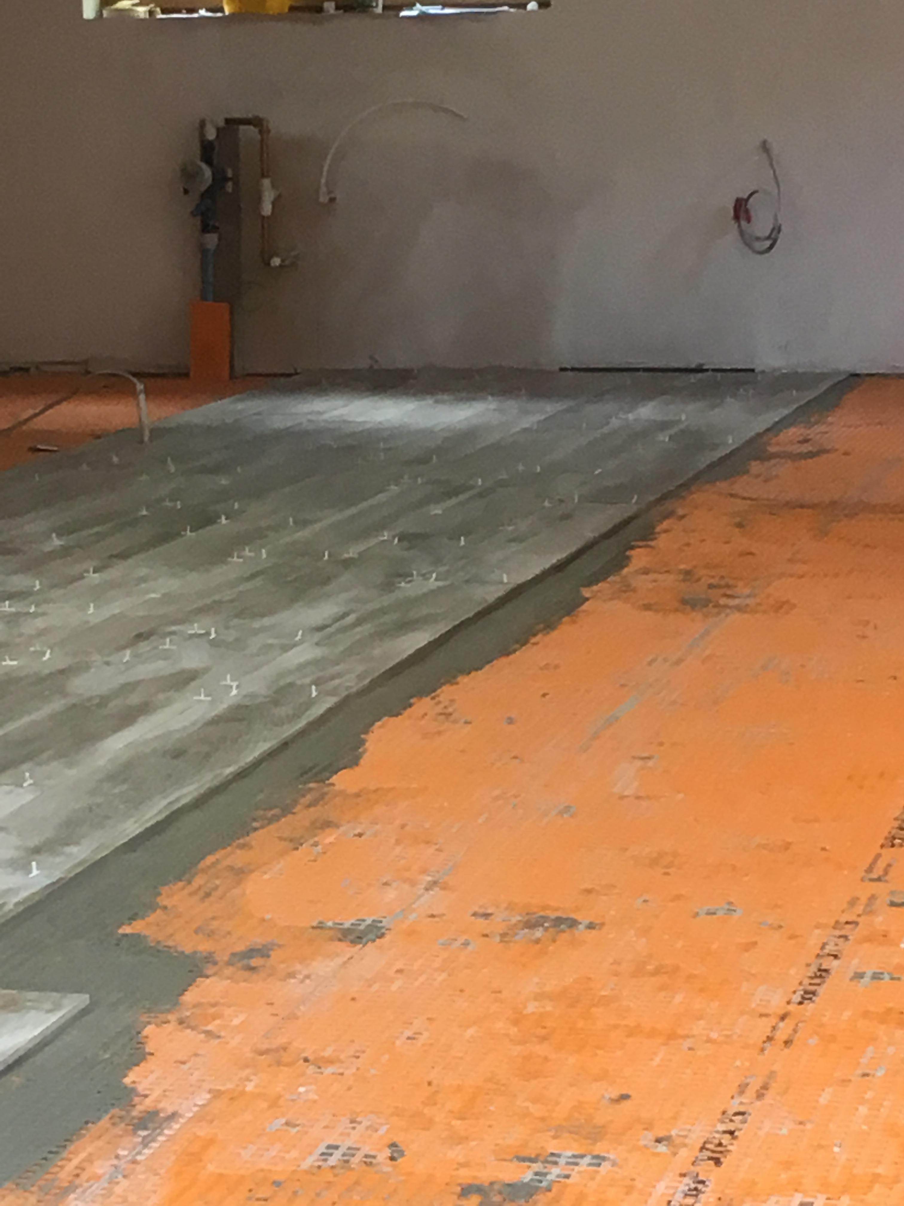

nod Posted August 24, 2018 Posted August 24, 2018 I finally made a start on the floor tiling this afternoon I really could do with a week off to get on with it ut paid work has to come first 5
MikeSharp01 Posted August 24, 2018 Posted August 24, 2018 @nodWhat us the orange stuff under the adhesive, looks like a great job and you are a brave man taking that amount of tilling on or are you a closet pro!
Jeremy Harris Posted August 24, 2018 Posted August 24, 2018 7 minutes ago, MikeSharp01 said: @nodWhat us the orange stuff under the adhesive Ditra decoupling mat. 1
CC45 Posted August 24, 2018 Posted August 24, 2018 Limits or elimates chance of cracked tiles due to floor movement. About £10/m2. I started our tiling last night - lot less progress than that though!
Onoff Posted August 24, 2018 Posted August 24, 2018 9 minutes ago, CC45 said: Limits or elimates chance of cracked tiles due to floor movement. About £10/m2. I started our tiling last night - lot less progress than that though! Tell me about it...
nod Posted August 24, 2018 Author Posted August 24, 2018 2 hours ago, MikeSharp01 said: @nodWhat us the orange stuff under the adhesive, looks like a great job and you are a brave man taking that amount of tilling on or are you a closet pro! 2 hours ago, MikeSharp01 said: @nodWhat us the orange stuff under the adhesive, looks like a great job and you are a brave man taking that amount of tilling on or are you a closet pro! Thanks Mike I served my apprenticeship plaster and tiling Back in the day it was the same job Long before flexible adhesives We used to screed in the morning and lay boards on it in the afternoon and tile with a cement mix The matting is a must for UFH 25 mtrs down this afternoon 125 to go Though I’ve just finish our last bathroom With a total of a 110 mtrs used between the three

MikeSharp01 Posted August 25, 2018 Posted August 25, 2018 9 hours ago, nod said: The matting is a must for UFH That's interesting, our UFH is in the slab and as we now intend to Tile, as the power float polish failed, do we need it?As things stand I was intending to tile directly to the slab after the failed polish is scabbled off.
Onoff Posted August 25, 2018 Posted August 25, 2018 8 minutes ago, MikeSharp01 said: That's interesting, our UFH is in the slab and as we now intend to Tile, as the power float polish failed, do we need it?As things stand I was intending to tile directly to the slab after the failed polish is scabbled off. F**cking hope not! I thought that's what flexible adhesive was for on a concrete floor. Isn't decoupling mat a must if your tiling say a ply topped floor?
Jeremy Harris Posted August 25, 2018 Posted August 25, 2018 The matting isn't needed at all for a modern, low temperature, UFH system with tiles laid on to a slab with embedded UFH pipes, as there will be zero relative movement from any temperature differential. The use of this matting harks back to the old days when poorly insulated houses needed UFH running at over 30 deg C in order to give enough heat output, so there was a significant temperature differential through the floor. No new build today, even one just built to meet building regs, is going to need UFH anywhere near that hot. The floor will get much hotter from the sun shining on it in summer than it ever will from the UFH. For example, it used to be that UFH installers would work on the basis of being able to get around 50 to 60 W/m² of heat from a UFH installation, sometimes more, maybe up to 80 W/m². That equates to a floor surface temperature of around 26 to 28 deg C for a 21 deg C room temperature, and a UFH flow temperature of around 30 to 35 deg C or so. No new build today is going to need that much heat, our house, for example, needs at the very most a floor surface temperature of less than 23 deg C, and there's no way whatsoever that 23 deg C is going to cause the slightest problem with relative movement - that's only 2 deg C warmer than the room. We never need a flow temperature that's higher than about 25 deg C, and that's only in the very coldest weather. I've measured floor surface temperatures of over 30 deg C in sunny areas in our old house, which doesn't have UFH, but does have tiles laid directly on a concrete slab and they've not cracked or moved in over 40 years.
