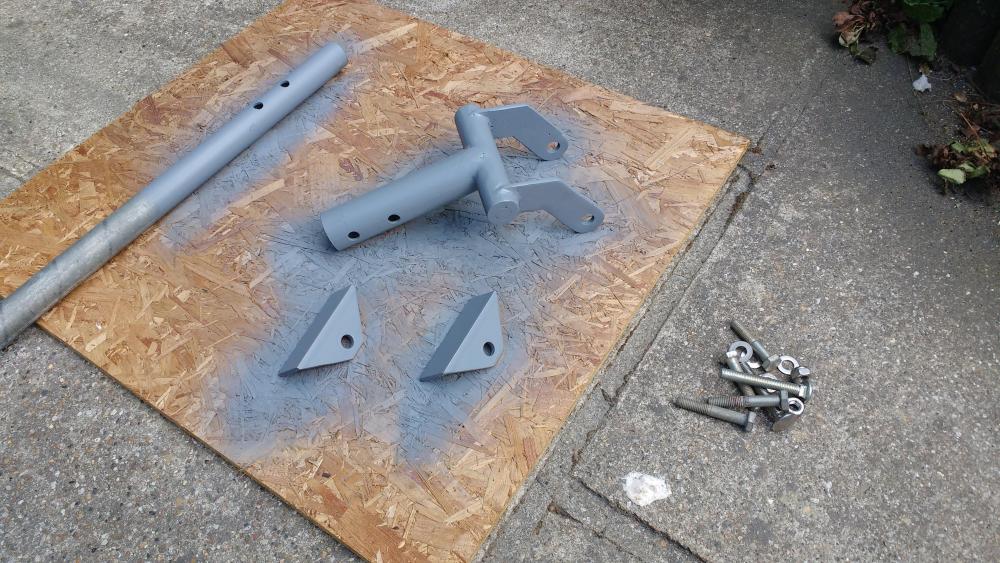

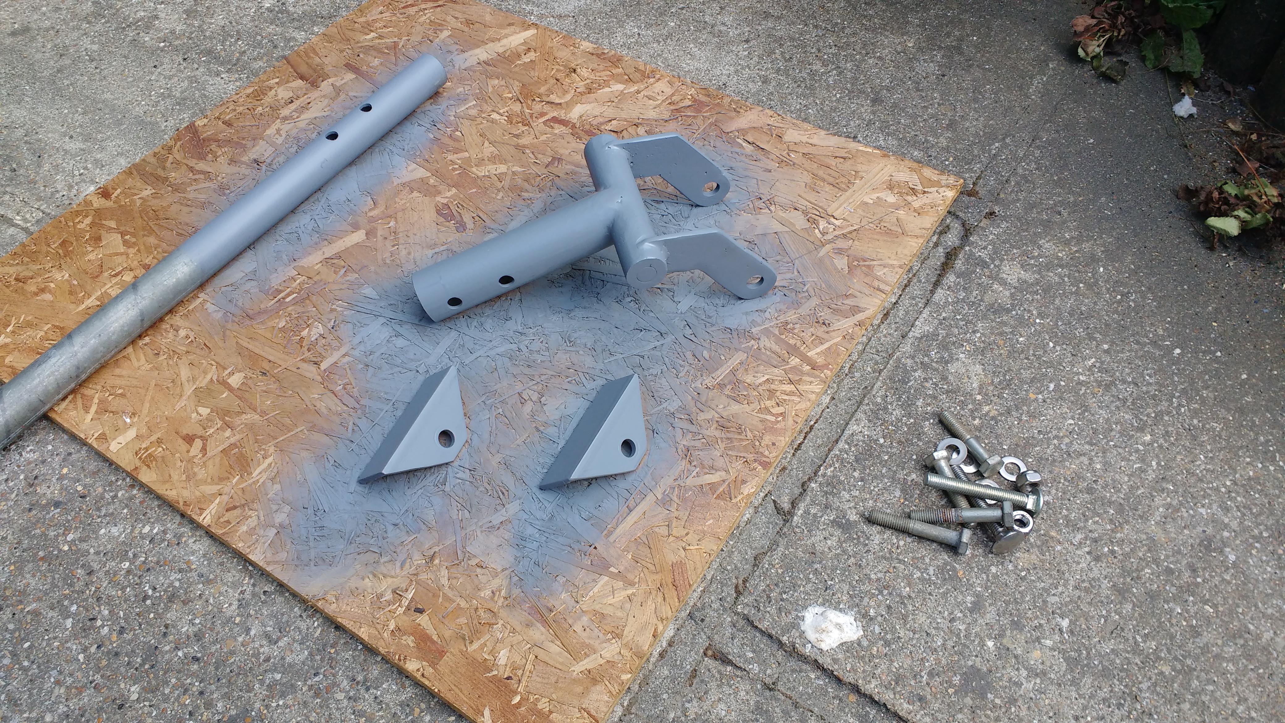

A coat of etch primer:
Then wait to dry and mull over what top coat I've got kicking around...

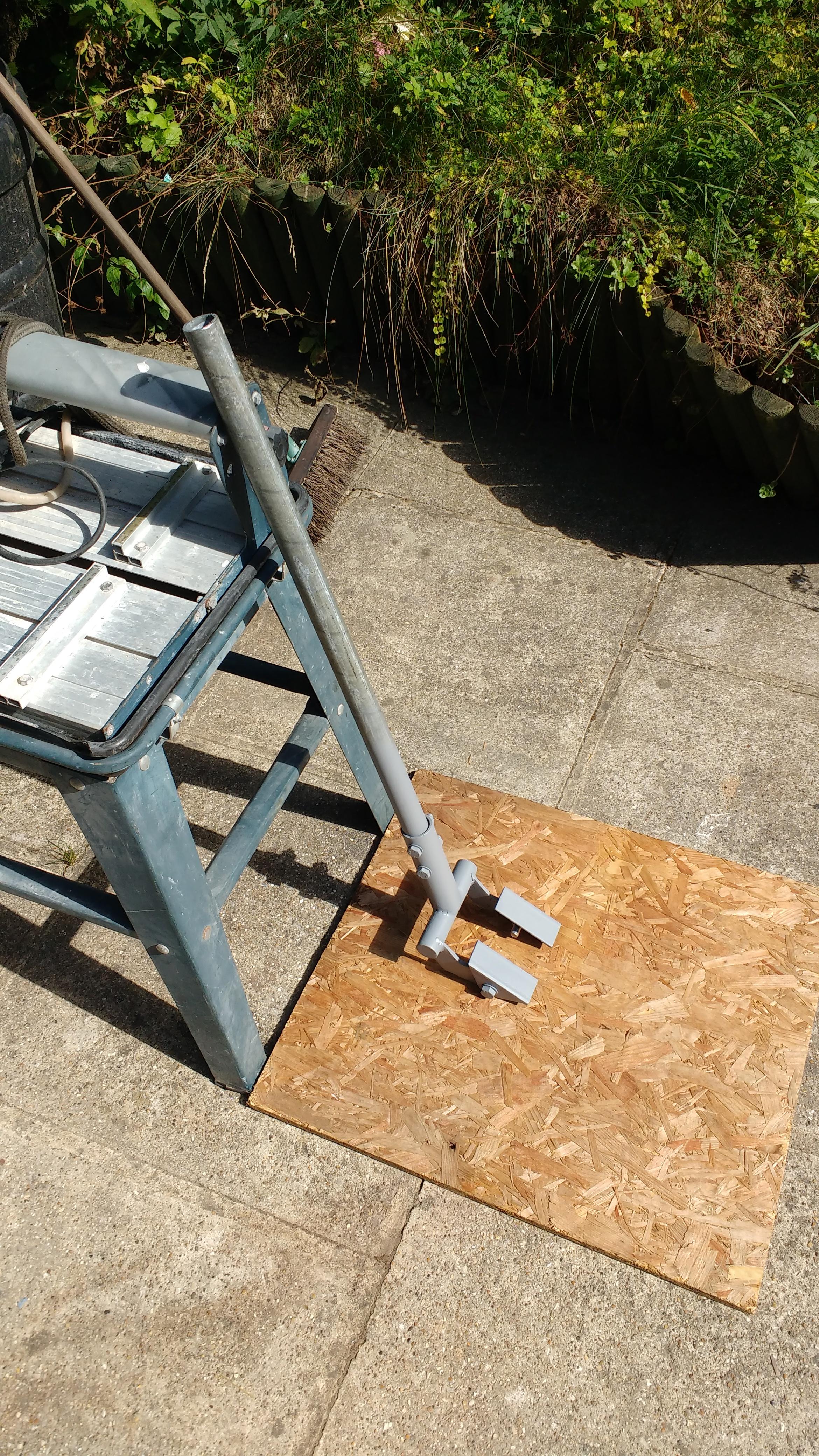

Anyway IT WORKS! Actually pretty effortless tbh.
I might replace the steel tube handle with a bit of thick wall ali tube I scored (30 years ago) as I imagine it could get a lump to wield after a while.
I need to trim the M12 bolts that the angles pivot on, this so it can slip over "two inch" main members on pallets. At the mo the distance between angles is nom 54mm. If I reversed the angles so they pointed outward it'd go over a 90mm main member.
Happy enough anyway, cost nowt but some leccy, discs and rods.
