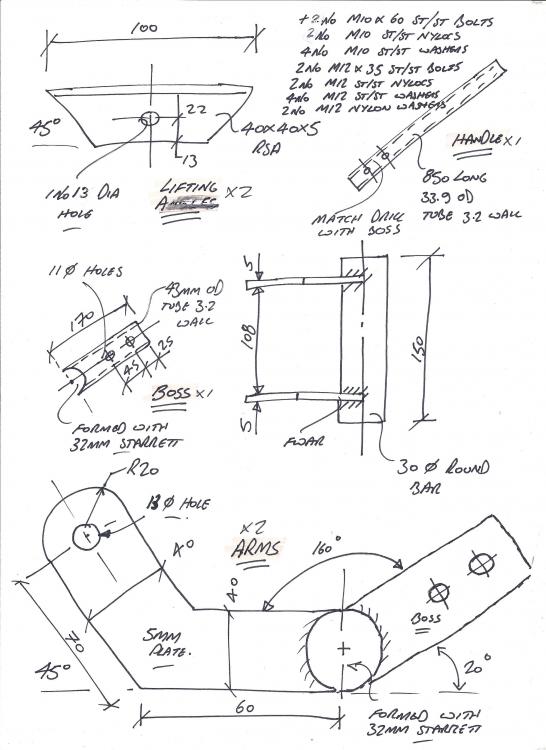

Dog rough sketch but this is mine. Be aware of the width between angles and mod if req'd to suit the pallet main members:
Don't forget to put the st/st nylocs on the bolts with a bit of copper slip etc. Stops them binding!

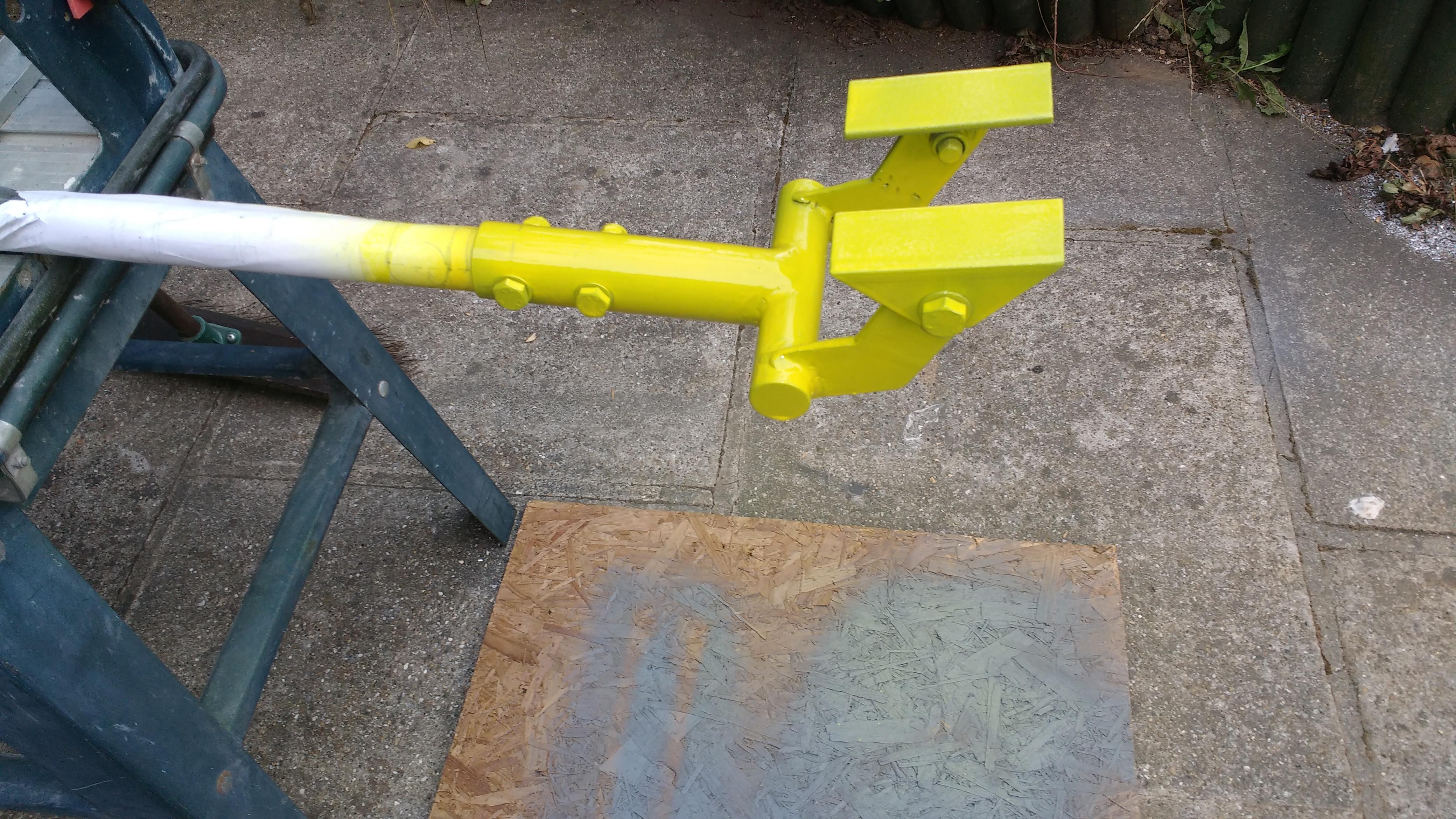

Making it look pretty with a rattle can found in the garage:
Can spray paint go out of date? Damp, early evening isn't maybe the best time to spray tbh...the runs!
Anyway, paint finish should last for a good 30 seconds on the tool's next outing!

@Onoff the Screwfix version looks a bit puny compared to yours. Isn't there more danger of the boards splitting if the lifting plates aren't articulated?
I would hope their's is toughened steel maybe like fork prongs. Without trying it I don't know how well it performs but it appears to work equally as well as mine if not better and be lighter. Gut feel is that the "S" bend shape of the forks adds strength and also aids the lifting action, lifting one side first then the other? Tbh lifting one side first then the other should take less effort. MIne was specifically made with the intent of putting equal pressure across the two nails - it therefore takes more grunt. I reckon there's less chance of splitting the wood. Tricky one to call!

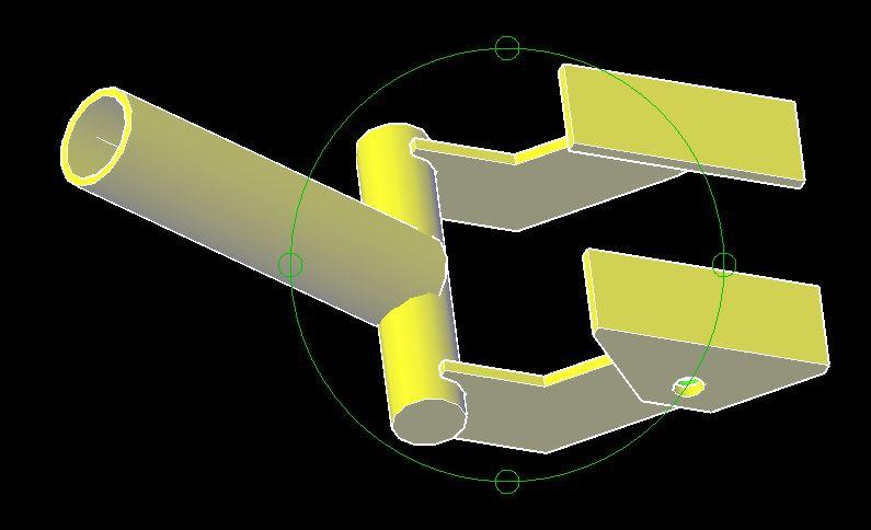

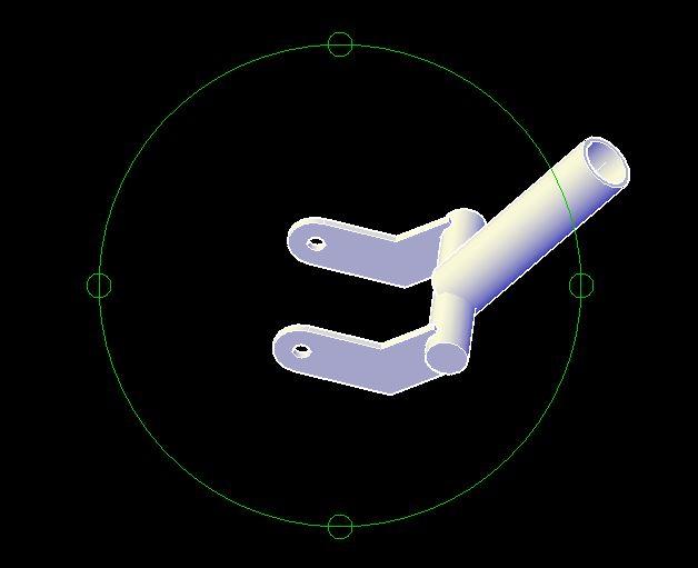

Bored...started to model it on CAD...bored again now! :)

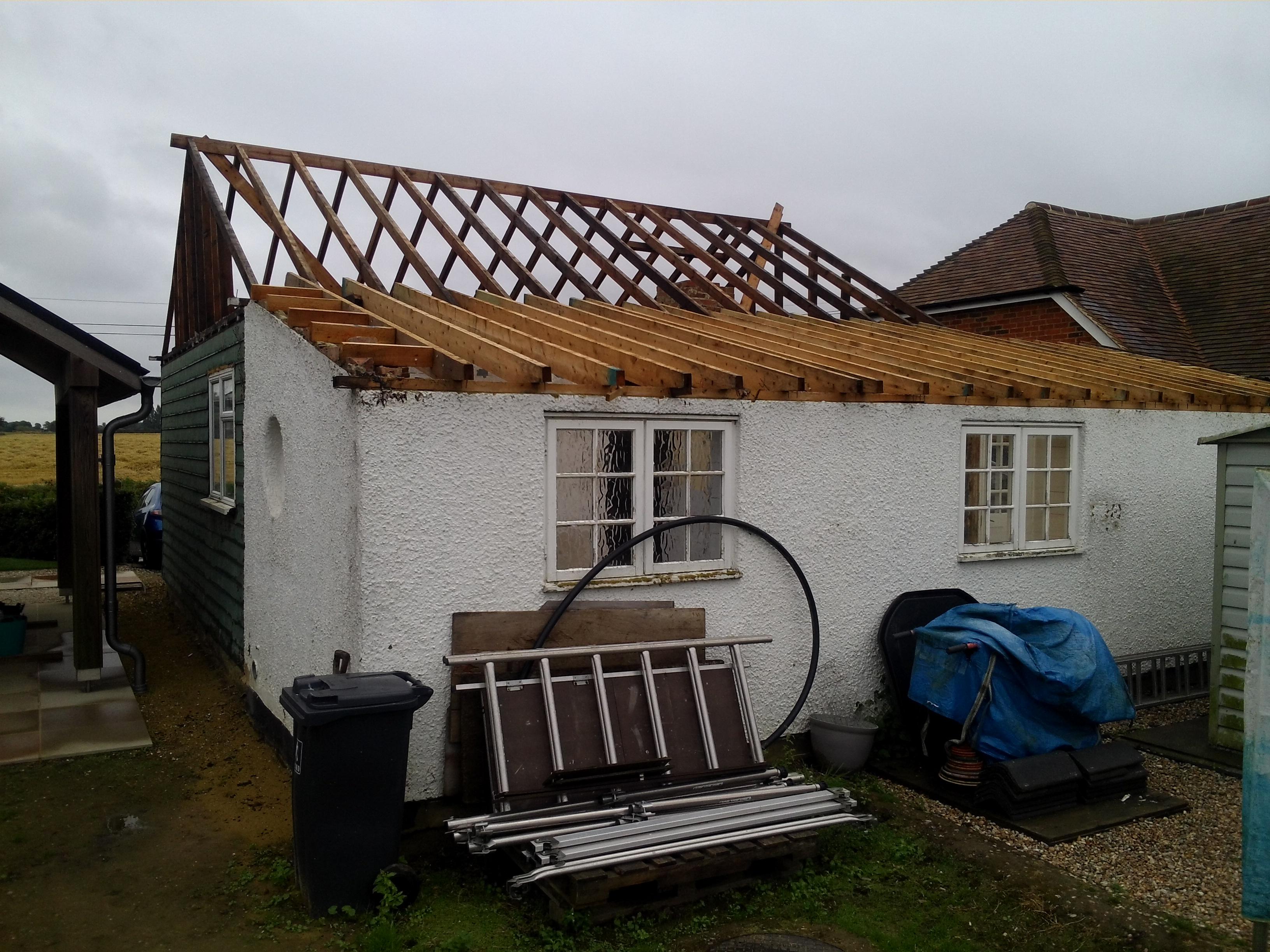

Unfortunately it has rained a couple of times recently and I've removed most of the roof, only the rafters to go. The floorboards have got wet and swollen so unless we have a dry spell they might not come up too easily.
Posted
What you need is a big shed to store stuff in...to stop it getting wet... :)
Seriously you took 8 years on the house so the shed needs to compliment it and look a bit "special" I'm thinking!
