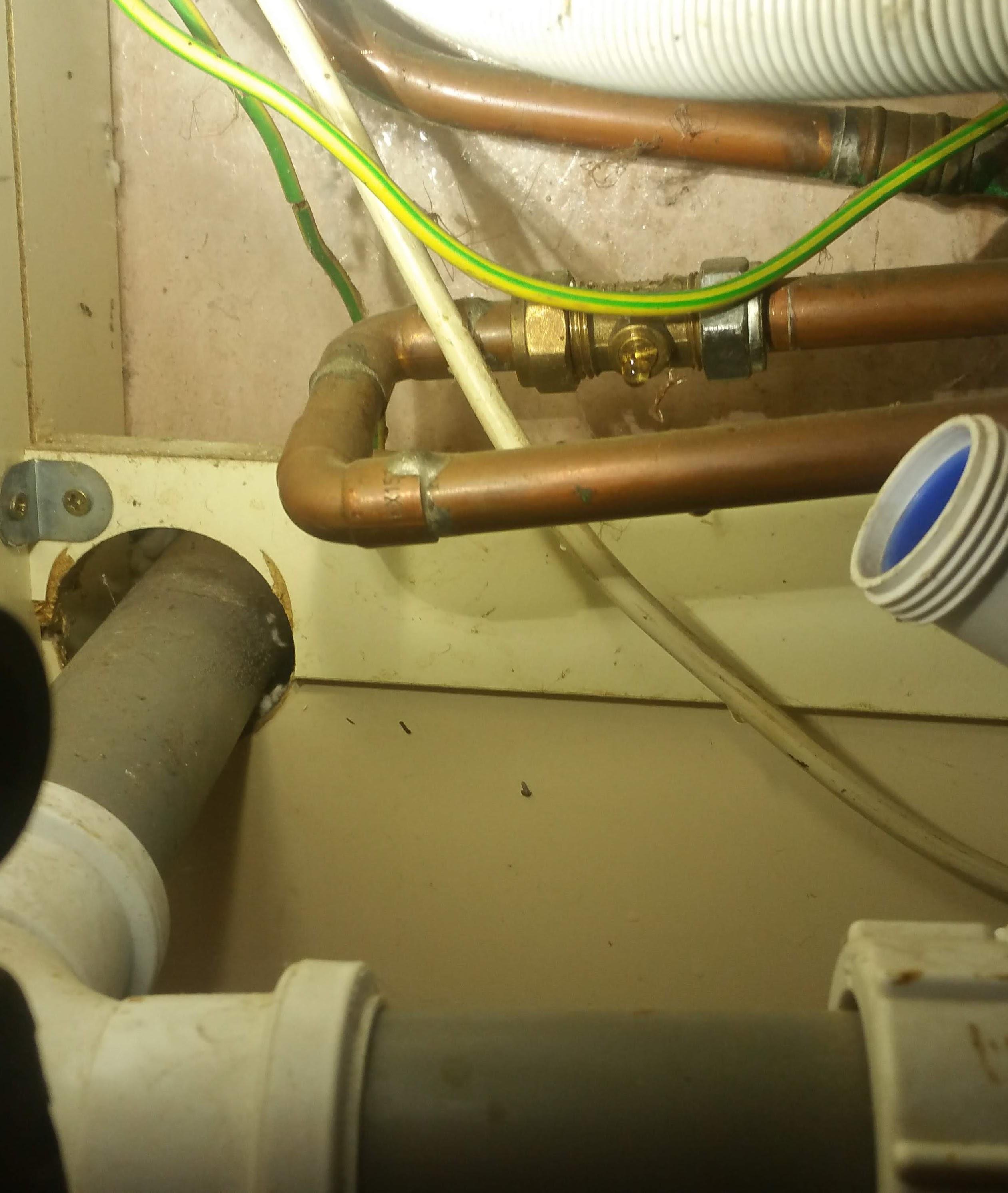

ToughButterCup Posted August 18, 2018 Author Posted August 18, 2018 20 hours ago, Nickfromwales said: [...] More info please boyo. . Right. Here's what's under the sink. And it isn't good news. The photo is of the hot water supply under the mixer tap in question. Approaching this with what I think is logic (but probably isn't) .... work back from the tap towards the newly fitted equipment. Take a close look at the valve thingy. I thought it would be a good idea to rotate the screw in the middle a quarter turn to see if that changed anything. And immediately got a squirt of water coming through the screw seating. You can still see a drop of water on the screw head. Cue quick exit, photo and this post. 20 hours ago, Nickfromwales said: [...] Is hot pressure / flow reduced at all the outlets in the whole house or just the kitchen sink ? Just the kitchen sink. Other taps on the line are flowing normally. The kitchen sink is the last in the supply line from the boiler. 20 hours ago, Nickfromwales said: Close the stopcock fully, and then count the number of turns to fully open. [....] Opened fully and then backed off a quarter turn. This feels like the issue is local to the kitchen sink. Ian
PeterW Posted August 18, 2018 Posted August 18, 2018 Ballofix is knackered. Thats why you have no flow.
Onoff Posted August 18, 2018 Posted August 18, 2018 Fit a decent Pegler one. Looks tight in there but something like this. It's full bore too: https://www.screwfix.com/p/pegler-tee-ball-valve-red-15mm/29086
Jeremy Harris Posted August 18, 2018 Posted August 18, 2018 +1 Looks like the shaft seal has gone and the shaft ,may have parted company from the ball, leaving the ball valve partially closed. It looks like it's recently been replaced,a s the chrome compression nut is the one from the valve that used to be there.
PeterW Posted August 18, 2018 Posted August 18, 2018 If this is in the old house then this will fit straight in - undo the two nuts when you’ve turned the water off, and slot it in.... Isolating Valve You don’t need a full bore Pegler in a single tap supply ... ?
Onoff Posted August 18, 2018 Posted August 18, 2018 3 minutes ago, PeterW said: If this is in the old house then this will fit straight in - undo the two nuts when you’ve turned the water off, and slot it in.... Isolating Valve You don’t need a full bore Pegler in a single tap supply ... ? I meant 'cos it's Pegler. Full bore just a bonus.
PeterW Posted August 18, 2018 Posted August 18, 2018 It’s a kitchen isolator .... in a house he’s selling ... and will fit straight in... ?
Jeremy Harris Posted August 18, 2018 Posted August 18, 2018 9 minutes ago, PeterW said: It’s a kitchen isolator .... in a house he’s selling ... and will fit straight in... ? Exactly. I've fitted loads of the cheap ones (the ones that come five or ten in a bag from Screwfix) and can't ever remember having a valve problem, other than the damned things getting jammed with limescale. Even the most expensive Pegler ones can get jammed with limescale, though. I've a policy of only fitting expensive, brand name, valves in places where they are going to be used relatively frequently. For example, the three lever full bore valves on our softener are expensive ones for that reason, as are the lever ball valves either side of the water filter. The rest are all bog standard ones, that I doubt will get operated in my remaining lifetime.
