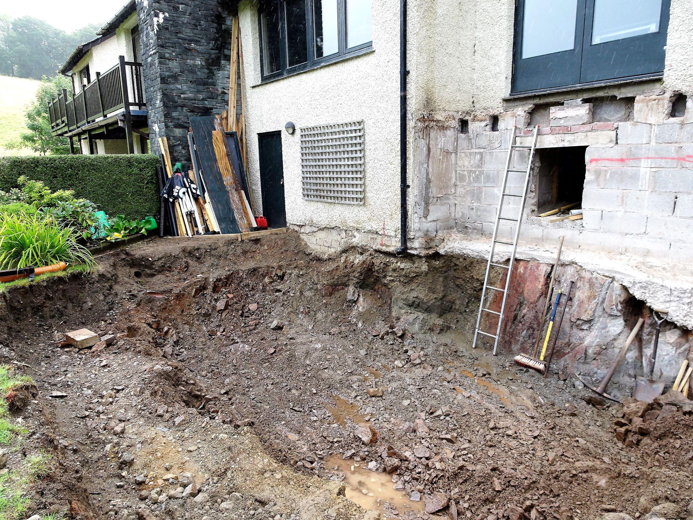

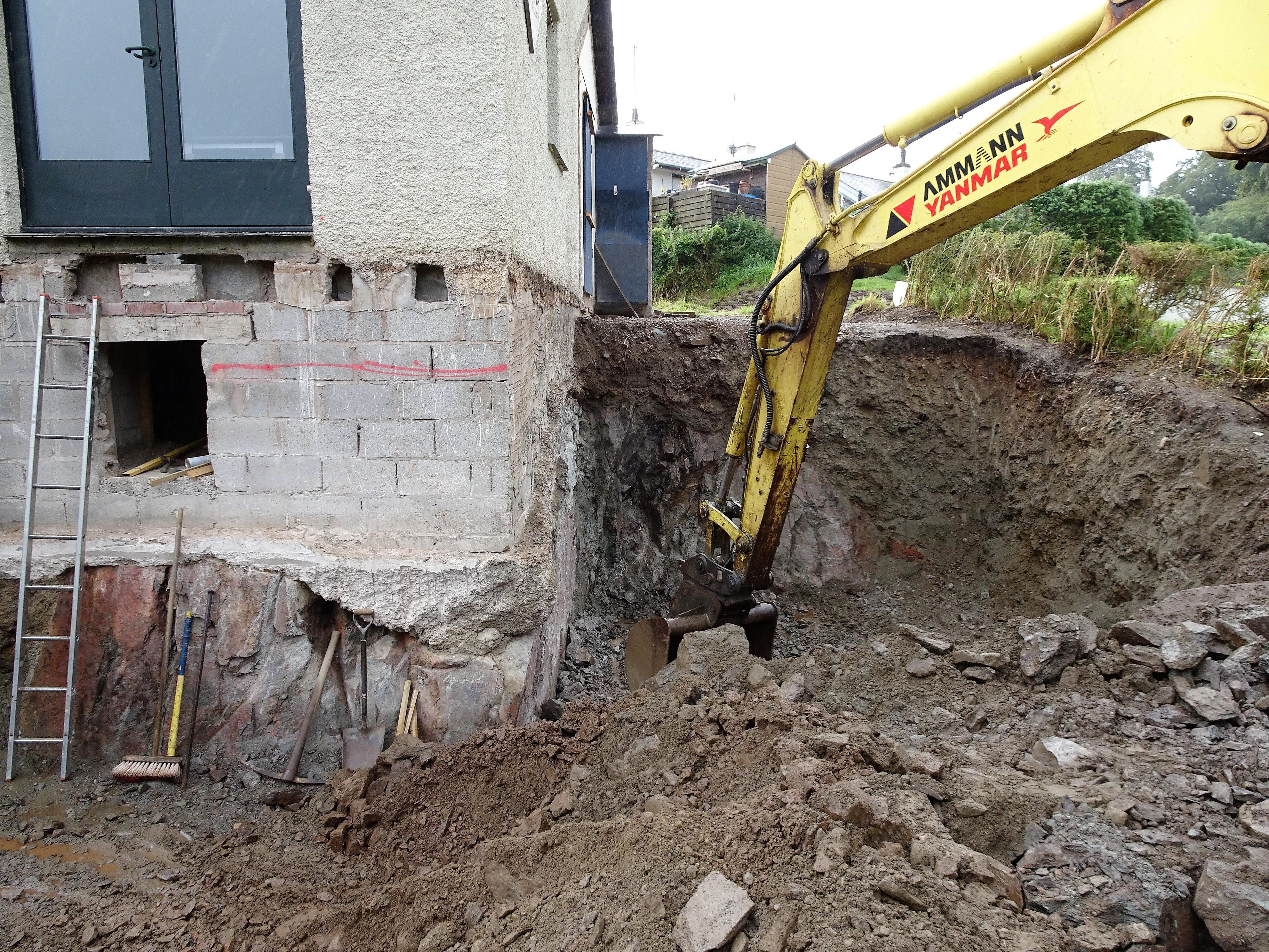

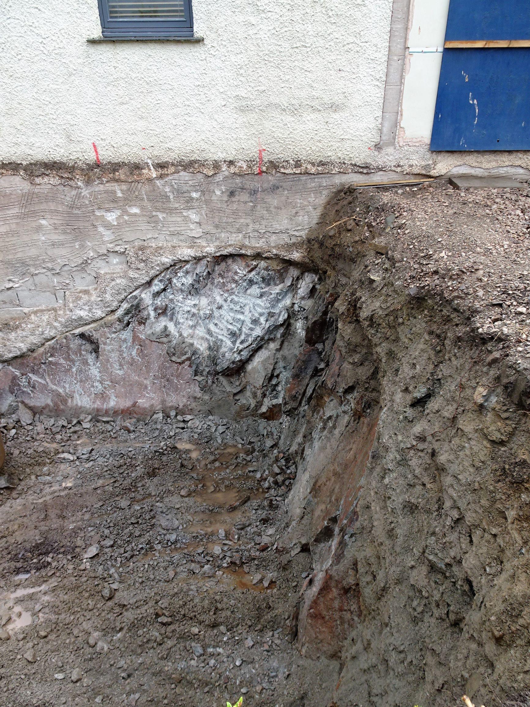

Chablais Posted August 15, 2018 Posted August 15, 2018 (edited) So I have had a ten ton digger pecking rock out to make way for a basement and extension. Was planning on 200mm EPS under the slab, and 200mm EPS around the exterior of the basement walls. I do have two walls against the existing house to retain the house founds, as well as creating the basement walls. SE has categorically stated he will not entertain EPS300 under the slab. We are on solid rock for almost the whole slab. It is supporting three stories above. Some pics showing existing founds etc. Was going to use Jackodur system as it also creates the former to pour the concrete too. I was initially concerned when we exposed the existing house founds and the SE had a fit and demanded all work stop, until the house was underpinned. However I elected to continue and pecker out the rock, wether through luck or judgement the house is still standing. So now I either accept the SE proposals or find another one for a second opinion. Rebar sched2 (1).pdf SE version2.pdf Edited August 15, 2018 by Chablais spelling

Chablais Posted August 15, 2018 Author Posted August 15, 2018 Hi All His major concern is giving support to the existing foundations, he has said that he thinks the EPS will deform under loading. He also said he thinks the whole raft could slip. I said i thought the reinforced slab would spread the load, and had suggested using EPS300. There appears to be plenty of steelwork both in the slab, which has A393 and A252 mesh, and the walls which have 12 and 16mm rebar and A393 mesh. My concern is that he may be saying this as he may not have any experience of using EPS. He is even against me using it on the exterior of the basement walls. He is suggesting a 50mm concrete blinding to level the site and 200mm concrete on top. As it stands I will need much more material to level the site, circa 150-200mm in places. Double whammy on finding another SE, as all very busy with at least a month wait, plus the extra costs of paying two. As a layman it seems at odds to argue with the proffessionals, but I was hoping to be much more thermally efficient with slab on EPS method Not sure which way forward, architect has sided with the SE as expected.

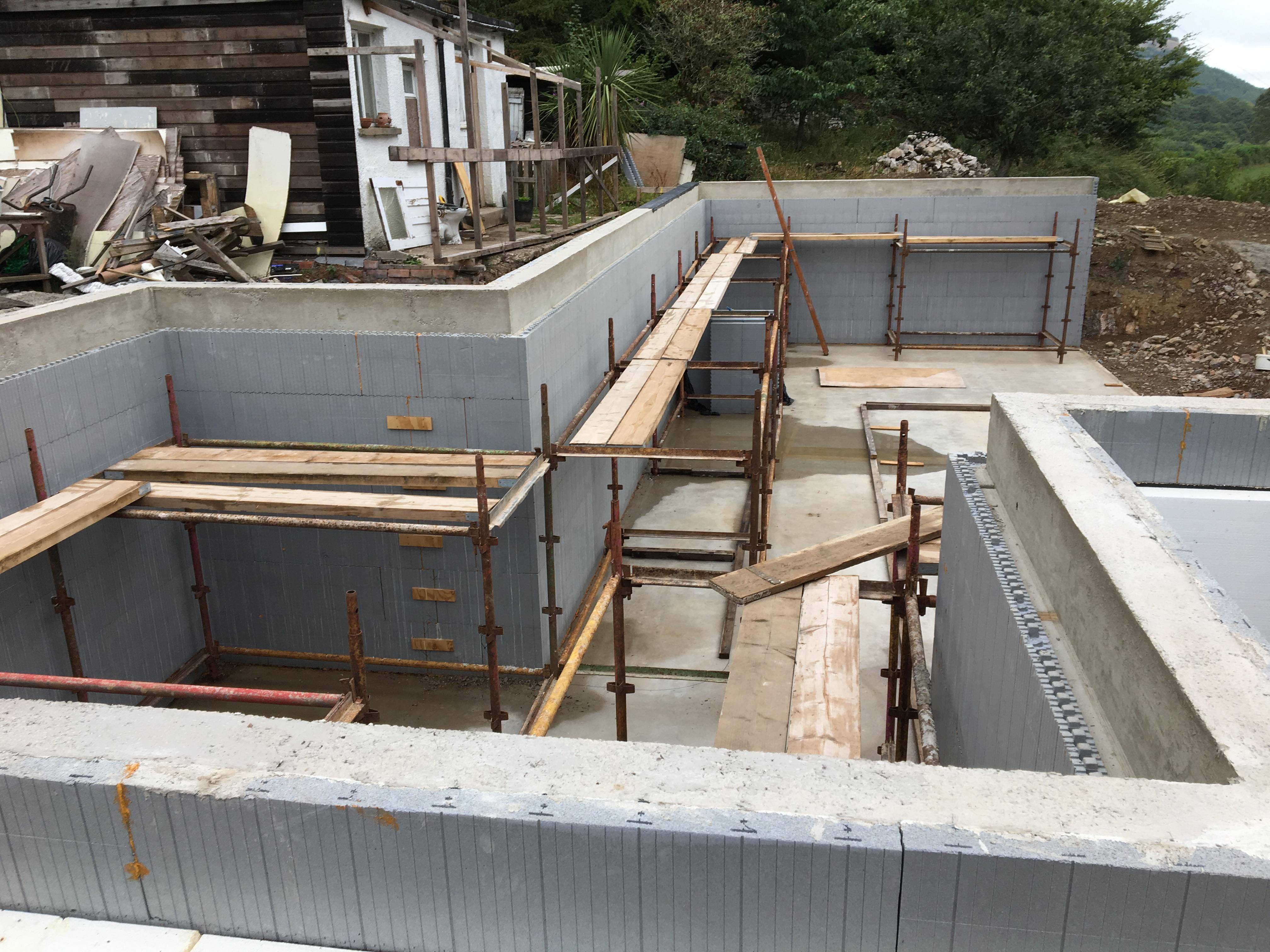

Triassic Posted August 15, 2018 Posted August 15, 2018 (edited) I’d suggest he doesn’t really understand how EPS raft foundations work. Ive just built a basement on limestone rock. The basement sits on 200mm of EPS. There is 26m3 of concrete in the raft and 26m3 of concrete in the retaining walls, there’s also about 4 tonnes of steel reinforcing in the whole lot. I have 170mm of insulation behind the retaining walls. The house sits on top of this lot! Edited August 15, 2018 by Triassic 1

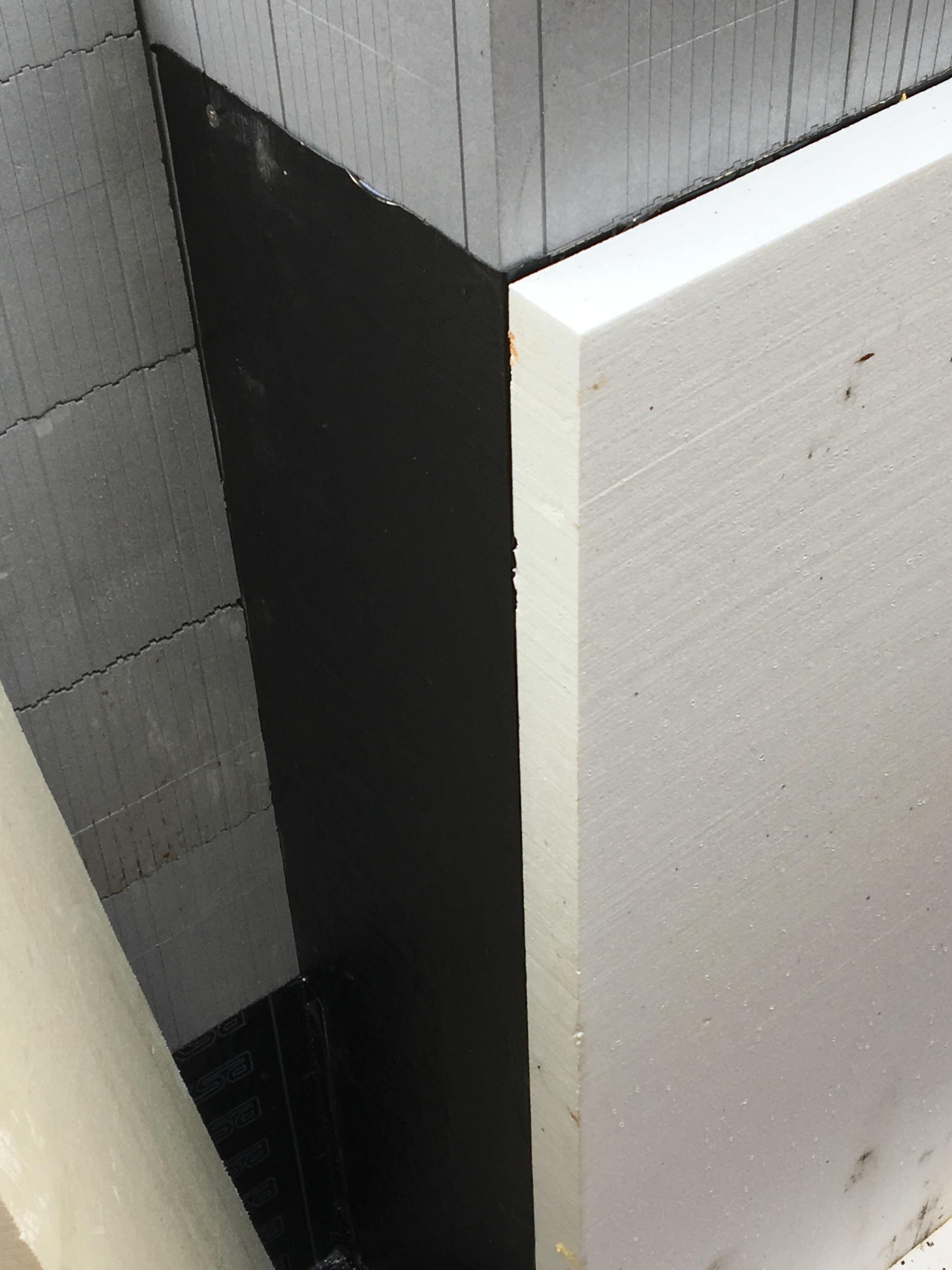

Triassic Posted August 15, 2018 Posted August 15, 2018 (edited) I am using Ian, he’s a good hard working guy. I have used ICF to construct the basement walls. Waterproofing is on the outside and is protected by a 100mm thick layer of polystyrene to stop the backfill damaging it. Again, come and have a look. Edited August 15, 2018 by Triassic 1
