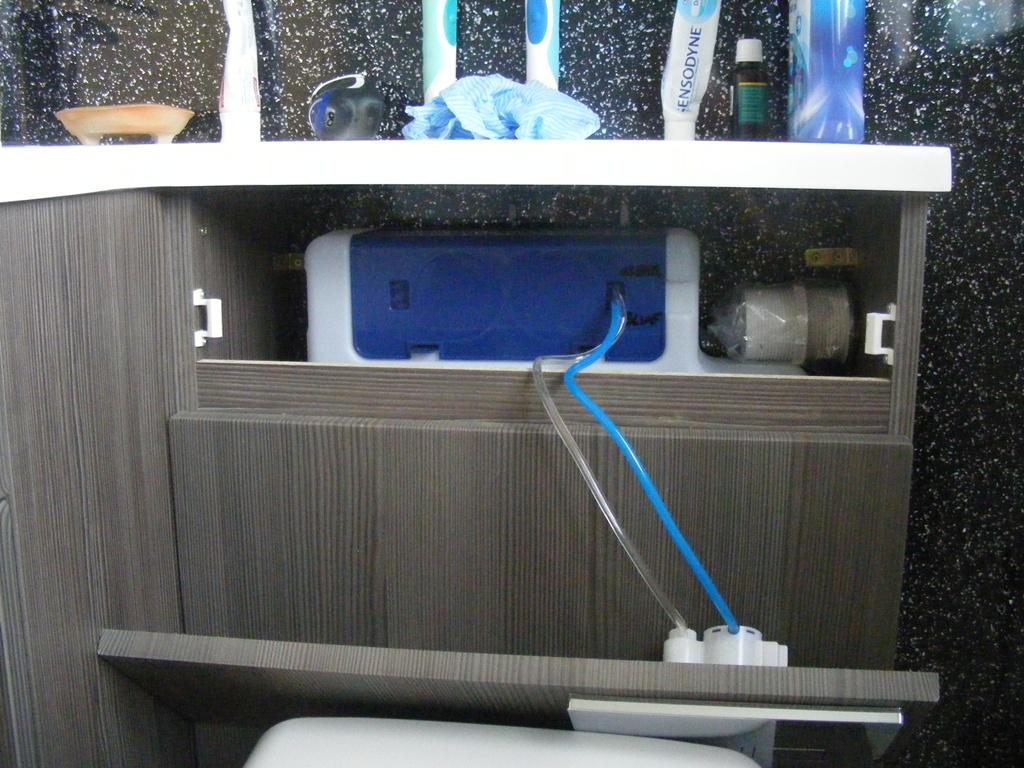

ProDave Posted August 15, 2018 Posted August 15, 2018 This is my one The panel with the flush plate unclips to give access to the cistern than can be serviced through the blue panel on the cistern SWMBO chose it. It came from one of the sheds but I forget which one. It wasn't expensive. I had been pricing some units from Howdens but this came in a lot cheaper. It was just the cabinet, basin and taps from the shed. The Pan was bought on line for just over £50 and the cistern and flush plate Iirc came from BES 1
Nickfromwales Posted August 15, 2018 Posted August 15, 2018 6 hours ago, ProDave said: This is my one The panel with the flush plate unclips to give access to the cistern than can be serviced through the blue panel on the cistern SWMBO chose it. It came from one of the sheds but I forget which one. It wasn't expensive. I had been pricing some units from Howdens but this came in a lot cheaper. It was just the cabinet, basin and taps from the shed. The Pan was bought on line for just over £50 and the cistern and flush plate Iirc came from BES They're nice little units. The L-shape stuff looks more expensive than it is so a good option. The cisterns do have the access through those panels, so the tops only ever need to come back off if there is a major failure.

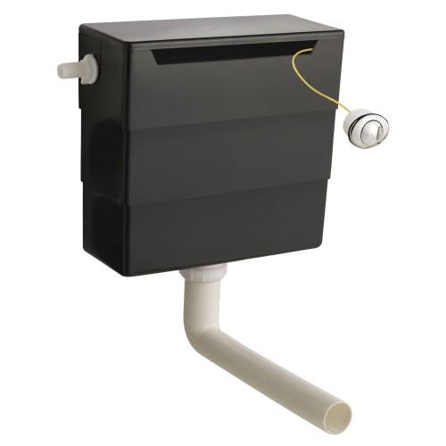

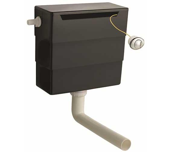

Onoff Posted November 2, 2018 Posted November 2, 2018 Tight arse mate in a rented place wants a wall mount, concealed cistern wc like mine but wants to pay peanuts! I tell him Geberit and he tells me he's found a no name frame and pan for around £120! Exit pipe is horizontally straight through the wall. Just thinking out loud here... Concealed cistern, 5 year guarantee for <£20: https://www.qssupplies.co.uk/bathroom-furniture-shower-taps/77484.htm? At first glance, no name etc so what's the point? Then there's this Hudson Reed cistern, again <£20 with a 5 year g'tee. Surely the same model? I reckon then I can copy a Geberit frame with the 2" box I've lying around: A goer?

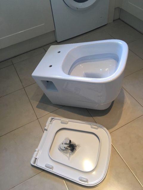

Onoff Posted November 3, 2018 Posted November 3, 2018 (edited) 1 hour ago, Triassic said: Yes, definatly. But in a rental, does he have permission!? Permission? Likely not! He's just managed to puncture the incoming mains water when trying to fix a squeaky upstairs floor board. Did the same about 10 years back! Lucky he's the ground floor & basement tenant and the neighbours are upstairs. Reckons the landlord would redo the bathroom just to a very basic level with "6"x6" plain white tiles" in his words. He's just redone the ground floor laminate wood floor himself. Back to the budget wc frame and drawing on what others here have done: Simply thinking a 4"x2" half height (or less) frame screwed to the floor boards and existing wall. Removeable top shelf to access the cistern. Hell, at <£20 buy two cisterns. So the cistern just bolts to the wall. What drew me to the ones above was that you can buy it branded as Hudson Reed and as a few of us in here know it's generally good stuff, certainly on the shower mixer etc front. He's spotted a new, unused, wall hung pan and seat for £35. Back to the frame then I've got my spare UP200 frame here to copy from. I reckon with a bit of forethought I could even do away with the adjustable height legs if I knew the new pan dimensions and existing poo pipe heights. Or just allow for 5mm of steel packs. Tbh he'll have gone out and bought a cheapo set by the time I get around to this but it keeps the grey matter ticking over! Edited November 3, 2018 by Onoff
