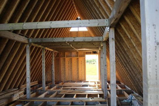

Ed Davies Posted August 14, 2018 Author Share Posted August 14, 2018 1 hour ago, Nickfromwales said: Im intrigued as to where this 10 tonnes of water will sit? It's an east-west A-frame built over a post-and-beam frame. Here's a view looking towards the west gable at the end of last month when I hadn't yet put the last two triangular bits of OSB in the top. The thermal store will go along the north side (to the right of the posts). That's part of why I went for an A-frame, normally the “wings” there are considered a waste of space but I have a use for them. Window holes to be cut in the south roof later. Link to comment Share on other sites More sharing options...

Nickfromwales Posted August 14, 2018 Share Posted August 14, 2018 14 hours ago, Ed Davies said: That's part of why I went for an A-frame, normally the “wings” there are considered a waste of space but I have a use for them. Agree its a wasted space otherwise, but what will keep 10 tonne there? Will the weight simply be spread over a long distance and things beefed up as required? Bespoke tanks ? Its an interesting idea so im keen to better understand it. Thanks. Link to comment Share on other sites More sharing options...

Ed Davies Posted August 15, 2018 Author Share Posted August 15, 2018 12 hours ago, Nickfromwales said: Agree its a wasted space otherwise, but what will keep 10 tonne there? Will the weight simply be spread over a long distance and things beefed up as required? Bespoke tanks ? Its an interesting idea so im keen to better understand it. Thanks. Site-made tanks. Timber frame with EPDM liners. Quite commonly done by people in the US. Not very deep as the there's a reasonable length to play with (about 13 metres) so the weight will be pretty spread out. It was, of course, taken into account in the structural engineering. 1 Link to comment Share on other sites More sharing options...
Jeremy Harris Posted August 15, 2018 Share Posted August 15, 2018 11 minutes ago, Ed Davies said: Site-made tanks. Timber frame with EPDM liners. Quite commonly done by people in the US. Not very deep as the there's a reasonable length to play with (about 13 metres) so the weight will be pretty spread out. It was, of course, taken into account in the structural engineering. Sounds like a very neat solution to making insulated tanks. I'll be very interested in the performance, as a couple of years or so ago I read of a similar store that was built using a cylindrical tank that ran up the centre of the building, with the stair case wrapped around it. Sadly I can't remember where I read about it; may have been in the Passive House magazine. On a vaguely related topic, many years ago a friend (who, it has to be said, is slightly more eccentric than I am...) converted an old chapel into a house. He built a hollow insulated blockwork square section "tower" in the centre of the chapel and filled it with large granite rocks that he collected from the beach, one by one in the back of his 2CV. In between the rocks he laid resistive heating elements stripped from old storage heaters (together with the iron blocks), modified to run from a low voltage supply. He used a home made wind turbine to "charge" this big thermal store, and had ducts with low voltage fans and shutters that led from the store to each heated room. The system worked very well, although he was in a good position for getting a reasonable amount of wind power, on top of a hill in South West Cornwall. By a very weird coincidence my great grandfather had been the minister at that chapel around 1900, and my great aunt was born in the house alongside. Link to comment Share on other sites More sharing options...
