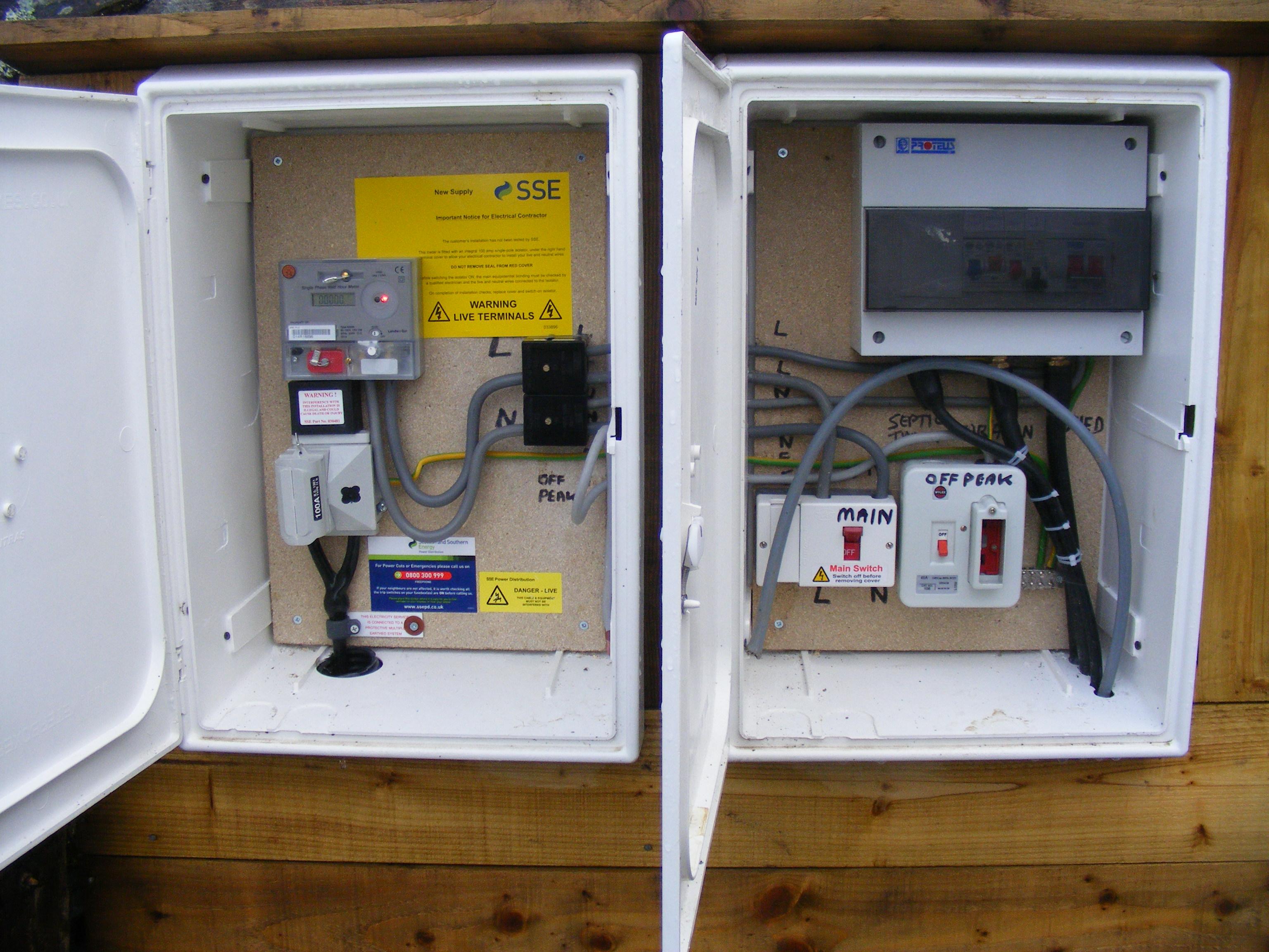

CC45 Posted August 8, 2018 Posted August 8, 2018 I just mounted some white plastic meter boxes on a post. Put a simple wood board over the lot to protect further. Padlocks on each one. Job done. £50. @ProDave did a very neat job - check out his blog.
Roundtuit Posted August 8, 2018 Posted August 8, 2018 I've got a block-built boundary 'outhouse' - as above, I put a couple of the plastic surface-mount meter boxes in it as it was without a roof or doors for 18 months.

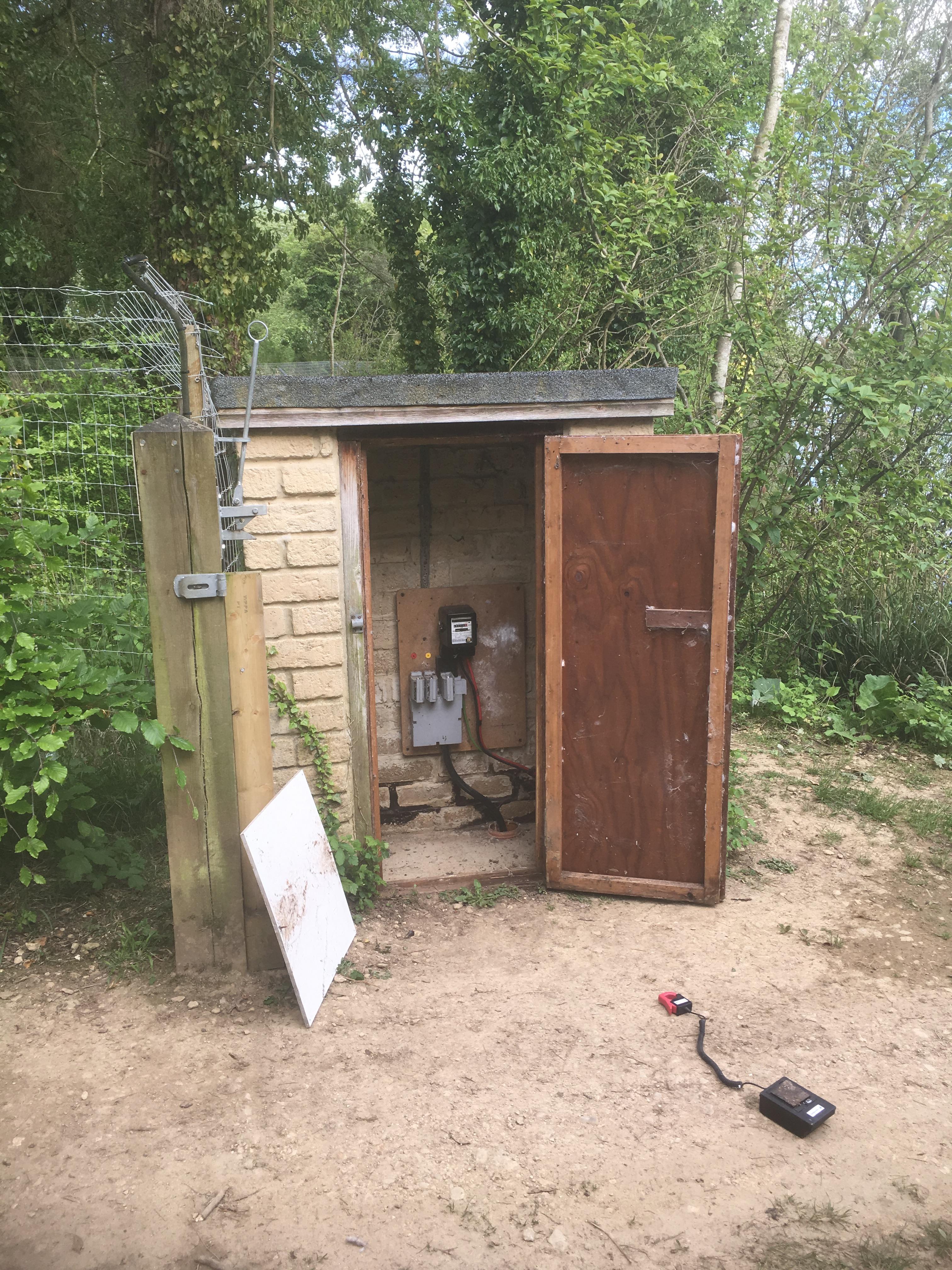

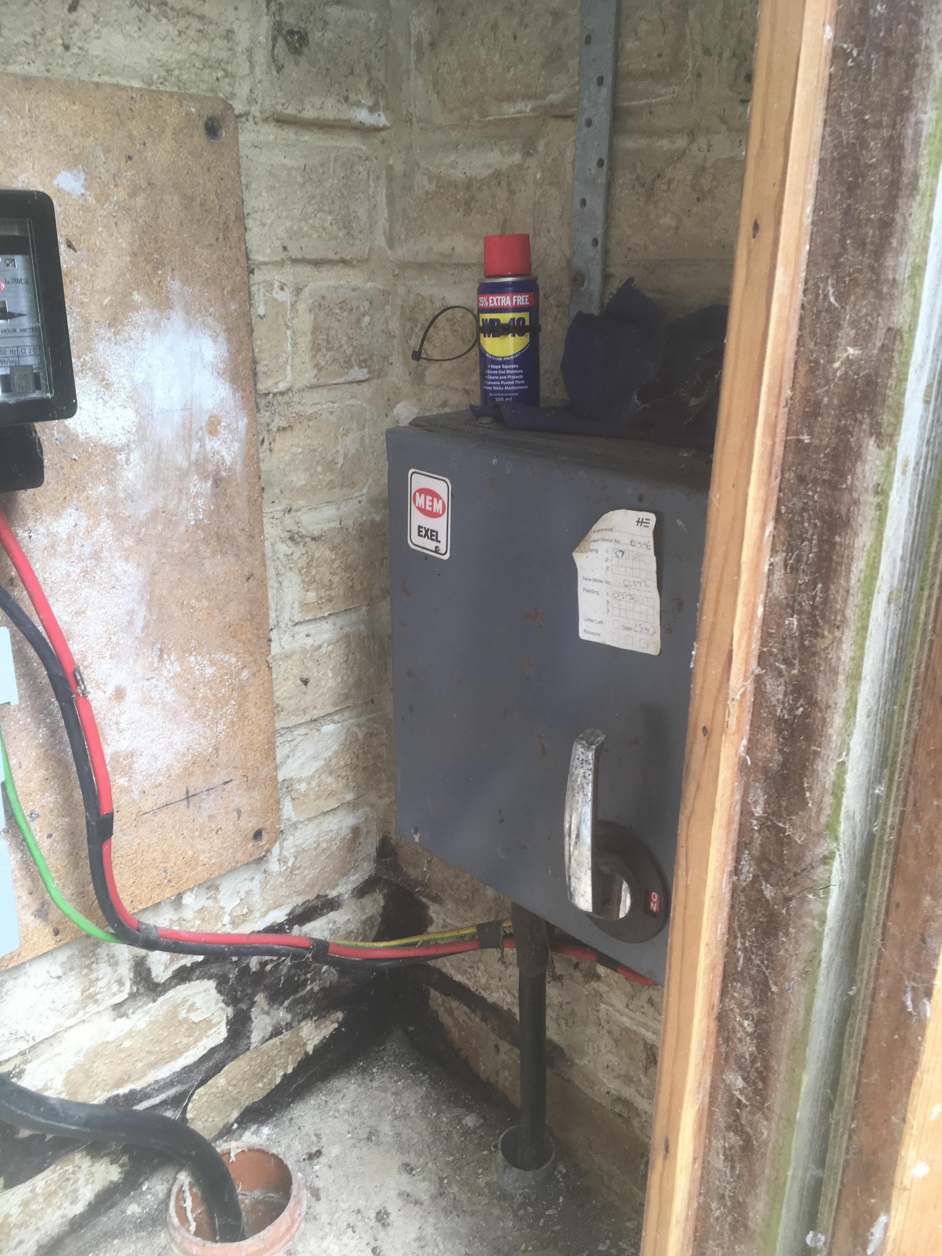

LA3222 Posted August 9, 2018 Author Posted August 9, 2018 (edited) Some good examples there @Russell griffiths and @worldwidewebs - very similar to what I'm looking to build. Three Phase Supply there @Russell griffiths....Im getting a three phase supply put in, a nice expensive heavy duty isolation switch you have there. Only problem with three phase so far is everything seems to shoot up in price! Edited August 9, 2018 by LA3222

sean1933 Posted March 28, 2019 Posted March 28, 2019 (edited) On 09/08/2018 at 21:33, LA3222 said: Some good examples there @Russell griffiths and @worldwidewebs - very similar to what I'm looking to build. Three Phase Supply there @Russell griffiths....Im getting a three phase supply put in, a nice expensive heavy duty isolation switch you have there. Only problem with three phase so far is everything seems to shoot up in price! I know this is a relatively old thread but what did you go for in the end? I'm in exactly the same situation and struggling to decide/interpret what I can get away with from UKPN. 3phase system to be installed near the boundary which will be used as TBS then main supply once house and garage are going up. We much prefer the idea of building a brick hut (security and look) but the UKPN spec refers to a 100mm reinforced concrete roof slab which I'm struggling to work out how to build it (other than pour in situ), and it will look naff! It seems to be a requirement as the surveyor wrote on the papers to ignore spec written and build a hut thats at least 1.2H 1W 0.3D 'concrete roof'. I really like what you did worldwidewebs - I assume because your meter is in a cabinet that the roof didnt have to be concrete? I had considered doing the same and forking out for a surface mounted 3phase meter cabinet but they are something like £220, plus as we plan to use it as a TBS it still doesnt get us over the issue of space for sockets etc.. and I hate the idea of buying 2! Any further views greatly appreciated - its a relatively trivial issue but its causing me a slight headache regardless! Side point - where did you guys locate the TBS earthing pin, outside the kiosks or through the slab? Edited March 28, 2019 by sean1933
LA3222 Posted March 29, 2019 Author Posted March 29, 2019 @sean1933 I built a kiosk out of concrete and block work. I left enough slab to be able to add a brick outer at a later date once I know which bricks I intend to use for the plinth of the house. I too put a concrete slab on top - yes it's fugly it I will do something later to tart it up - cover it with wood, paint it or some such at a later date. I intend to plant around it to semi hide it too. To make the roof I made a form out of wood, bit of rebar and concrete then job done. Weighed a couple hundred kilos so took two of us with a strop and digger to lift into place. I have no temporary earth. NPG have connected the supply to the pme earth from the get go. I intend to get a caravan consumer u it installed using a TT earth which will give power for the build and our static. Once I'm back down sarth I'll post some pics from my computer showing wot I dun! Disclaimer. I am no pro. I am entirely making this up as I go. It may not look particularly pretty.?
