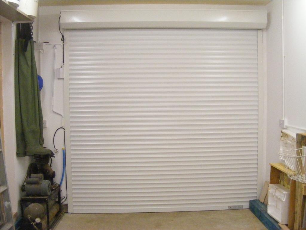

ProDave Posted August 6, 2018 Posted August 6, 2018 I want to get a door on our garage that has been sitting doorless for nearly 3 years now, so I can get it set up properly as a workshop. Originally we were planning an electric roller door which (I haven't actually had a quote) I understand would be in the order of £1K But as ever in a quest so save money. SWMBO points out the garage is not for a car, they will live under the car port but we will need to get cars in to get them over the pit for servicing (and my Landrover might end up living in there) So we don't need electric, manual will do. Because the plan was a roller door, we didn't make it to any particular standard size and it has ended up with an opening size of 2370mm wide and 2310mm high. Of course now I am looking for a cheaper option, I find none of the off the shelf standard doors will fit. Any ideas? A manual roller door might be the simplest, they fit behind the opening on the inside not in the opening, so the size does not have to be so precice. So anyone know a supplier of cheap manual roller doors? Another alternative might be a pair of hinged timber doors, but again not found a standard set that will fit.

ProDave Posted August 7, 2018 Author Posted August 7, 2018 20 minutes ago, Carrerahill said: Electric roller door with fob will be about £750.00 for that size. Roller Doors UK on ebay have come back with a price of £565 including delivery to the Highlands, 2 keyfobs etc. So I will ptobably go with that.

ProDave Posted August 10, 2018 Author Posted August 10, 2018 I gave up trying Roller Door UK. They never answered their phone, and then a negative review popped up on ebay. I tried a couple more, and ended up placing an order with Roller Doors Direct in Scunthorpe, they are another one that lists on ebay. £505 including delivery for a 55mm insulated roller door made to measure. Paid for in full by credit card so I should have some protection if it fails to turn up. I will keep you posted.
ProDave Posted August 29, 2018 Author Posted August 29, 2018 The door arrived today, exactly when they said it would. Delivered by there own van who drove up from England yesterday, dropped one at Aberdeen this morning and a couple more to do in Scotland before he heads back. Ii was easy to fit, fitted perfectly and seems to work well. 1
ProDave Posted September 20, 2018 Author Posted September 20, 2018 Just updating with some photo's Here is my bargain basement roller door in place And this was what it was all about, getting the garage / workshop organised. 1
