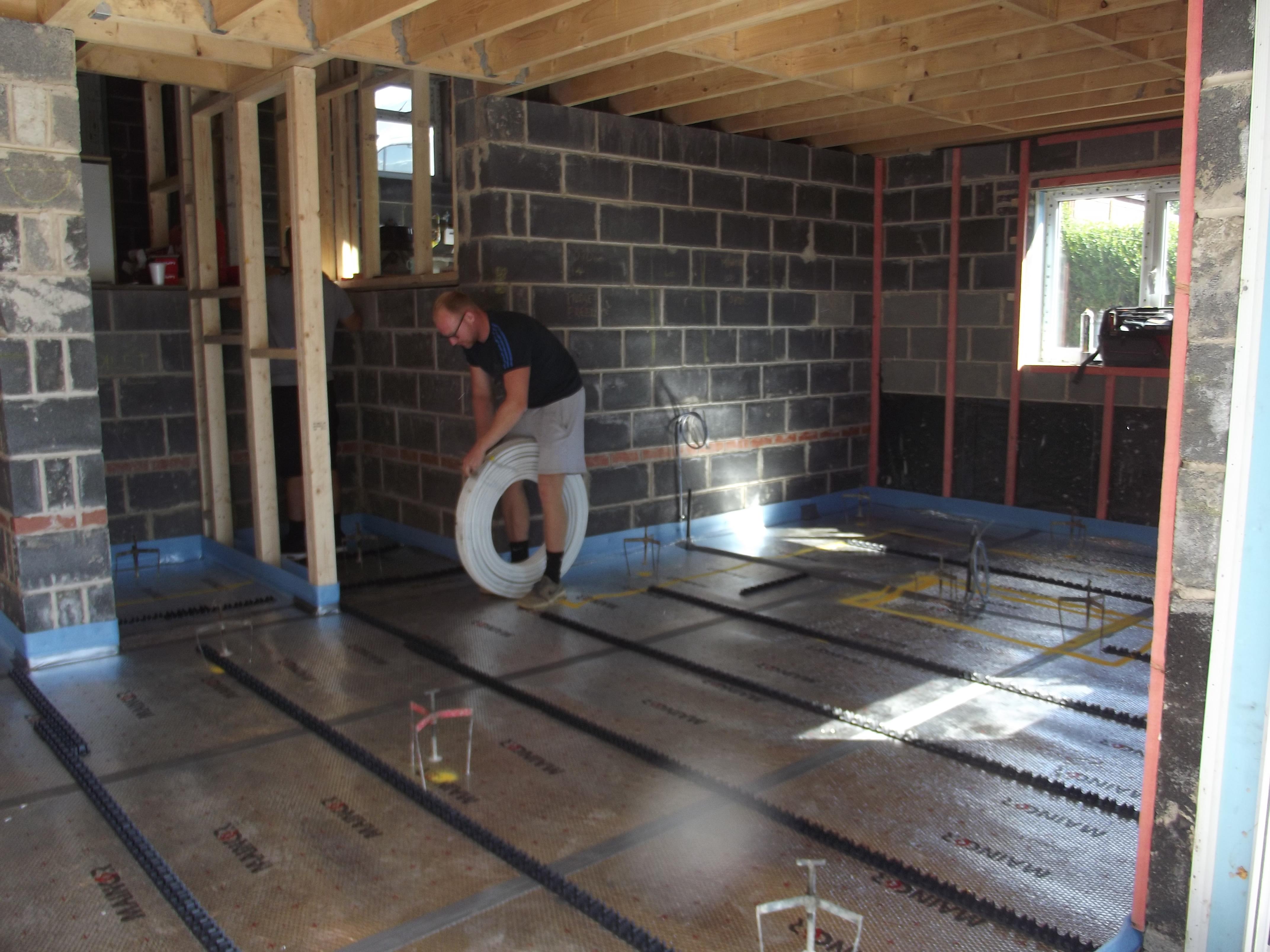

Hecateh Posted July 31, 2018 Author Share Posted July 31, 2018 12 minutes ago, Nickfromwales said: Ask them to shutter around them with sand then. You need to be able to manipulate the pipes after install ideally. They'll probably register on BH now and tell me to FO They've put some of the blue edging foam round and taped it. The pipes are extended above the floor level above so there is plenty of flexibility. They say they haven't sleeved pipes for years 1 Link to comment Share on other sites More sharing options...
newhome Posted July 31, 2018 Share Posted July 31, 2018 Did they lay the pipes too? Looks pretty neat! Good to see things moving on for you. 1 Link to comment Share on other sites More sharing options...

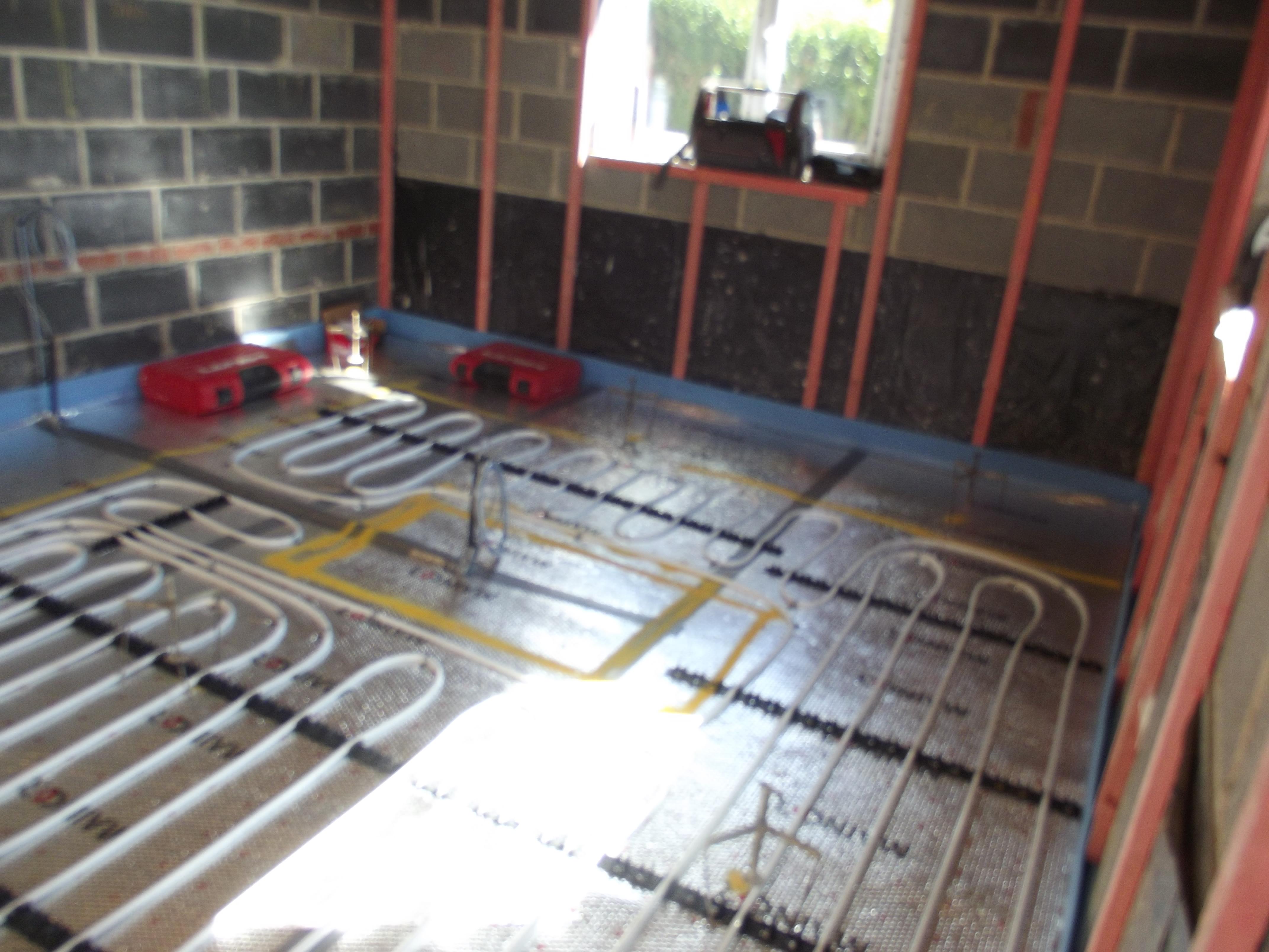

PeterW Posted July 31, 2018 Share Posted July 31, 2018 @Hecateh if the screed isn’t down yet, can you take more photos of areas such as the island and the kitchen ..? Always useful for reference. Link to comment Share on other sites More sharing options...
Hecateh Posted July 31, 2018 Author Share Posted July 31, 2018 4 minutes ago, newhome said: Did they lay the pipes too? Looks pretty neat! Good to see things moving on for you. Thanks @newhome each little step is one less I still have to take. Just need to pin the plumber down to a date now!! And then the plasterer! 2 minutes ago, PeterW said: @Hecateh if the screed isn’t down yet, can you take more photos of areas such as the island and the kitchen ..? Always useful for reference. All done and dusted - they've just left. Taken plenty of photos though 1 Link to comment Share on other sites More sharing options...

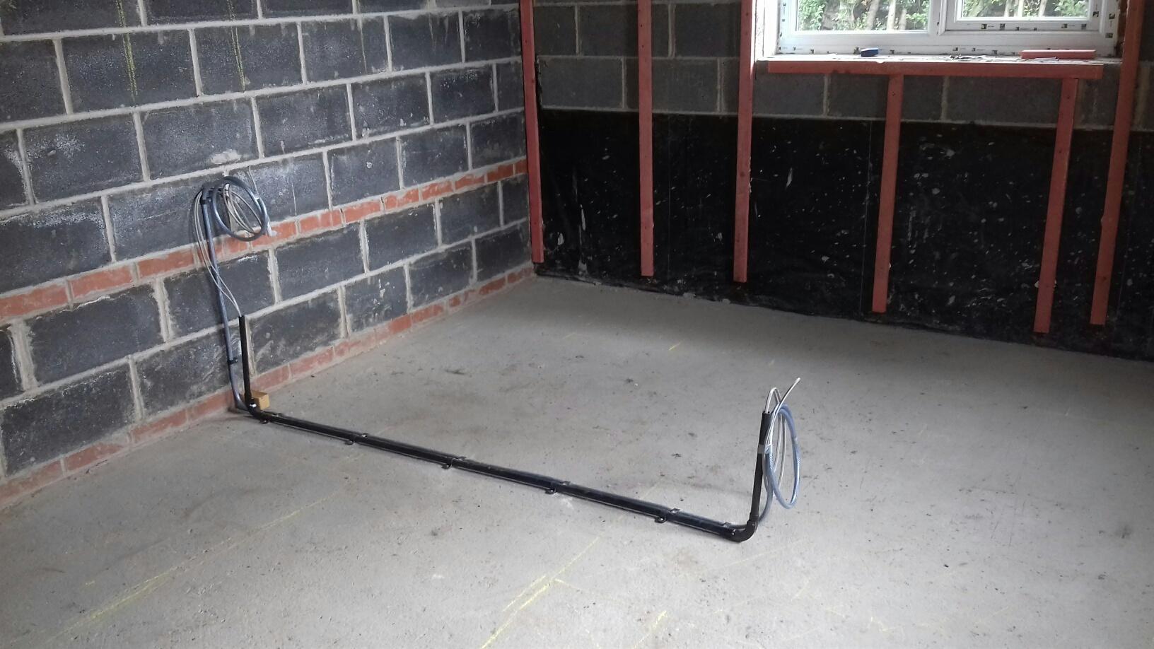

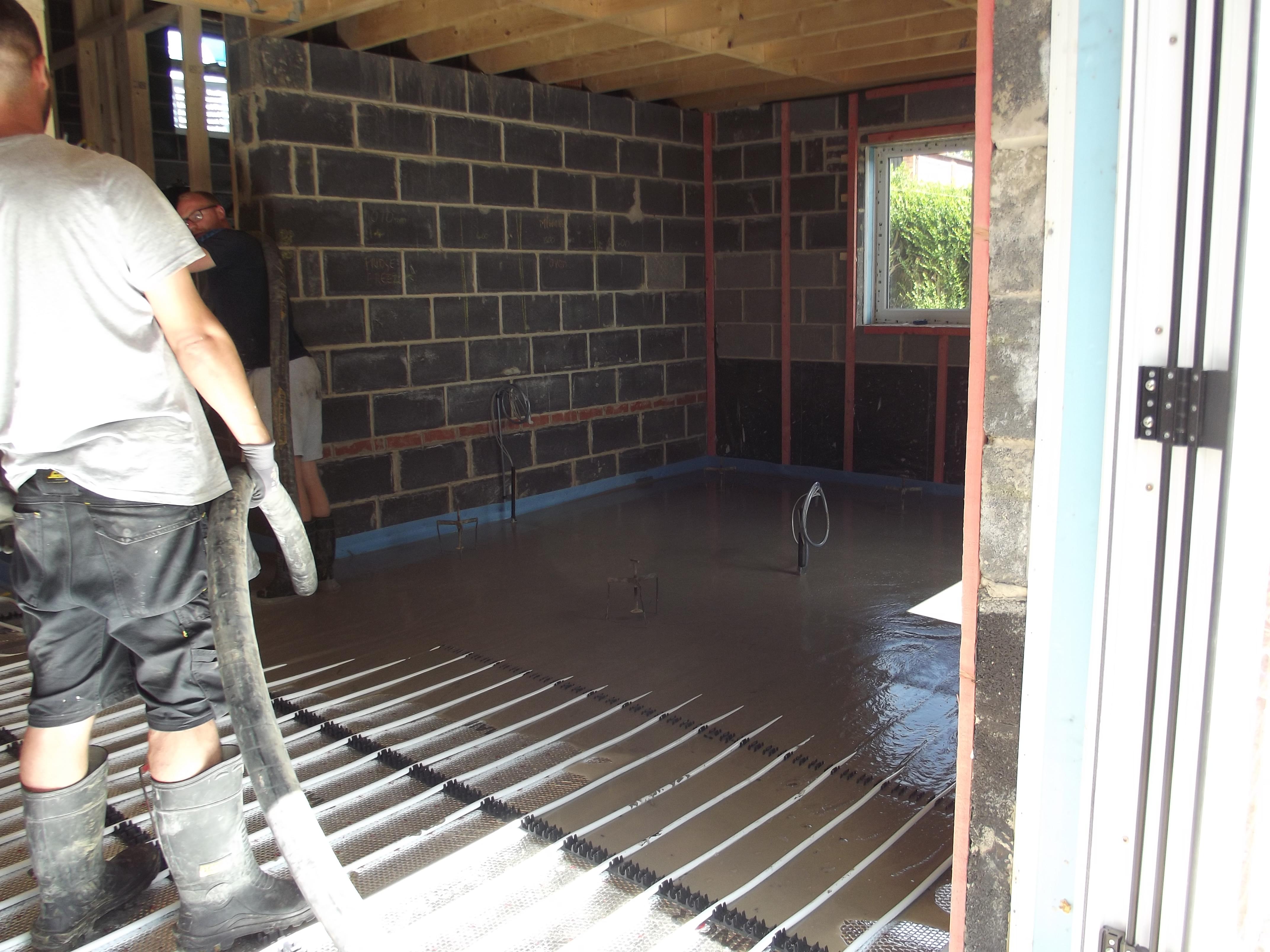

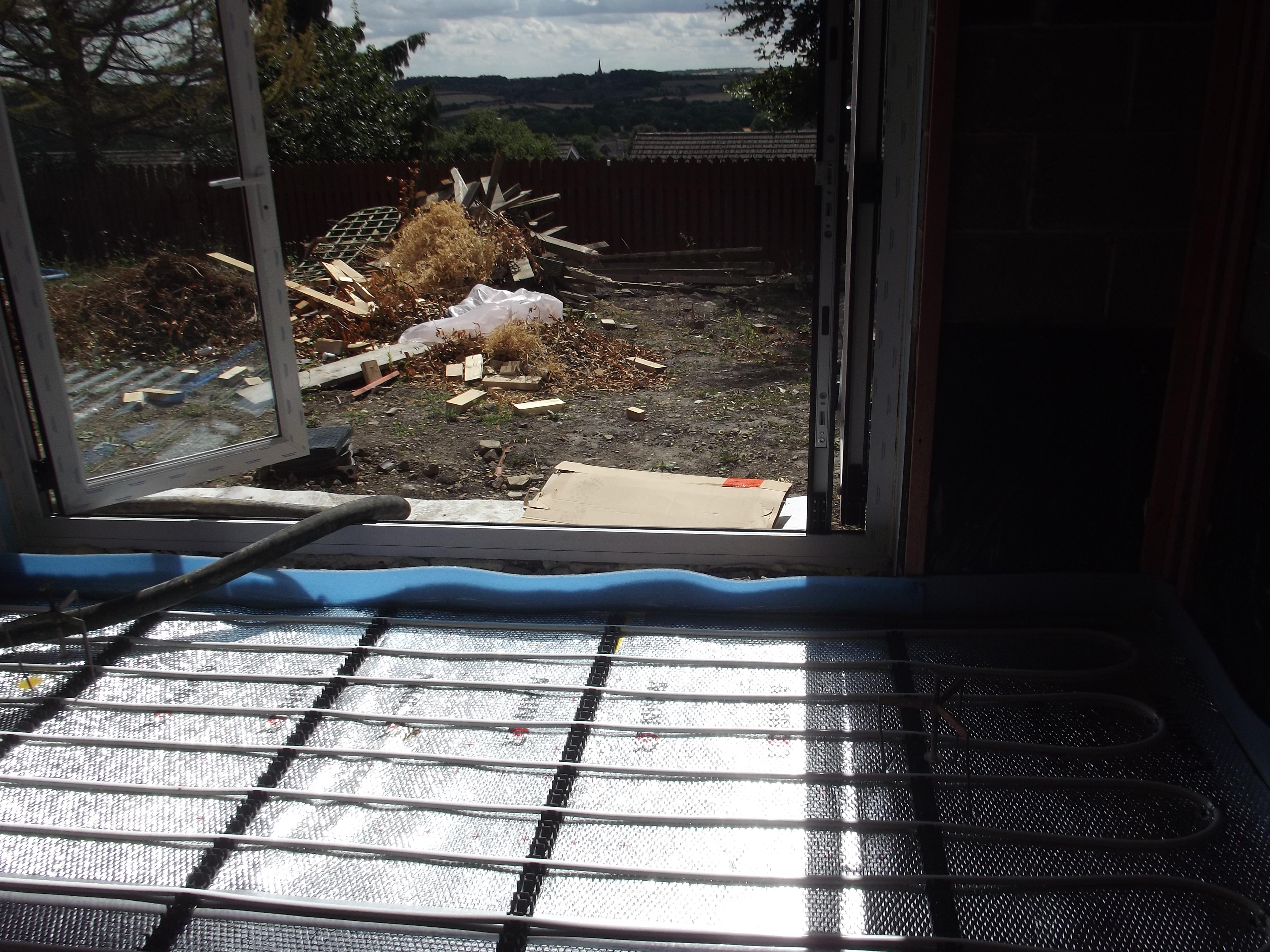

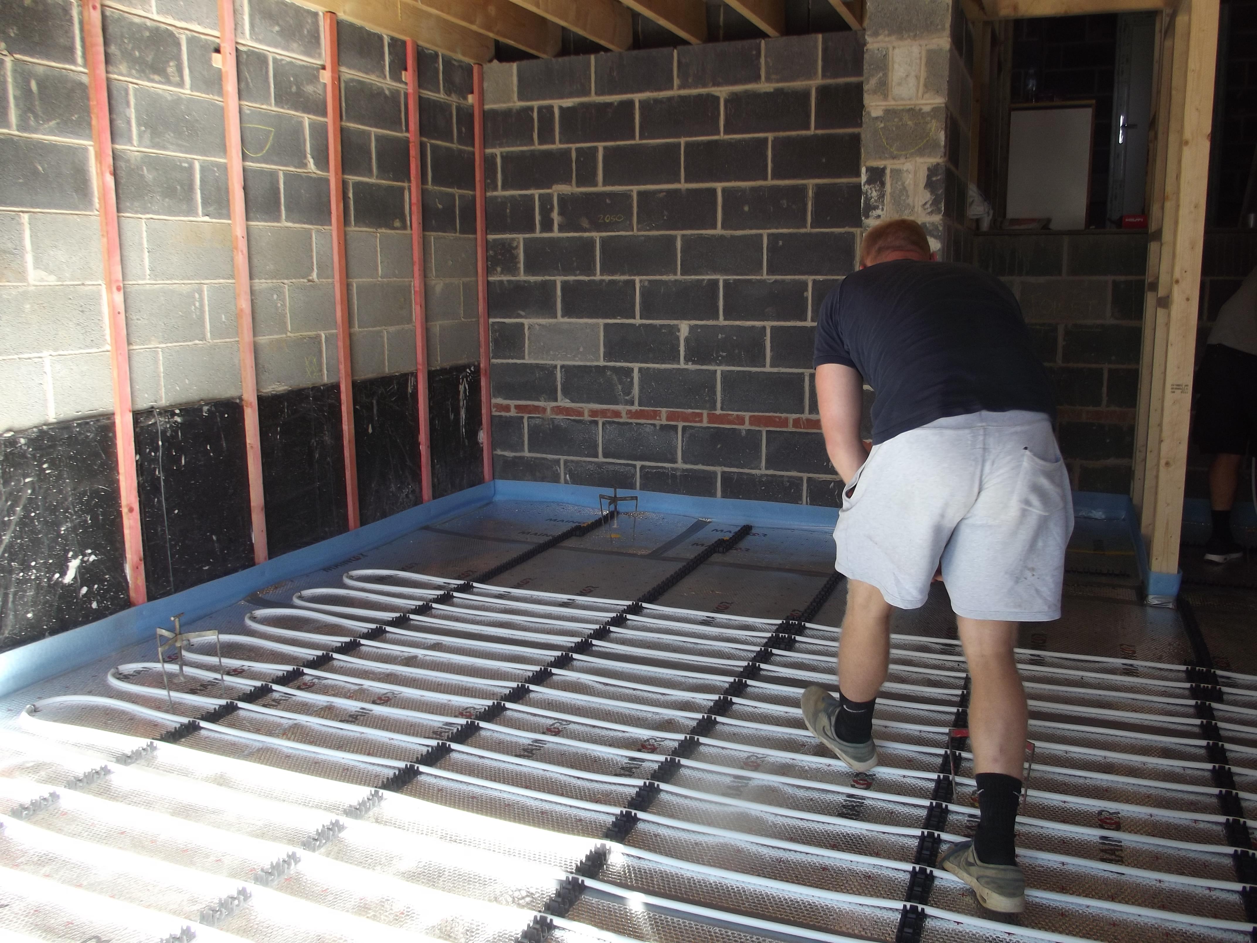

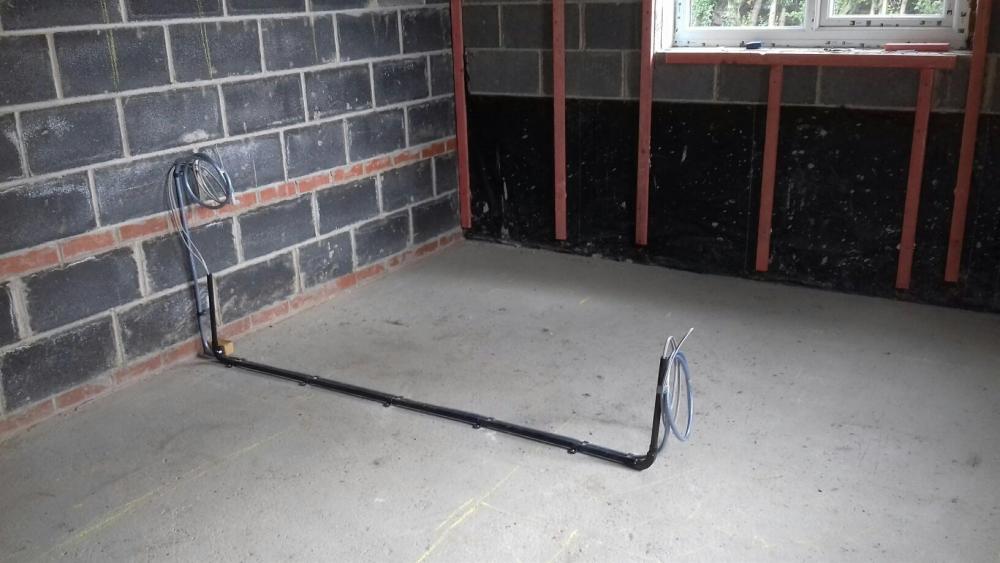

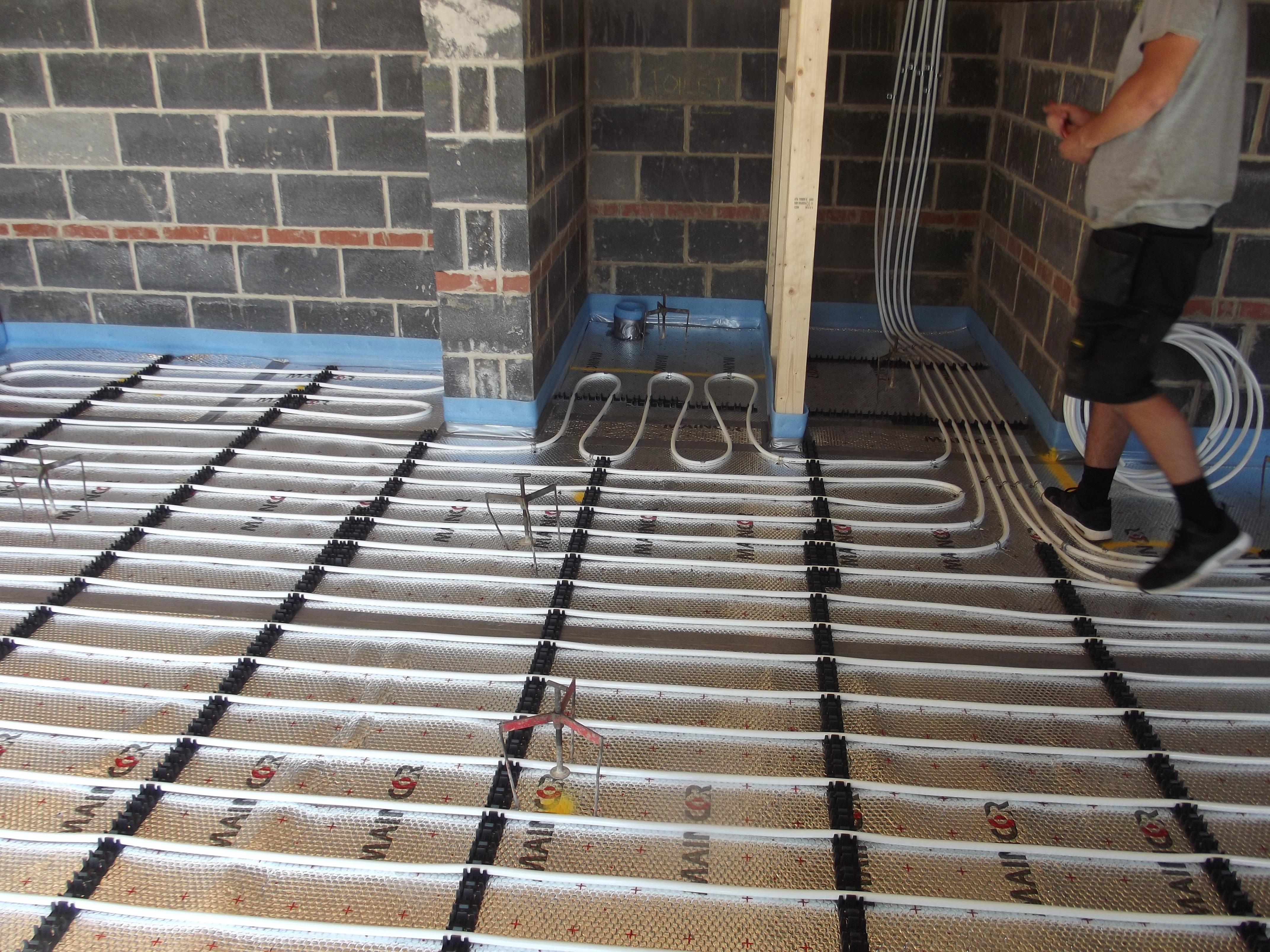

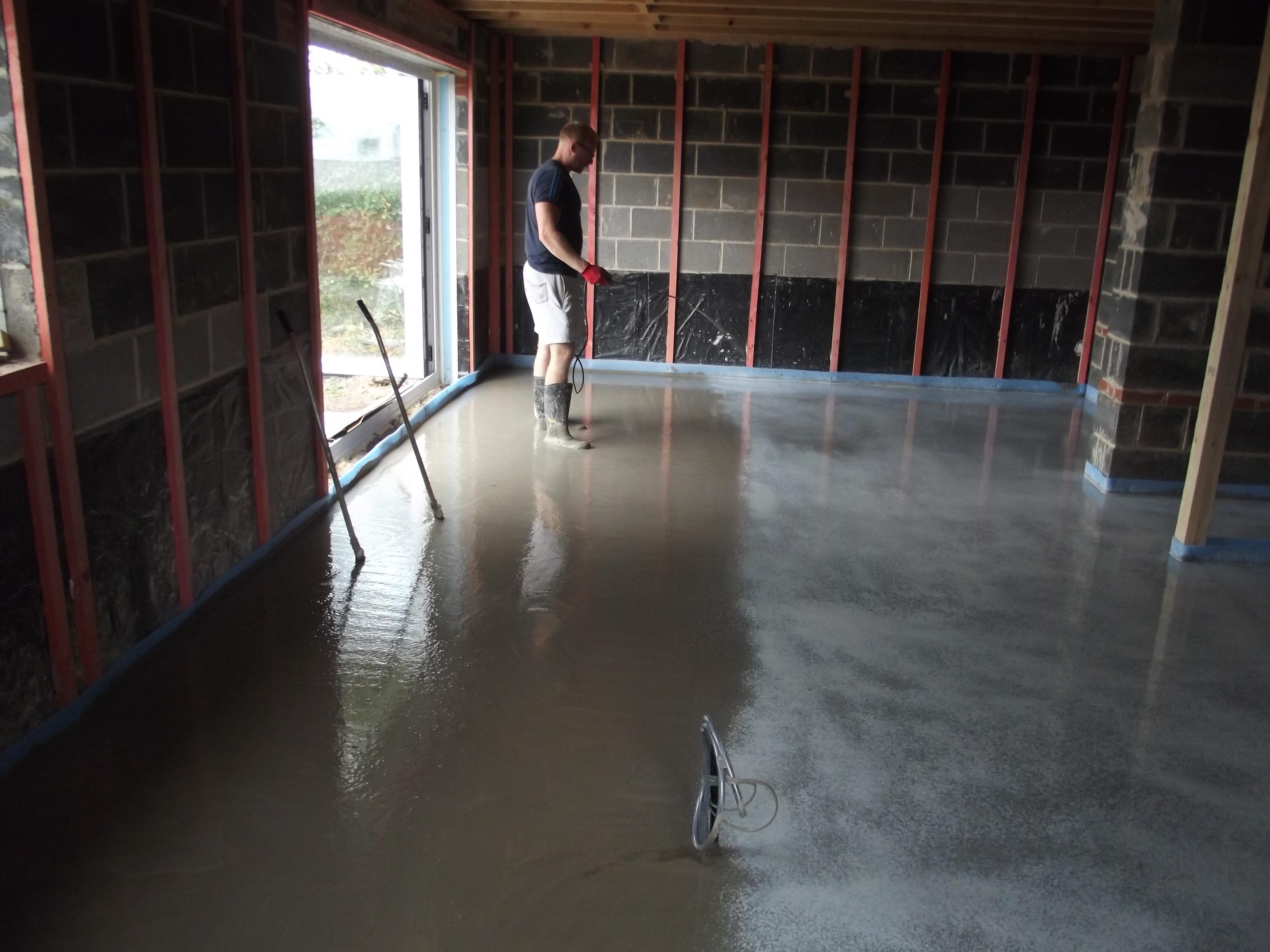

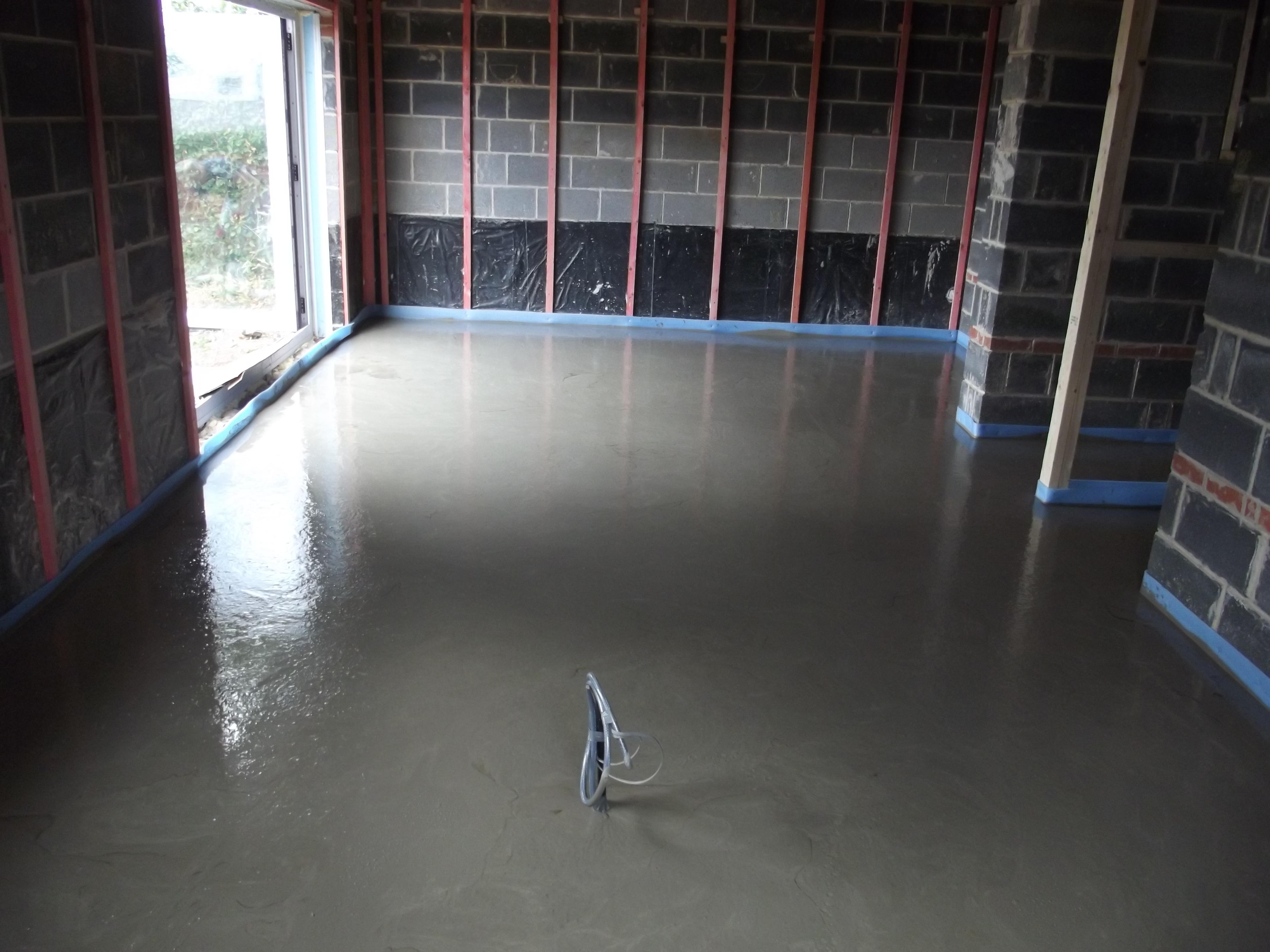

Hecateh Posted July 31, 2018 Author Share Posted July 31, 2018 Wiring in place for plinth 4mm foil insulation and pipe grippers placed UFH floor piping laid plenty of height available to threshold screed being poured All covered and levelled curing agent spayed on Highly recommended - 24 hours to be walked on and 16 (minimum) to floor laying. But that is planned for early September 2 Link to comment Share on other sites More sharing options...
