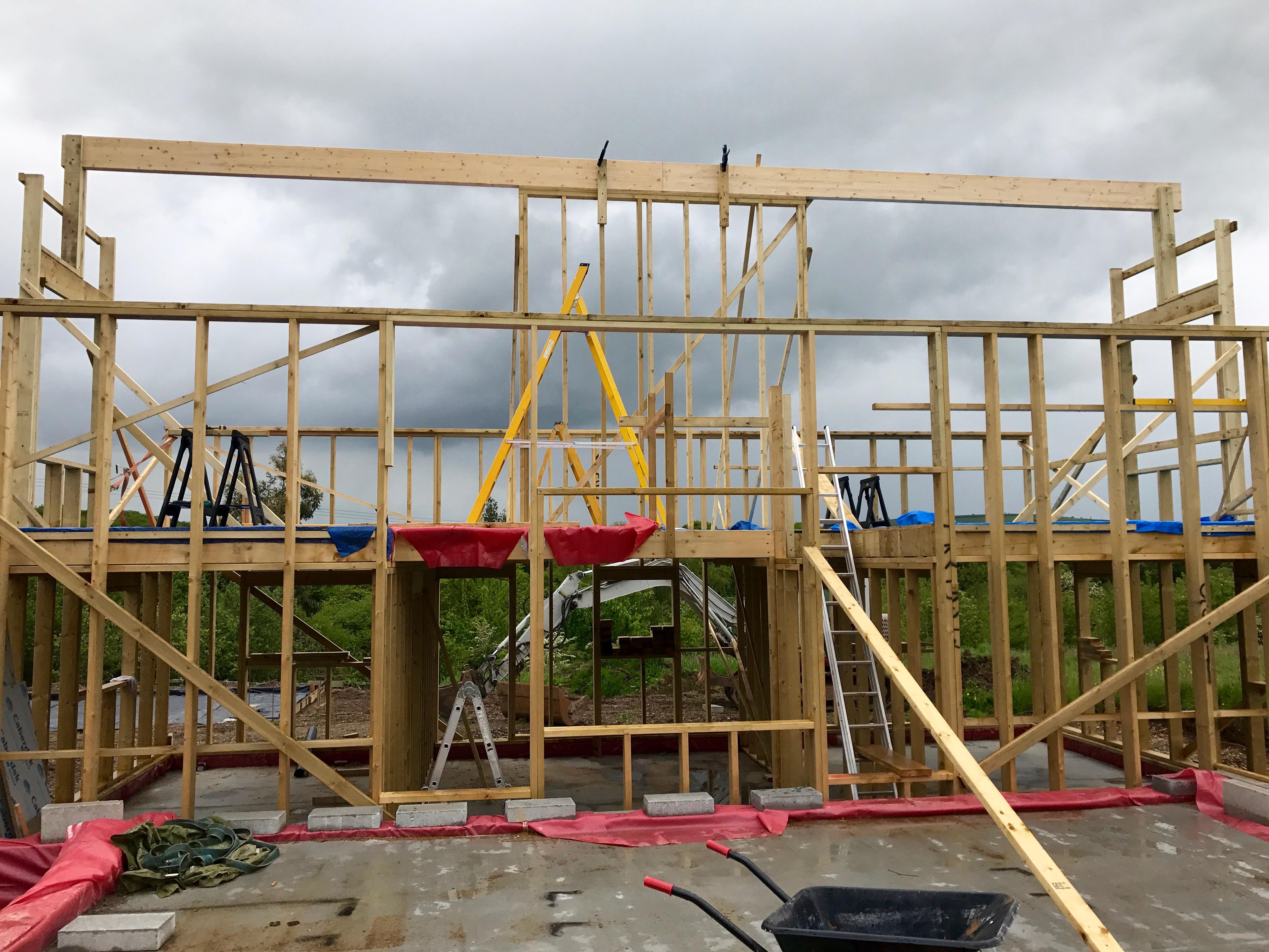

The Barriar air tight membrane continues down all the walls completely sealing the inside of the building, all joints taped, taped to windows and doors and sealed to the floor downstairs.  And a "Tony Tray" as described seals around the joist ends at the ground floor - first floor joint.
Here is the most complicated room, the big bedroom with the vaulted ceiling and mezanine floor. Only some of the battens for the service void are fitted in this picture

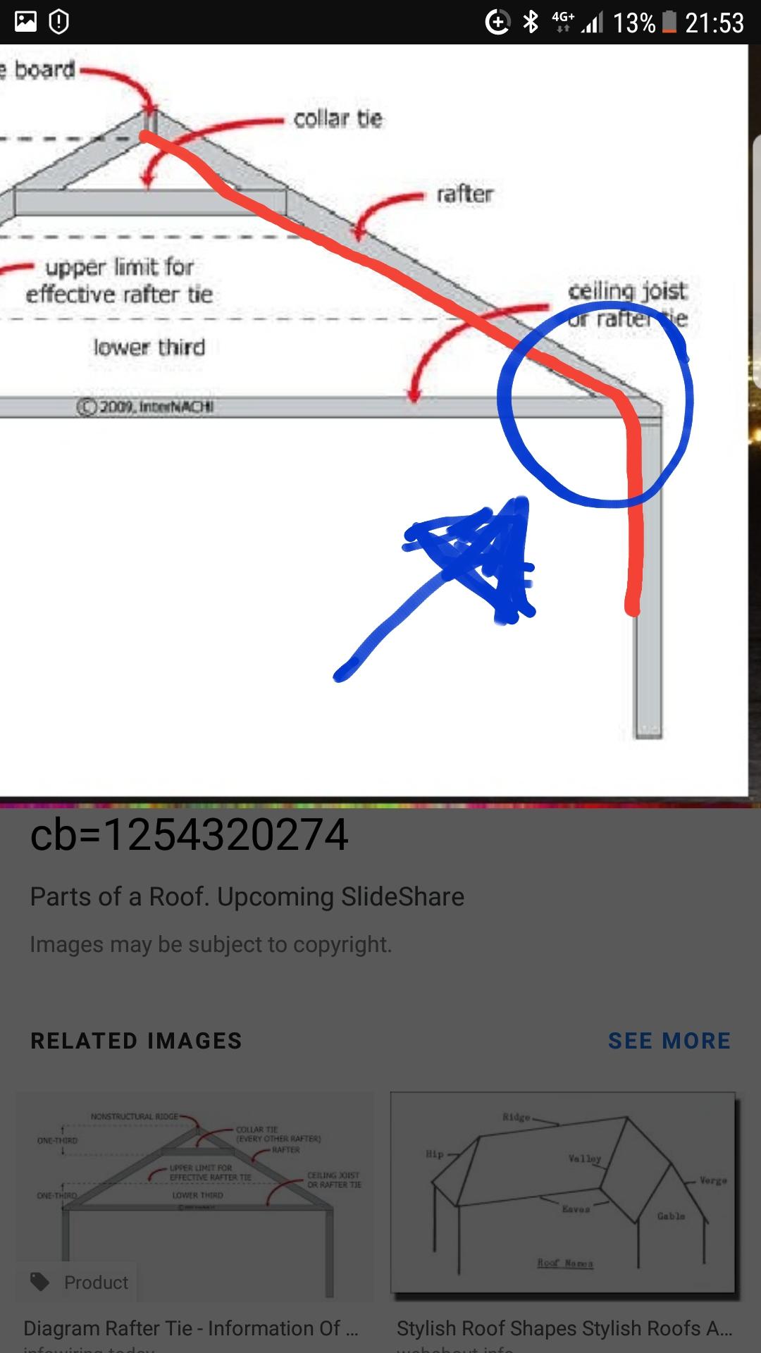

Apologies for the crap picture, I'm on my phone so not the best.
It's the continuation of the VCL (red) across the junction (blue) that is puzzling me.
I'm sure I am missing the obvious but until it's pointed out I don't have a clue what the obvious is?
Quite a lot of people (like me) making a warm roof, do so for a room in roof application, and the roof is supported on a ridge beam, so you don't have that cross piece.
If your roof is made of pre made trusses, then I am afraid you are in for a lot if fiddly cutting and taping of the air tight membrane around each individual truss end.  If it's cut and made on site then you can do the Tony Tray idea and take the membrane around the  end of the horizontal timber then folded back and build the roof above it.
Cool, this confirms then in my mind that attic trusses = a lot of fiddly detailing!
So logic would say that a cut roof would allow you to wrap the VCL around ceiling joist/rafter tie and then go about fitting the rafters from the eave up to the ridge board completing the triangular section.  Hopefully my thought process is right.
