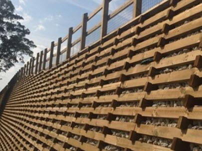

Has anyone had any experience building timber crib walls?
I'm planning one as a retaining wall for a patio area and having done some Googling the actual construction technique looks pretty simple, just a series of headers and stretchers with stone infill which would be pretty simply to home roll.
Its not particularly high, 1.7m at its highest point and the ground conditions are such that its not going to have to work too hard.
As its in the garden the BI isn't interested so I don't have to go the the trouble of structural calcs etc.

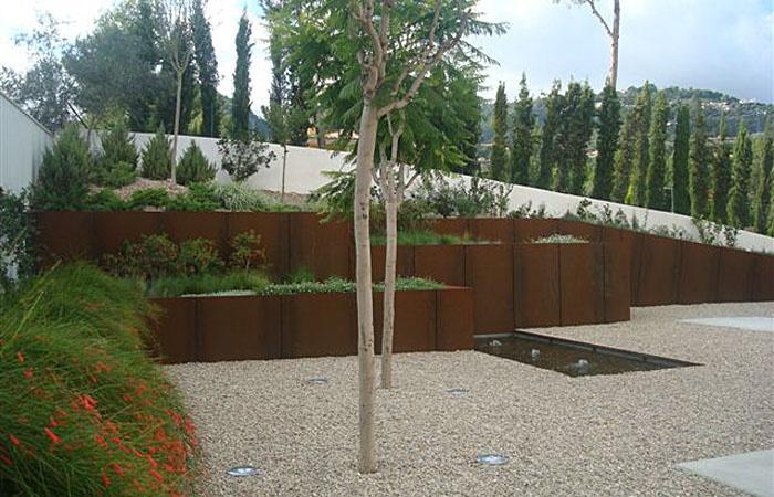

I appreciate that there are DIY stone type systems out there but its a planning condition that my retaining walls are either timber or (rusty) steel.
Something like:

Have you thought of gabion baskets with a brown coloured stone
i have seen plenty of those crib walls and life expectancy would worry me
any treated timber at the moment seem to have very poor protection

It would be simpler but the National Park won’t have it.

10 hours ago, Russell griffiths said:
If you say rusty steel can’t you use that as a cover over something more structural
so stone, brick concrete with rusty mesh in front.
That was actually plan A but the cost worked out prohibitive.

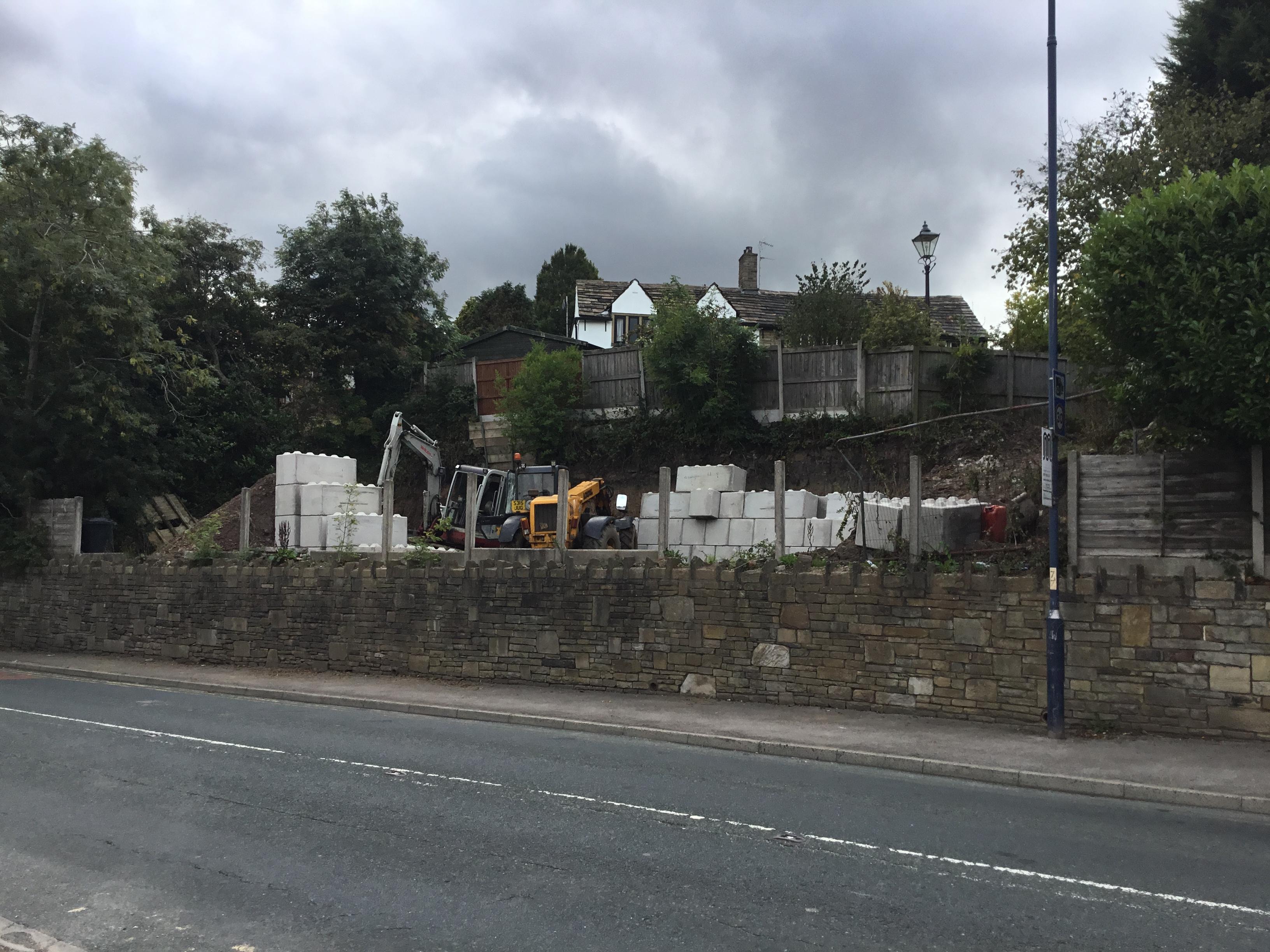

I got a eye watering £40k qoute for a 4m x 12m timber crib retaining wall.
£4K worth of huge concrete Lego blocks done the job. If anyone needs a cost effective retaining wall I recommend concrete Lego.

Sounds interesting, got a picture...

I’ll take some tomorrow.

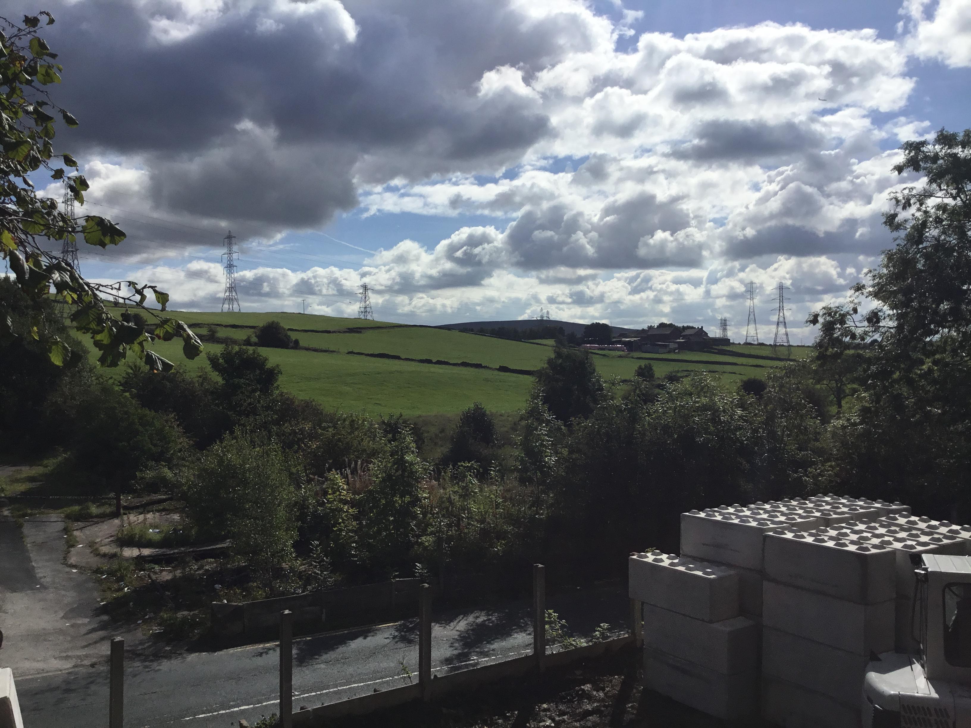

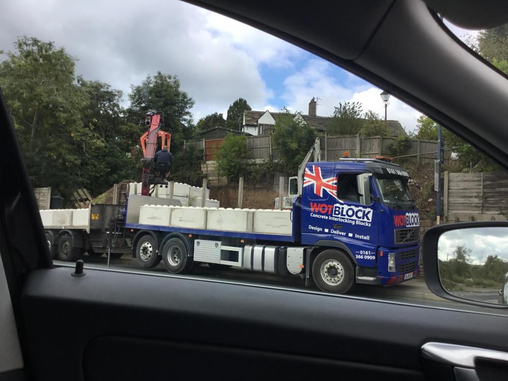

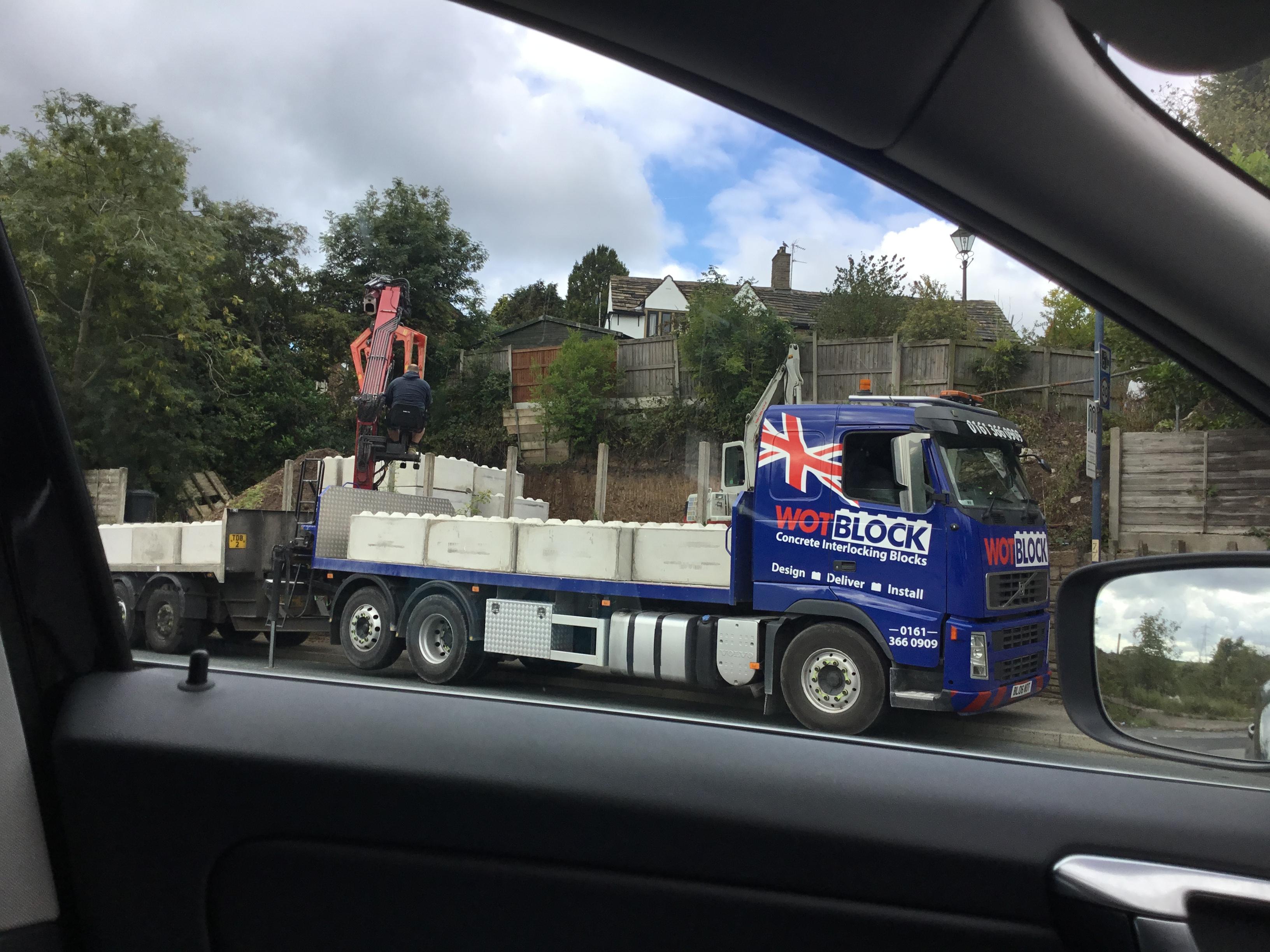

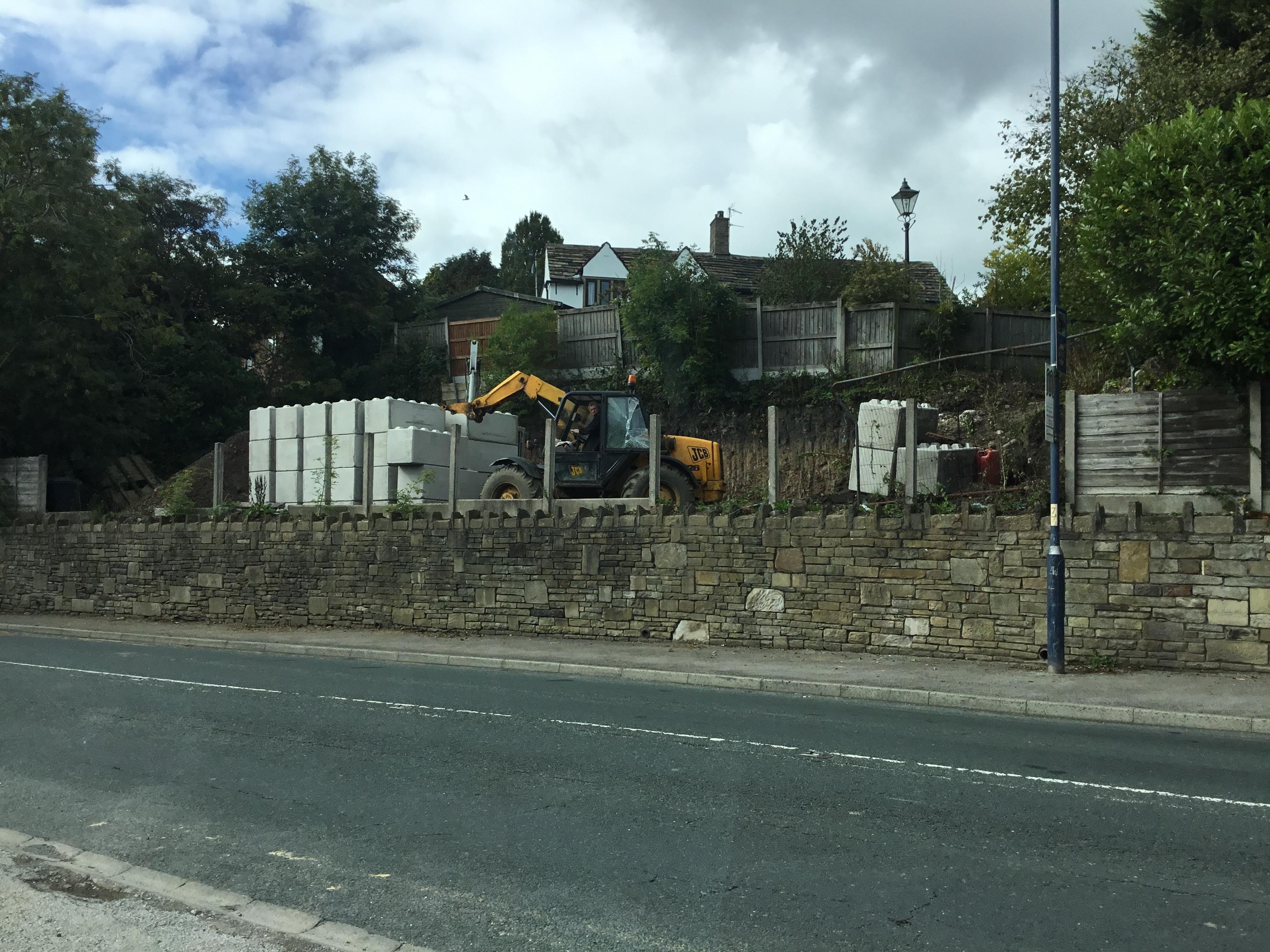

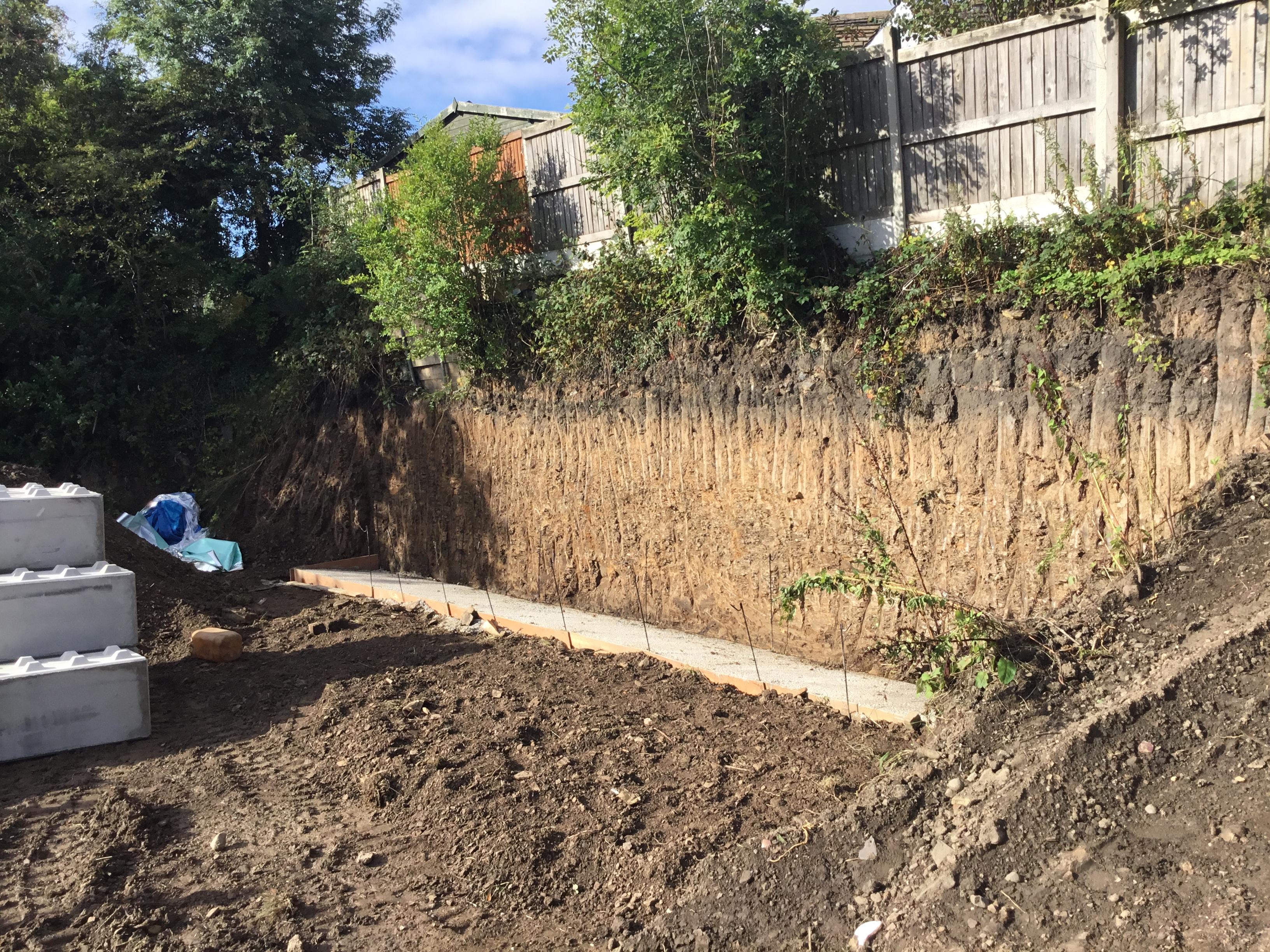

The bottom two courses are 1.5mx0.6mx0.6m blocks, laid lengthways. The upper 4 courses are a combination of 1.8mx0.6mx0.6m and 1.2mx0.6mx0.6m laid horizontally. No need for any mortar as the blocks interlock.
The foundation is 400m high at the front and 100m high at the back creating a incline. This massively reduces the required width at the base compared to a traditional gravity retaining wall.
Here are are a few pics of the bank and blocks being delivered.

Feckin Ell...that is Lego! What bloody size are the brickies down there!

Posted
Need a fair size machine to move them into place.
I’m using local farmers. Best decision I ever made. Mini digger n driver £150 a day. JCB n driver £200 a day.
They’re bloody good too. Some of the manouvers Adam pulls off in that mini digger are death defying.
