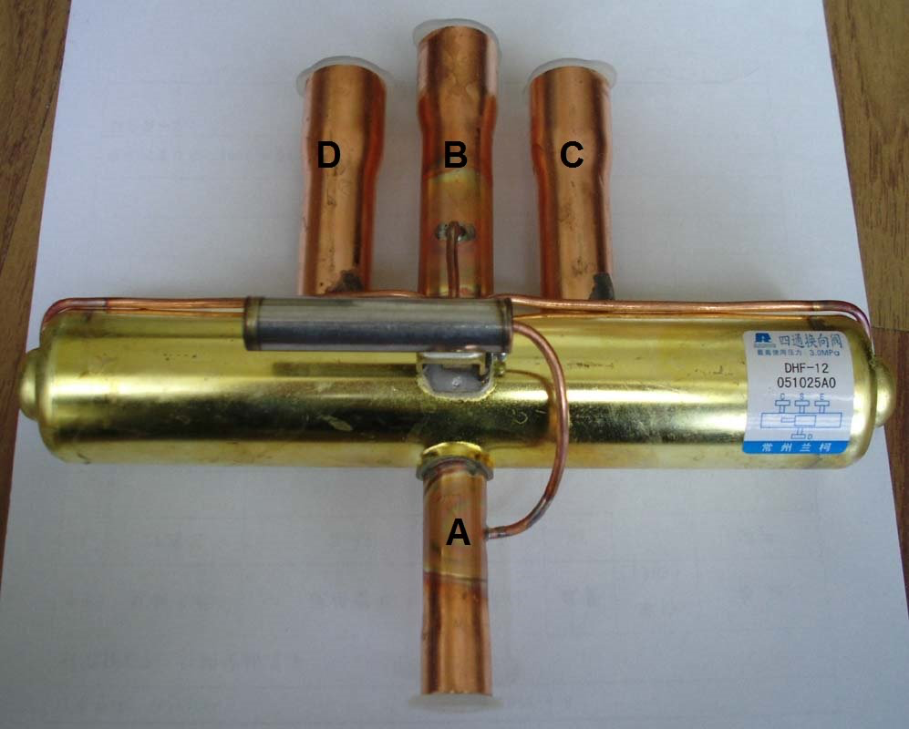

Dreadnaught Posted July 24, 2018 Posted July 24, 2018 Beginner's question. How does a heat pump reverse to both heat and cool? Is the following correct? Simply put, a split heat pump comprises: outside: a heat-exchanger coil and a fan, which is connected to… gas piping, with a compressor, which is connected to… Inside: if it is air-to-air, another heat-exchanger coil and fan if it is air-to-water, a plate heat exchanger which is connected to liquid piping and a one-way valve, which is connected to (1) above to close-the-loop (Circulating from outside to inside is not water but refrigerant.) From Wikipedia: So far so good. For cooling it makes sense. But how does the system go in reverse to heat the inside? It would seem to me you would need to physically swap the circuit around. I am sure this is just a problem of over simplification but is there someone who can explain it in simple terms?
Jeremy Harris Posted July 24, 2018 Posted July 24, 2018 All heating ASHPs reverse, they have a four port reversing valve that switches the relative positions of the condenser and the evaporator. The reason they have to have this is to defrost the evaporator. By switching the four port reversing valve the heat pump can draw heat from the water side and use it to warm up what was the evaporator (but is now the condenser) on the air side. This melts any ice build up, at the cost of sucking some heat energy out of the house whilst it's doing it. This is why a badly set up ASHP can have a really bad COP if it ends up defrosting fairly regularly, as defrosting not only means it's not heating for the duration of the defrost cycle but it's also extracting heat from the house, which then needs to be put back the next time the unit switches to heating mode. 1
Dreadnaught Posted July 24, 2018 Author Posted July 24, 2018 Thanks @JSHarris. Four-port reversing valve the magic words that makes it all make sense. Does anyone know of the relative efficiency in each of the two directions, heating and cooling. I have read somewhere that heat pumps are optimised for one direction, either heating or cooling, and quite majorly so.
Dreadnaught Posted July 24, 2018 Author Posted July 24, 2018 @jack brilliant link. Thank you. What a handsome object:

MrMagic Posted July 24, 2018 Posted July 24, 2018 On 24/07/2018 at 10:30, Dreadnaught said: Thanks @JSHarris. Four-port reversing valve the magic words that makes it all make sense. Does anyone know of the relative efficiency in each of the two directions, heating and cooling. I have read somewhere that heat pumps are optimised for one direction, either heating or cooling, and quite majorly so. Expand For A2A heat pumps I've certainly noticed that there has always been a bit of a discrepancy between the heating and cooling power & efficiency - annoyingly HP manufactures seem to like to measure heating and cooling performance differently to make it even harder to compare. I'm sure someone smarter than me can explain. e.g. https://www.orionairsales.co.uk/daikin-air-conditioning-ftx20kv-wall-mounted-inverter-heat-pump-20kw7000btu-a-240v50hz-6533-p.asp Cooling capacity (Min./Nom./Max): 1.3 / 2.0 / 2.6 kW Heating capacity (Min./Nom./Max): 1.3 / 2.5 / 3.5 kW Consumption power - cooling (Min./Nom./Max): 0.31 / 0.503 / 0.72 kW Consumption power - heating (Min./Nom./Max): 0.25 / 0.524 / 0.95 kW ...so this system has up to 1Kw of additional capacity when in heating mode (max). Using my very basic maths to get a rough CoP - Cooling CoP (Nominal) - 2 / 0.503 = 3.97 Heating CoP (Nominal) - 2.5 / 0.524 = 4.77
SteamyTea Posted July 24, 2018 Posted July 24, 2018 Te reason that there is a difference in name place capacity is because of the relative differences in temperatures and entropy. Probably find that if you plot on the Kelvin scale those difference diminish and the only thing affecting it is the entropy caused by humidity.
Dreadnaught Posted July 24, 2018 Author Posted July 24, 2018 So @SteamyTea, if understand you correctly, you are suggesting that the difference in CoP in @MrMagic's example are to be explained by physical factors (humidity), not engineering. That's really interesting. That would suggest that my statement "that heat pumps are optimised for one direction, either heating or cooling, and quite majorly so" is actually not true. Did I understand you correctly?
SteamyTea Posted July 24, 2018 Posted July 24, 2018 (edited) Yes, basically true that a heat pump just cools one side and heats another. If the temperature differences, within the working range of the refrigerant gas, is equal, then there should be no difference. In practice there may well be a difference, but that could be caused by the plumbing side i.e. not capable of pumping enough because of UFH pipe restrictions, surface areas not large enough for the temperature differences, the fact that cool air falls to the floor, warm air rises which will effect efficiency. That sort of thing. Edited July 24, 2018 by SteamyTea
Jeremy Harris Posted July 25, 2018 Posted July 25, 2018 That's borne out in the spec for the air-to-air heat pump that's built in to our MVHR. The heating capacity is about 1.5 kW, the cooling capacity is just a bit over 1 kW, but the working conditions for the input air temperature and humidity are markedly different, as is the Δt
