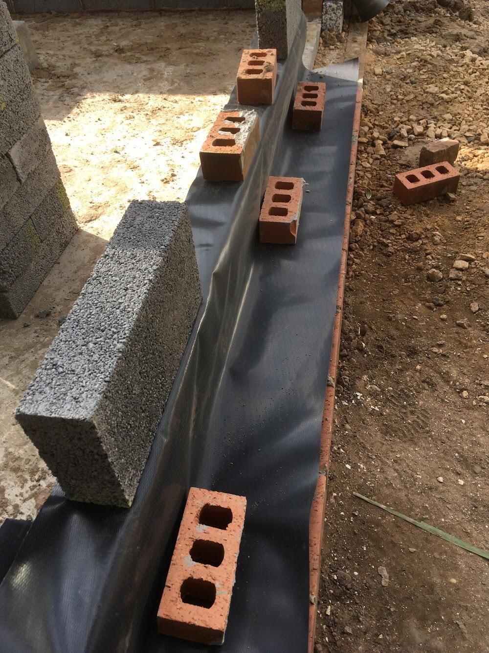

PeterW Posted July 21, 2018 Share Posted July 21, 2018 I did just this fill however : - below ground is 100mm EPS with a 25-45mm 6:1 sand cement fill in the remaining cavity. - there is a second DPM cavity tray up the inside of the first block lapped down and across to the outer DPM - all cavities were cleaned (and hoovered....) before the closers installed and beads blown in. 1 Link to comment Share on other sites More sharing options...
epsilonGreedy Posted July 21, 2018 Author Share Posted July 21, 2018 24 minutes ago, Declan52 said: My cavity insulation went approx 300mm below my finished floor so there would be no cold spots. As you are going for a brick finish you could build in some weep vents level where you bring the concrete in the cavity up to. Then if any moisture gets that far it can seep out. I did wonder if water arriving at the bottom of a cavity would seep through a lean mix cement fill. Yes proper weep vents are to be included just not sure at the moment how to interpret NHBC advice on how high they should be. Link to comment Share on other sites More sharing options...
epsilonGreedy Posted July 21, 2018 Author Share Posted July 21, 2018 4 minutes ago, PeterW said: - there is a second DPM cavity tray up the inside of the first block lapped down and across to the outer DPM - all cavities were cleaned (and hoovered....) before the closers installed and beads blown in. I am not sure I have enough openings to allow such a cavity tray clean up. My building control diagram depicts a similar upper dpm tray as shown in your photo though this could promote creation of a moisture bridge, I am sitting on the fence re. this choice.. Link to comment Share on other sites More sharing options...

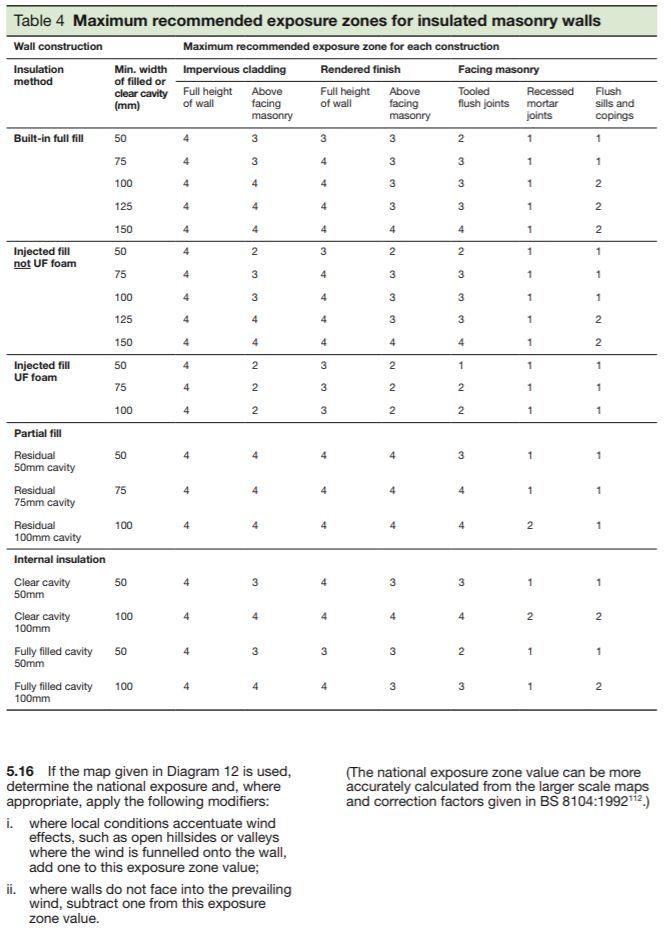

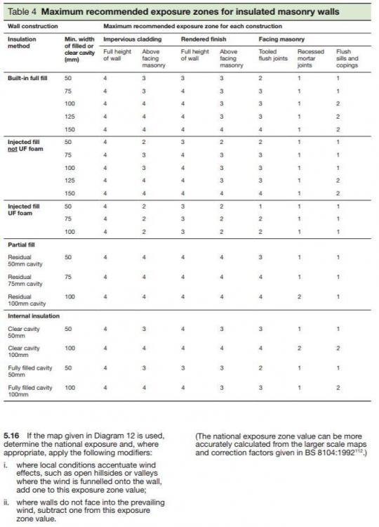

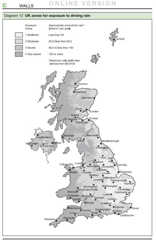

epsilonGreedy Posted July 21, 2018 Author Share Posted July 21, 2018 8 hours ago, PeterW said: Unlikely - how do you plan to get moisture into the cavity other then when it’s being built...?? It is an unavoidable consequence of wind driven rain seeping through the facing brick skin apparently. Link to comment Share on other sites More sharing options...
PeterW Posted July 21, 2018 Share Posted July 21, 2018 I’ve never seen it in nearly 30 years. To soak through 4” of brick at any rate to cause water in the cavity would need some serious hydraulic pressure. If it was an issue then full fill cavity insulation wouldn’t be allowed. Link to comment Share on other sites More sharing options...
Brickie Posted July 22, 2018 Share Posted July 22, 2018 16 hours ago, epsilonGreedy said: am not sure I have enough openings to allow such a cavity tray clean up. That’s what coring holes are for. Leave out every 4th brick on Dpc & loop some hessian from one coring hole to the next. Every morning,you simply turn the hessian loop,bringing any mortar droppings from inside the cavity to the outside. Anywhere you have a door opening can be cleaned with a batten,rodding any droppings to your coring holes but you need to take care not to get too vigorous & make a tear in the tray. 1 Link to comment Share on other sites More sharing options...
epsilonGreedy Posted July 22, 2018 Author Share Posted July 22, 2018 (edited) 10 hours ago, PeterW said: I’ve never seen it in nearly 30 years. Well that is very odd since it is a universally recognized factor in any debate over full fill cavity insulation, why do building regulations recognize rainfall zones when full fill cavity insulation is being discussed. Anyhow mortar joints are the weakness. Edited July 22, 2018 by epsilonGreedy Link to comment Share on other sites More sharing options...
PeterW Posted July 22, 2018 Share Posted July 22, 2018 2 hours ago, epsilonGreedy said: Well that is very odd since it is a universally recognized factor in any debate over full fill cavity insulation, why do building regulations recognize rainfall zones when full fill cavity insulation is being discussed. Anyhow mortar joints are the weakness. Unless you’re planning on moving your entire house to a severe rated zone, why are you even bothering to debate this ..? The building industry has been full filling with bead for over 25 years and I’ve not heard of an issue - it’s also very common in Ireland (as @Declan52 was referring) and they get a lot more rain than the rest of the UK. If you’ve already submitted - and have had accepted - your BRegs plans then what’s the issue building to these ..?? Be careful making amendments as you may be made to change the work at a later date Link to comment Share on other sites More sharing options...
Declan52 Posted July 22, 2018 Share Posted July 22, 2018 I think your worrying about nothing. Unless your house can get hit by a tidal wave the volume of water that will fully penetrate bricks or rendered blocks is minute. As @PeterW says this type of cavity fill had been used on refurbs here for ages but only really took off for new builds on the last 10-15 years. That was primarily due to poor workmanship from brickies where large gaps would have got left in behind the cavity boards we use here. No site in 20 years that I have been on has used the Rockwool type batts that are used in the rest of the UK. The beads aren't loose like they used to be. Once blown in at high pressure and the glue sets they form a solid block that no moisture can penetrate. Any moisture will fall down against the bricks and evaporate out your weep vents. If your brickies can't get the motar to stick on the bricks to form good perps then you have got chancers with tools not brickies. Link to comment Share on other sites More sharing options...
epsilonGreedy Posted July 23, 2018 Author Share Posted July 23, 2018 (edited) 19 hours ago, PeterW said: Unless you’re planning on moving your entire house to a severe rated zone, why are you even bothering to debate this ..? A common complaint in this forum is about mainstream building subcontractors making mistakes and taking shortcuts. I am flummoxed as why I should be castigated for seeking clarification on the finer point re. where cavity fill insulation should stop. This is obviously a general industry concern and is a subject of evolving official standards. 10 - 20 years ago it was accepted that cavity batts should stop at DPC, now today in pursuit of better insulation the experts have decided to trade positioning insulation lower in the cavity for lower heat loss. Edited July 23, 2018 by epsilonGreedy Link to comment Share on other sites More sharing options...
