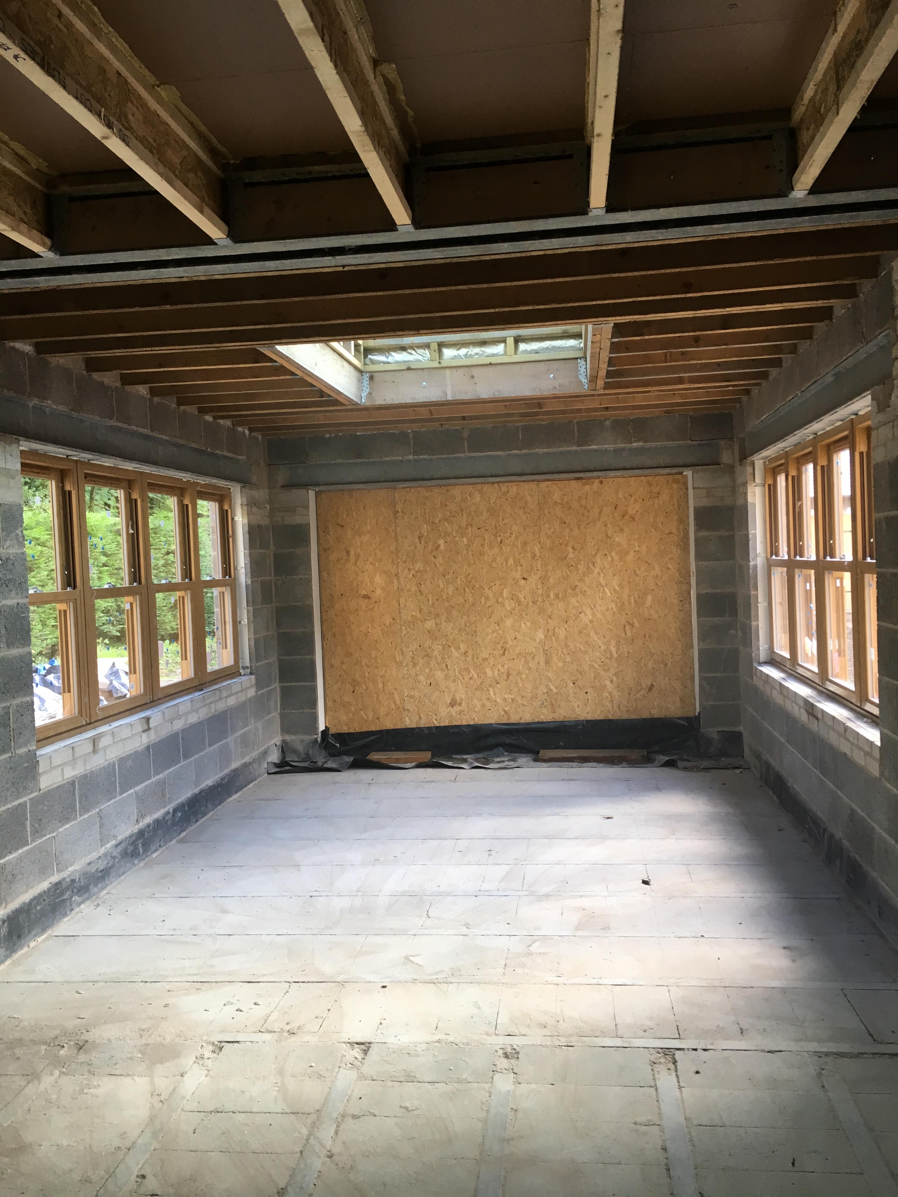

PeterW Posted July 12, 2018 Posted July 12, 2018 44 minutes ago, Onoff said: I'd honestly rather use marine ply than OSB on say the side of my dormer when I redo that. I know I'll be a lone voice on this! Depends what the top coating is - OSB is fine as a backing but not as a final surface, and under lead it can show pattern. GRP and I would go OSB as it’s sealed in and the surface mechanically bonds to the sub structure too
nod Posted July 12, 2018 Posted July 12, 2018 2 hours ago, PeterW said: OSB would be better I’ve had cheap osb on the back of mine for twelve months Still ok
SteamyTea Posted July 12, 2018 Posted July 12, 2018 Pity I did not take a picture earlier today. I made a cheap ply planter and painted it with cheap fence paint. After 4 years filled with dirt and plants, the ply was fine, the screws had failed due to corrosion.
