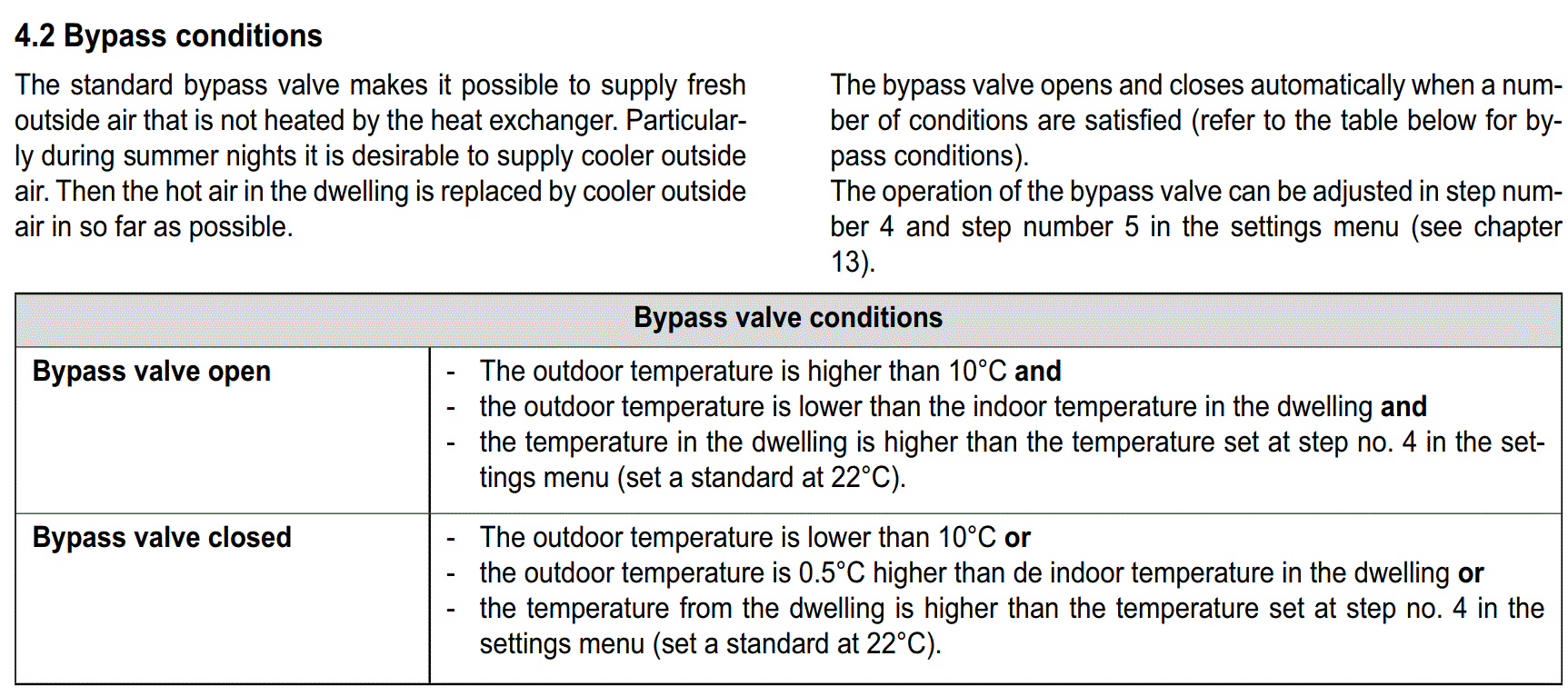

mike2016 Posted July 12, 2018 Author Posted July 12, 2018 Just a few things around MVHR I picked up from this thread so far I want to understand better. I know the flow is too low to provide any meaningful cooling. In summer if it's 28 outside and 21 inside, doesn't the cooler exhaust air cool down in in coming warm fresh air? Sort the opposite of what it normally does? You're still going to get some uptick of heat unless you shut it down completely though? Summer bypass just draws in air at 28 degrees doesn't it?! What's the use of that except at night? An aircon unit in the main living area will cool down that space but MVHR will start throwing that cooling outside (albeit at a slow pace) and not distribute it around the house, would that be accurate? Is there such a thing as a recirculate option with MVHR units like you have in a car for when you drive through smoke? The advantage is you get air circulation even when someone's BBQ'ing outside but also if you have one room actively cooled, you get the benefit throughout the whole house (eventually!). 1
Jeremy Harris Posted July 12, 2018 Posted July 12, 2018 12 minutes ago, mike2016 said: Just a few things around MVHR I picked up from this thread so far I want to understand better. I know the flow is too low to provide any meaningful cooling. In summer if it's 28 outside and 21 inside, doesn't the cooler exhaust air cool down in in coming warm fresh air? Sort the opposite of what it normally does? Yes, initially, but the house will start to warm up and so there will come a point where this effect isn't worth having. In general, our MVHR is on 100% bypass by mid-morning at the moment, which is the point where it senses no benefit from having the heat exchanger in circuit. 12 minutes ago, mike2016 said: You're still going to get some uptick of heat unless you shut it down completely though? Yes. 12 minutes ago, mike2016 said: Summer bypass just draws in air at 28 degrees doesn't it?! What's the use of that except at night? Spot on - better to shut the MVHR off once it goes to 100% bypass during the day, unless you have an active MVHR which cools the fresh air. 12 minutes ago, mike2016 said: An aircon unit in the main living area will cool down that space but MVHR will start throwing that cooling outside (albeit at a slow pace) and not distribute it around the house, would that be accurate? Yes, the MVHR may well do as you say. There's some merit in never letting the house get warm inside, so that you can use the limited airflow from cooled air provided to (or from) a duct cooler in the MVHR to maintain a comfortable temperature (I'm ironing out the details of doing just this for our system right now). 12 minutes ago, mike2016 said: Is there such a thing as a recirculate option with MVHR units like you have in a car for when you drive through smoke? The advantage is you get air circulation even when someone's BBQ'ing outside but also if you have one room actively cooled, you get the benefit throughout the whole house (eventually!). Not as such, but turning the MVHR off has much the same effect in practice, and is what we do if someone lights a bonfire. You can live in the house quite comfortably with the MVHR off and the doors and windows closed for a few hours - I watch the CO2 and it rarely gets above about 800 ppm and that's considered an OK figure. 1
jack Posted July 12, 2018 Posted July 12, 2018 1 hour ago, mike2016 said: In summer if it's 28 outside and 21 inside, doesn't the cooler exhaust air cool down in in coming warm fresh air? Sort the opposite of what it normally does? Yes, MVHR acts to maintain any temperature difference between inside and outside. It doesn't matter whether it's hotter inside or out. 1 hour ago, mike2016 said: You're still going to get some uptick of heat unless you shut it down completely though? Heat will increase, in the same way that a house will be cooled slightly by MVHR in winter. The difference is that in winter, the sources of heat in the house (central heating, people, cooling, showers, etc) tend to counteract this effect. In summer, there's no source of incidental cooling, and it's unusal in the UK to have active cooling. 1 hour ago, mike2016 said: Summer bypass just draws in air at 28 degrees doesn't it?! What's the use of that except at night? Assuming an automatic system, summer bypass only operates when the outside air temperature is lower than the inside air temperature, as tends to happen at night as it cools down outside. Summer bypass won't turn on if it's 28 outside and 21 inside. If it does, a setting is wrong or something is broken!

Dreadnaught Posted July 12, 2018 Posted July 12, 2018 (edited) 12 minutes ago, jack said: Summer bypass won't turn on if it's 28 outside and 21 inside. If it does, a setting is wrong or something is broken! In reading the specification of some MVHR units, some seem to trigger the summer bypass solely on the basis of an external temperature. Some seem to be based on a algorithm linked to internal and external temps. I wonder if any take notice of humidity or other characteristics. (And, as mentioned before, some don't have a summer bypass at all. And instead say they have a "simulated" one, which as far as I can tell means simply turning off the extract fan). Edited July 12, 2018 by Dreadnaught

Jeremy Harris Posted July 12, 2018 Posted July 12, 2018 1 hour ago, jack said: Assuming an automatic system, summer bypass only operates when the outside air temperature is lower than the inside air temperature, as tends to happen at night as it cools down outside. Summer bypass won't turn on if it's 28 outside and 21 inside. If it does, a setting is wrong or something is broken! Or unless the unit has active cooling, when it goes to 100% bypass and turns on the air-to-air heat pump...

Dreadnaught Posted July 12, 2018 Posted July 12, 2018 27 minutes ago, jack said: Are there really summer bypass (not simulated) systems that operate solely based on outdoor temperature? Do they assume that on very hot days your house is already hotter than it is outside? If so, that's a bizarre assumption. My observation was from this quote "Usually activates based on automatic external temperature point e.g. 21°" from this document from Zehnder, https://www.zehnder.co.uk/download/102348/en_uk-63373.pdf. They might have been simplifying.
jack Posted July 12, 2018 Posted July 12, 2018 3 minutes ago, Dreadnaught said: My observation was from this quote "Usually activates based on automatic external temperature point e.g. 21°" from this document from Zehnder, https://www.zehnder.co.uk/download/102348/en_uk-63373.pdf. They might have been simplifying. Interesting document, thanks. I guess they could be simplifying, but it does seem to be comparing an outside temp (only) approach with an inside+outside temps function.
