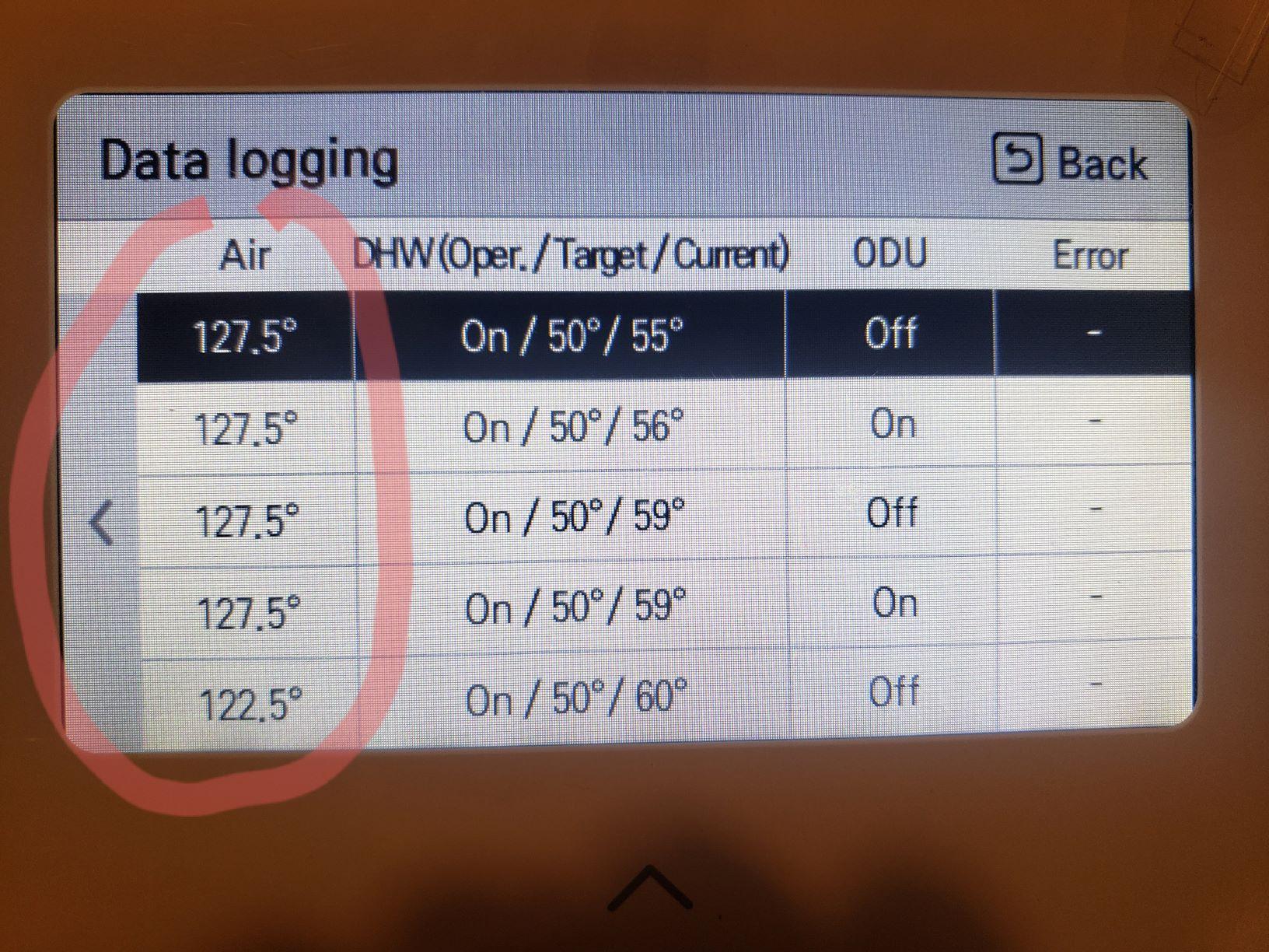

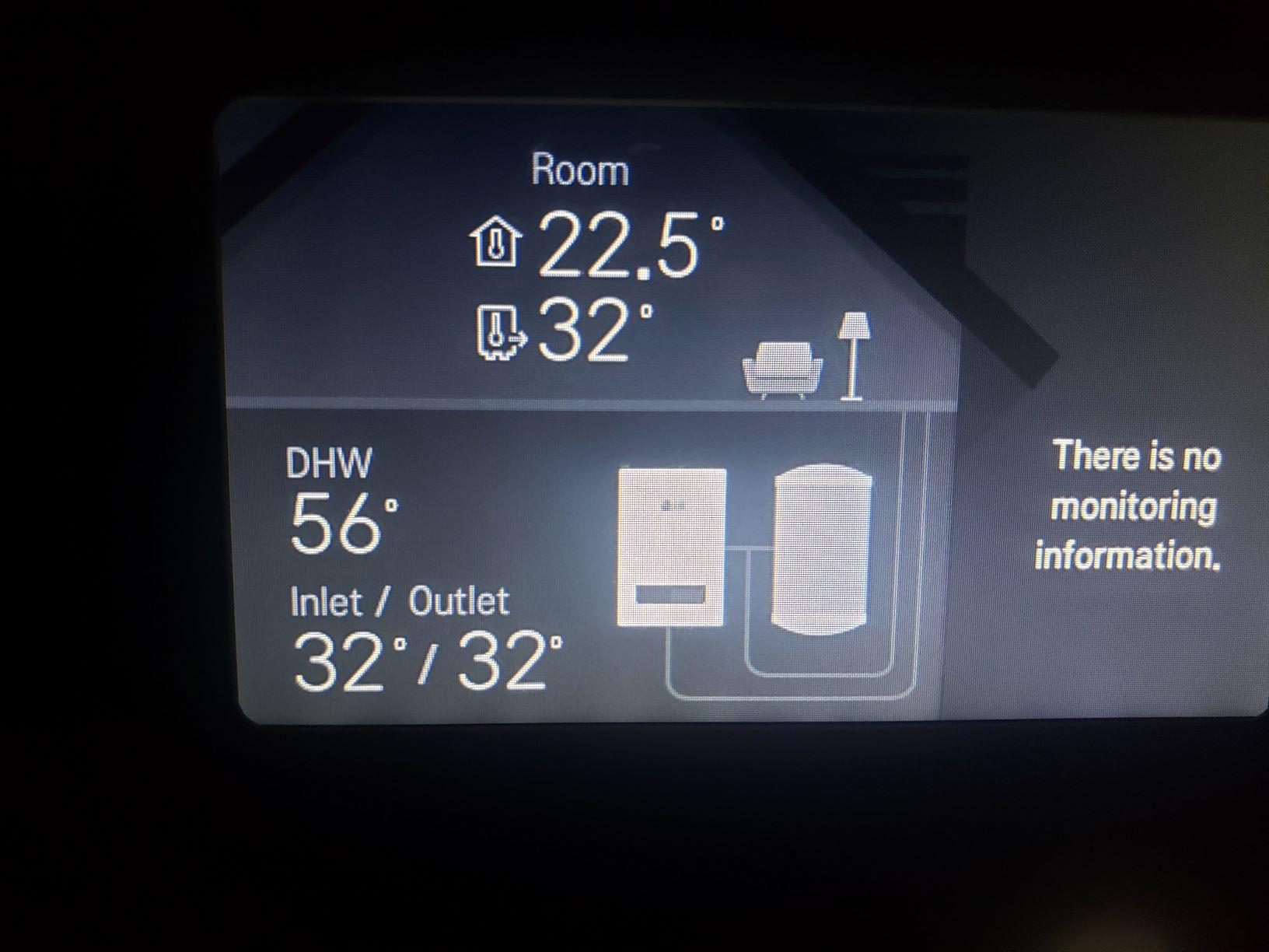

I have an issue with my new therma V monobloc.  When the unit is in heating mode it will not power the contactor powering the UFH pump.  (0 volts between ext pump blocks on PCB)  The air temperature in the data logging section of the installer menu of the control panel shows the air temperature to be 122-127.5 degree C which is obviously wrong but the display temperature on the contrler is correct at 22.5 degree C.  Using the LG cable to connect the controller to the outside unit. The system is using the temp sensor in the contoller (RS3) My installer is looking into this but has not come accross this before.  Any thoughts?
Thanks

Remind me how to access the logged data and I will check what mine says.
Oh, found it.  My air temperature seems to vary around 100 degrees, from 92.5 up to 107.5.  Obviously this is wrong but not always the same amount of wrong so it must be measuring something.
Edited by ReedRichards
Added info.

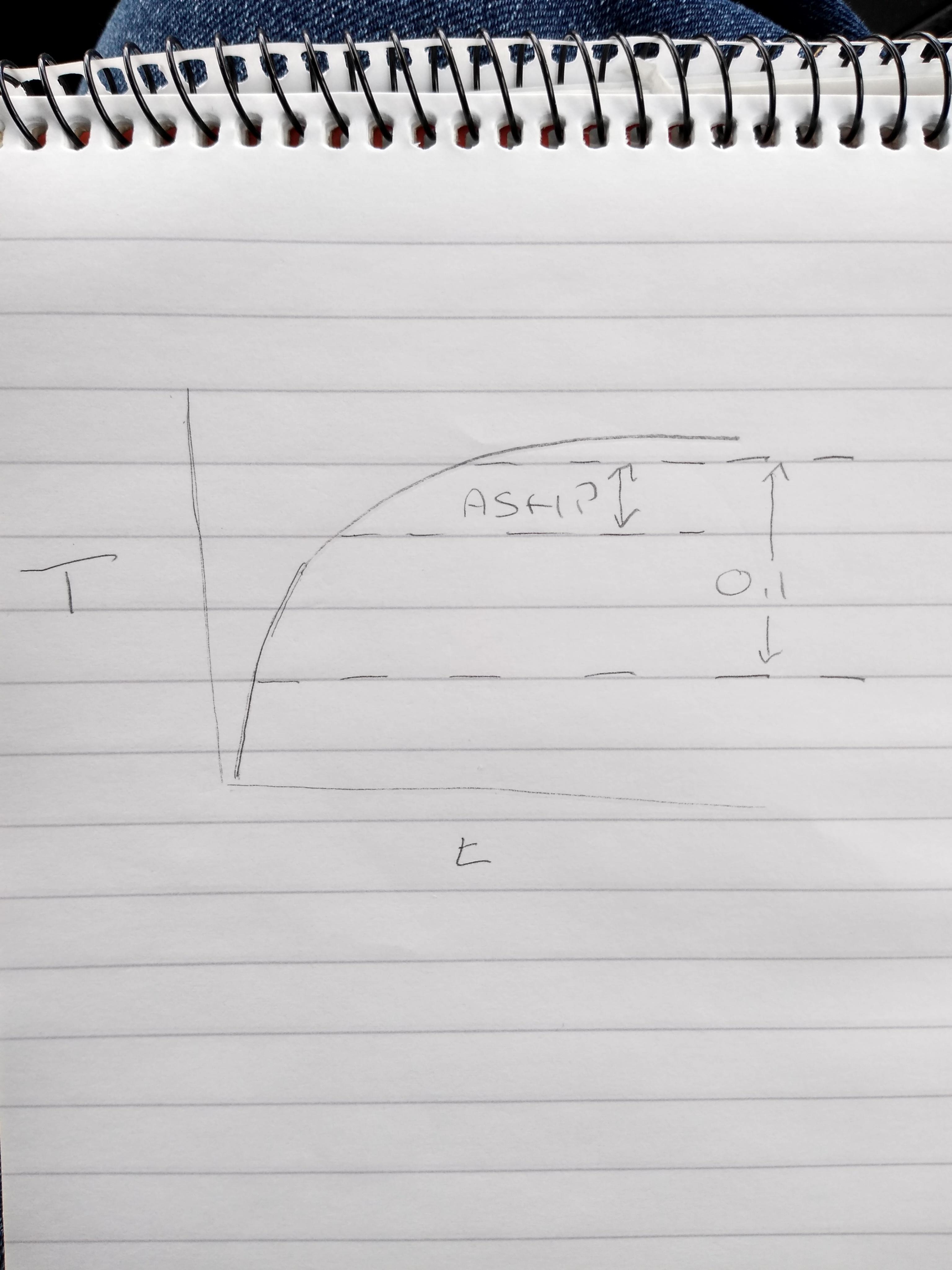

I'm curious about this as there is no obvious reason I can think of why it should be true.  Or rather the obvious reason is that your old radiators were oversized for the water temperature of your oil boiler whilst your new radiators are well-matched to heat pump.  So the response speed has nothing to do with the heat source and everything to do with the radiators.  Could this be true?
It will be a combination of the power that the ASHP puts out, the CoP it is trying to run at (if this is a settable parameter), the power the radiators can deliver at and the temperature differences between the indoor air temperature and the radiators, and the overall heat losses of the building.
It may also be a mismatch between the ASHP, buffer and radiators.
And that is before variable weather is taken into account, this can affect the CoP and the building losses. A cold but sunny, still day will be very different from a blustery, rainy day.
Usually combustion boilers have a greater power output as a ratio of mean power needed, this can mean they may heat up a building faster, but they do it at the cost of efficiency.
Any "boiler" has to raise the central heating water to the specified operating temperature and then keep it there.  Unless it is ridiculously cold outside my ASHP has enough power to keep the water at temperature.  It may do this at the expense of a very poor CoP when its very cold outside but using my Therma V in the basic (non-AI) mode it managed to achieve this throughout the last winter.
Once the heating water is at temperature then the rate with which it can heat the house will depend on how much heat the radiators give out compared to how fast the house is losing heat.  That's true of any radiator-based heating system.  So one reason an ASHP could be slower to heat the house than an oil boiler was is that the radiators give a smaller output at their specified operating temperature.  That would most likely be disastrously true if you did not replace the old radiators when you got the ASHP but might still be true anyway.  Once you reach the specified operating temperature for any boiler then it must be all down to what the radiators can achieve.
So then the other aspect of response speed it how fast the "boiler" can increase the temperature of the heating water.  I did a back-of-the-envelope calculation comparing my ASHP with my old oil boiler.  My oil boiler could heat the water faster but had further to go to reach the operating temperature so my conclusion is that there is not much in it.
In the real world of my house I have not noticed any difference in speed of response, except in the kitchen where I kept the old radiator and paid the price.  Its output is 30% below the calculated requirement and it is indeed slow to warm up in the morning.  But I knew that would happen and I know the reason why so I get very puzzled when people assert that there is some fundamental difference in response speed between an ASHP and other types of "boiler".
One point that you didn't note is that ASHPs like to run at a much smaller in-out delta so it's not quite as simple as running at 100% to get to setpoint. They're (internally) continually juggling flow/temp/ gas pressures and temps to try and maximise the production. Just because (say) the HP can deliver 55c water  doesn't mean it's aiming to do that when turned on from cold...
