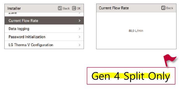

15 hours ago, ReedRichards said:
I have had a request for the Product and Installation Manual so I have split it into 3 parts to enable me to upload it.
LG Therma V Product and Installation Manual - the final part covering settings
This manual is very helpful! Especially regarding settings and how they effect the HP. Thanks for sharing!
Point of attention is that is refers to U33/ U43 and U44 types, monoblock and split. This is not always clear when reading the information.
Sometimes remarks have been added (see blow e.g.). This is not an issue, just good to realise when reading.
