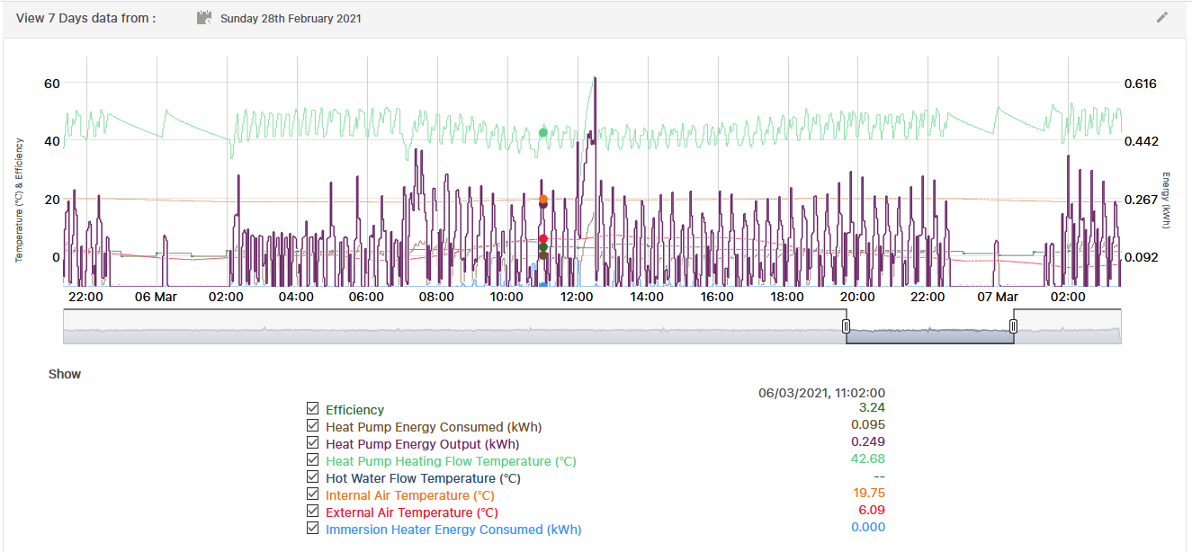

@Chris Bottomley, yes my Drayton Wiser programmer will tell me the minimum and maximum temperatures for each day without the benefit of a temperature sensor.  Possibly it uses this information for its "Comfort Mode" which tries to reach the desired temperature (increase) at the time set for that increase to occur.  Do you feel you are benefiting from the RHI Monitoring?  I just opted for the minimum requirement, which is metering.
@ReedRichards Interesting question about the benefit from the metering, we have the MMSP monitoring package but the supplier failed to support it so we don't get any money back from the RHI or the support that we should get from the supplier.  On the plus side I think the supplier possibly got his pricing wrong in our benefit.  The MMSP monitoring provides 2 minute readings of heat pump energy consumed and output, efficiency, flow temperature, internal and external air temperature (although as I note above I believe the external air temperature is from a local weather station not the data logger) and also immersion heater consumption.  I also have logs of the solar panel output and can get can get downloaded data from the smart meter.  What I do not have and would be very useful is heating and hot water demand logs so I can work out whether the heat pump is supplying radiators or hot water.  Heating circuit flow temperature would be useful as would an actual outside air temperature reading for our location.
Do we benefit from the extra monitoring?   It has been useful to a certain extent in tuning the heat pump operation, for example you can see the energy used if the heat pump is just maintaining the temperature in the heating buffer tank when there is no heat demand.  You can also see the correlation between the outside air temperature and the heating flow temperature which helps when trying to set the controller parameters for better efficiency.  Due to the way the heat pump works you don't get nice smooth plots (see the attached screenshot) so you need to do a lot of eyeball estimation to work out average values and the impact of changes to the system parameters.  I have done some manipulation on the data to smooth it and provide average values but I'm still working on the best way to use the data.  In conclusion I think that we may get enough help out of the metering to reduce the consumption of the heat pump to get payback for the additional cost of the metering in 4 to 5 years as compared to what I would have been able to work out from just the basic energy consumption figures.
Frequency distributions are probably the way to go i.e. mean flow temperatures by different temperature differences.  There should be two peaks then, one for the space heating and the other for the DHW (assuming the flow temps are different).
Edited by SteamyTea
Just FYI, this is my entire house electricity consumption for 7th March.  The highest peaks are mostly heating the hot water but could be cooking.
Edited by ReedRichards
