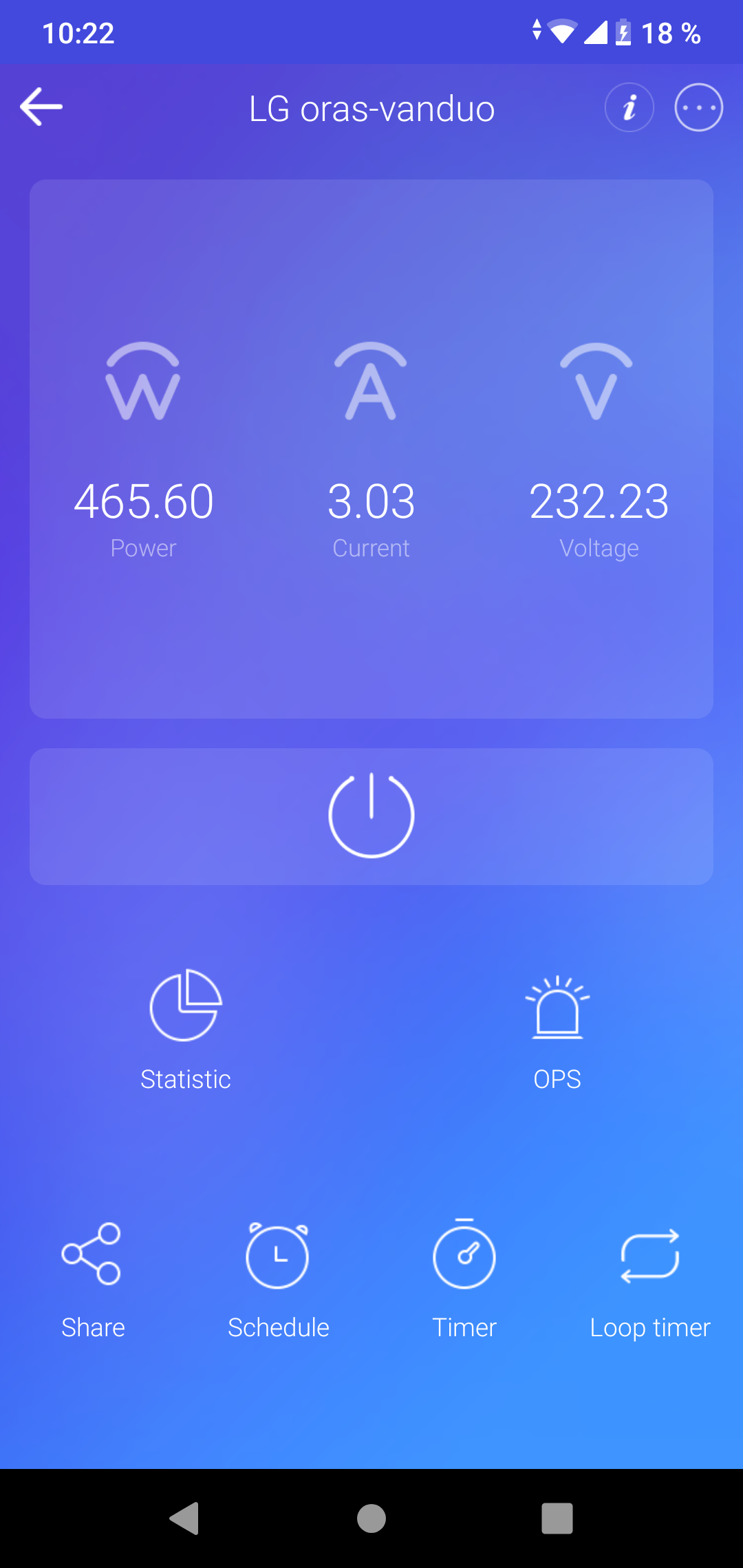

  1. After 1,5 year of my experience with this monoblock when I thought that AI function is unusable at all, seems that I was wrong. Guys I suggest You try AI function with seasonal settings in PPT file I added, and try set pump pre/ower run to another settings (my 2/2). Sensors air+ water. Seems heatpump working continuesly, I newer seen it before, without shuttdowns. The electricity consuption is wery interesting too. Its just another way ?. Its short expierence, but maybe its right way. Waiting for yours expierence if you try it.

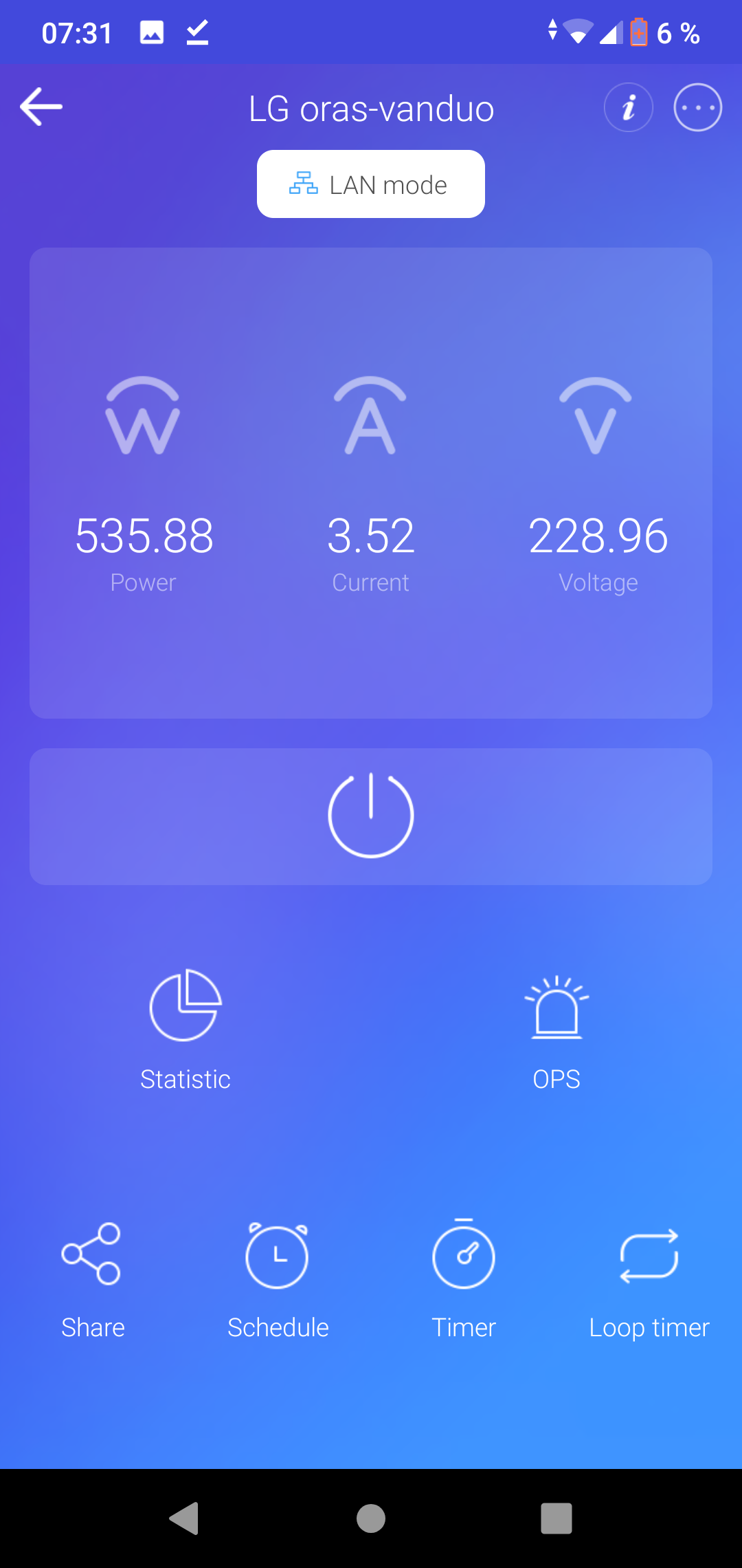

  3. Some pictures from my researches ? The best power consumption/working continuing.

  5. I use room thermostat to, but seems its not help. I think its possible that heat pump will be working more effective(i tell about power consuption) if its working at minimum power but for a long time then if at full power short time. I think thats possible with installers options, but I didnt understood how, til now. I bougt it on Climaway site for 3100 euro, but I think that its not actual for You, becouse I saw similar price in UK. Room thermostat bought on Ebay, HWT thermostat from China - for reasonable price. Pump connected to grid with soonof wifi module, its counting energy consuption.

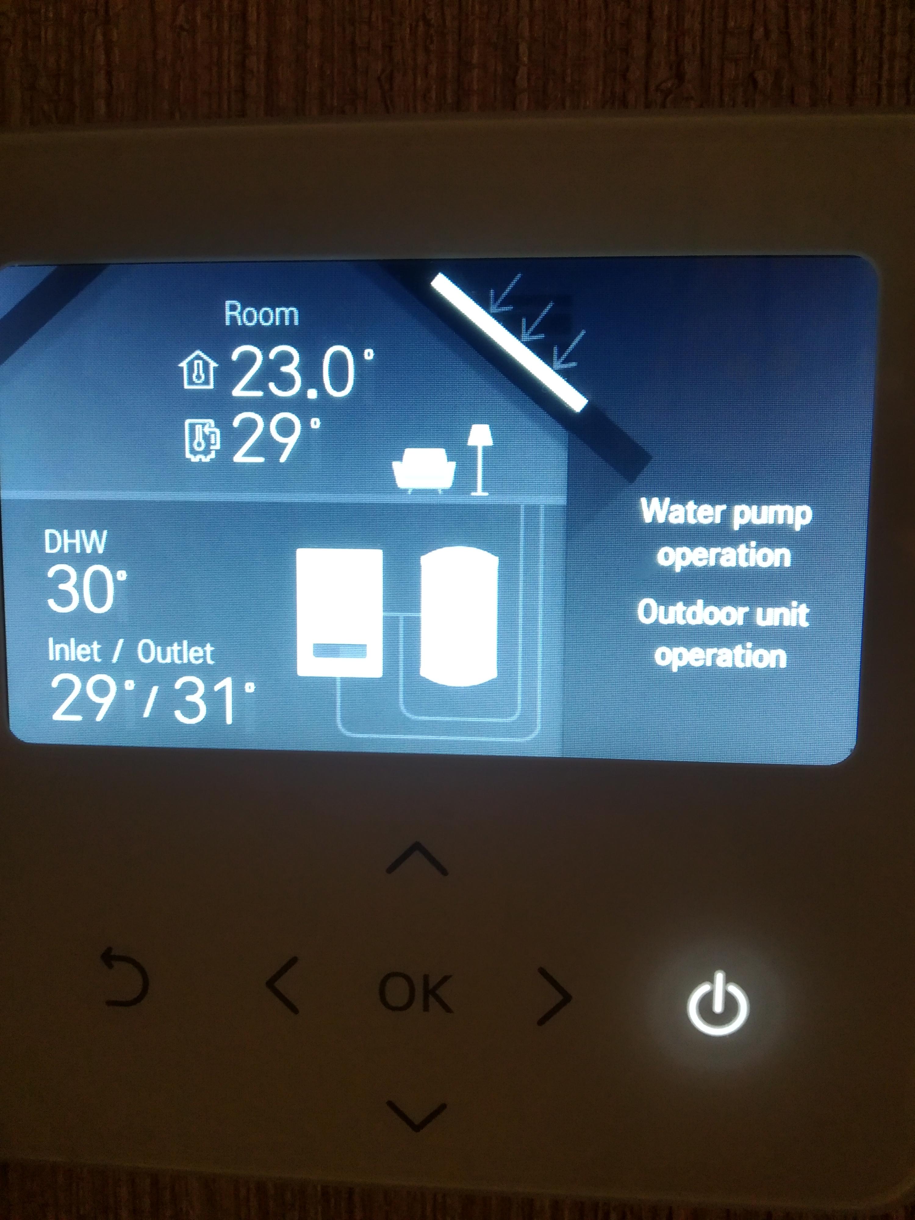

  6. Hi, guys my name is Arvydas, at first I will tell that I am from Lithuania and sorry if my english is not so good. Now about 2 monts I am lucky ? owner of Therma v R32 9kw. I sent this heat pump from Italy and installed it at my self. Before I heatet my house by wood. At yet I am not answered for some questios about how it will working for my self. On internet is not so many forums where guys talking about these pumps, seems that you are a more qualified than others in their discussion. Maybe you can answer how this pump should working. I mean that if I right understand, the best algorithm for heat pump is if it working all the time without shut downs. But my heat pump is heating the house to as example 23 degrees ant shutting down, then working just water pump. After some time when temperature decrease heat pump turning on , and thats all the time. I did not find the answer or thats will be or not. Maybe you can help me to answer to this question.
