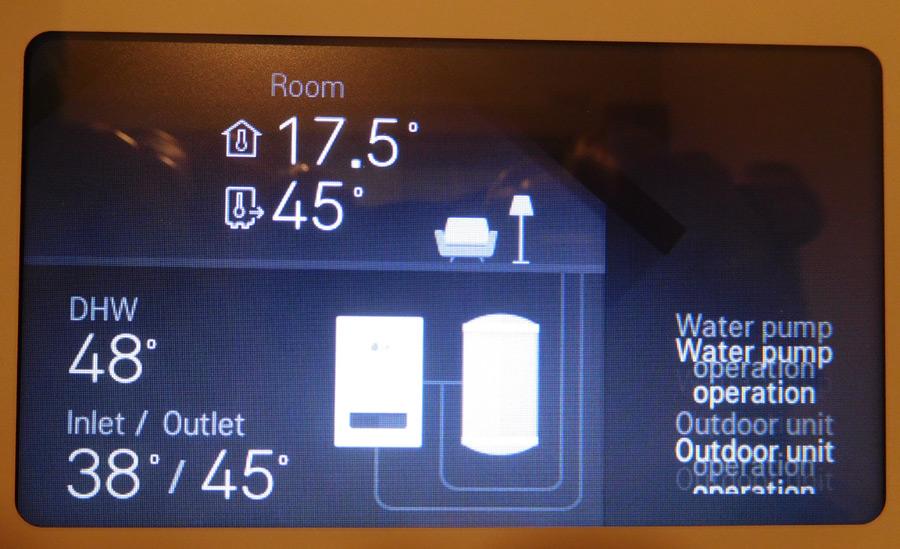

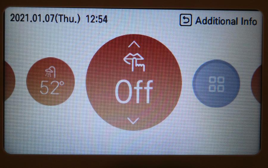

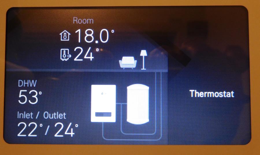

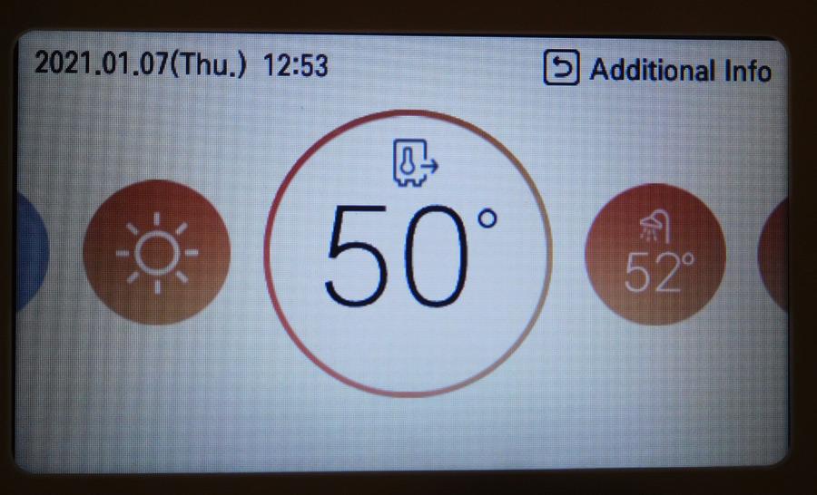

Hogboon Posted January 7, 2021 Share Posted January 7, 2021 Thanks for the reply ProDave. The short answer is "I have no idea" but one picture etc please see attached images which are of my LG 'Remote Controller' which, as you have remarked is less than user-friendly. E.g. I have absolutely no idea what is 'Off'. The central heating is controlled by another gizmo - a Nest [over-rated] Thermostat but I see nothing in its equally convoluted menu that might regulate temperature. Do I infer correctly from your reply that you don't think it is a flow issue? and adding a pump would not cure? and where are these CH14 errors reported? My family is from Orkney. That's why I live in Somerset! Link to comment Share on other sites More sharing options...
ProDave Posted January 7, 2021 Author Share Posted January 7, 2021 First picture, symbol with a thermometer and and arrow pointing out means that is showing the FLOW temperature, currently 50 degrees and shows the DHW target temperature as 52 degrees. Third picture shows the flow temperature is 45 degrees and the return temperature is 38 degrees. So if your radiators are running at 45 or 50 degrees they won't give as much heat as typically running at 60 degrees from a boiler. You would know if you have a CH14 error, the thing would stop and you would be aware of it. You have a different controller to me, yours looks more modern. This confirms my suspicion that what I have is an older model and hopefully all the issues I have suffered have been fixed in the newer versions. Assuming you have the full manual, you can edit some of the setup parameters and you could try increasing the water flow temperature in heating mode to perhaps 55 degrees but the more you increase it the less efficient a heat pump becomes and the more likely is that it will have to defrost. Link to comment Share on other sites More sharing options...
Hogboon Posted January 7, 2021 Share Posted January 7, 2021 I haver increased the reading of 50º [above] to 55º - which seems to be the max - and left everything else the same. The image, which remains incomrehensible to me, was take some 3 hours after the one above. Link to comment Share on other sites More sharing options...
ProDave Posted January 7, 2021 Author Share Posted January 7, 2021 I am not familliar with your controller so can't help much more, a good read of the manual should make it a bit clearer. You only have water flow of 24 degrees in that picture, I wonder if you have turned up the DHW temperature? Link to comment Share on other sites More sharing options...
