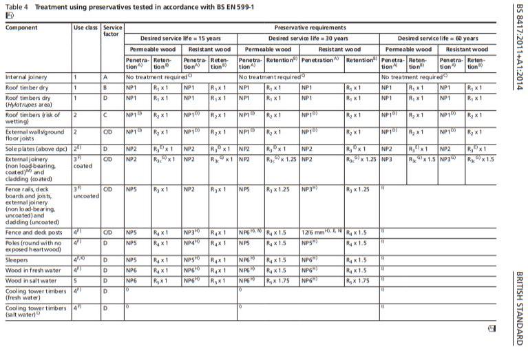

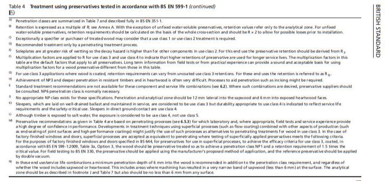

Ian Posted July 10, 2018 Posted July 10, 2018 (edited) @recoveringacademic The relevant British Standard is BS 8417:2011+A1:2014 Preservation of Wood. It takes a risk based approach. Quote: "To determine whether a timber component needs preservative treatment, the following should be assessed: • the biological hazard indicated by the use class; • the likelihood and consequence of failure; • the inherent natural durability of the wood to be used" The standard then looks at the different service situations where wood is used based on 5 "use classes" with 1 being the least risky and 5 being the most risky. The example given for use class 1 is "All timber in normal pitched roofs except tiling battens and valley gutter members; floor boards, architraves, internal joinery, skirtings; all timbers in upper floors not built into solid external walls" The example given for use class 5 is "Marine piling, piers and jetties, dock gates, sea defences and ships hulls" In the risk based approach that the standard takes these use classes are then assessed against a set of service factors based on risk of failure where factor A is a negligible risk if the timber fails and therefore preservative treatment is not necessary to factor D where failure of the wood would result in injury or death. and therefore treatment is essential. Desired service life is also considered. The table attached below is just one example from BS8417 - there's other tables for the various types of timber treatment. Let me know if you need to know the preservation recommendation for any specific situation in your build. Ian Edited July 10, 2018 by Ian
