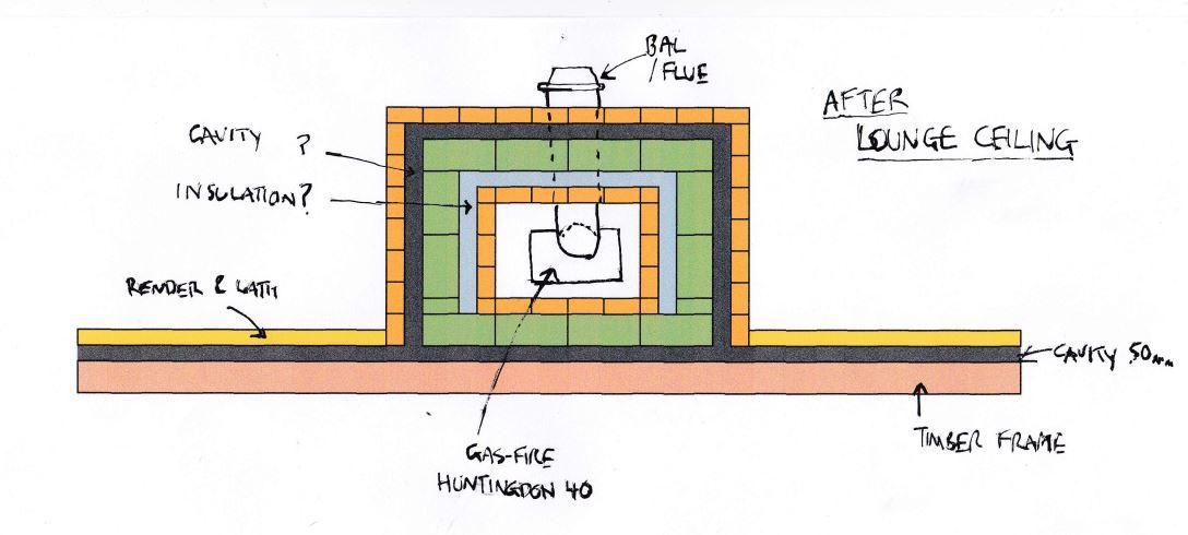

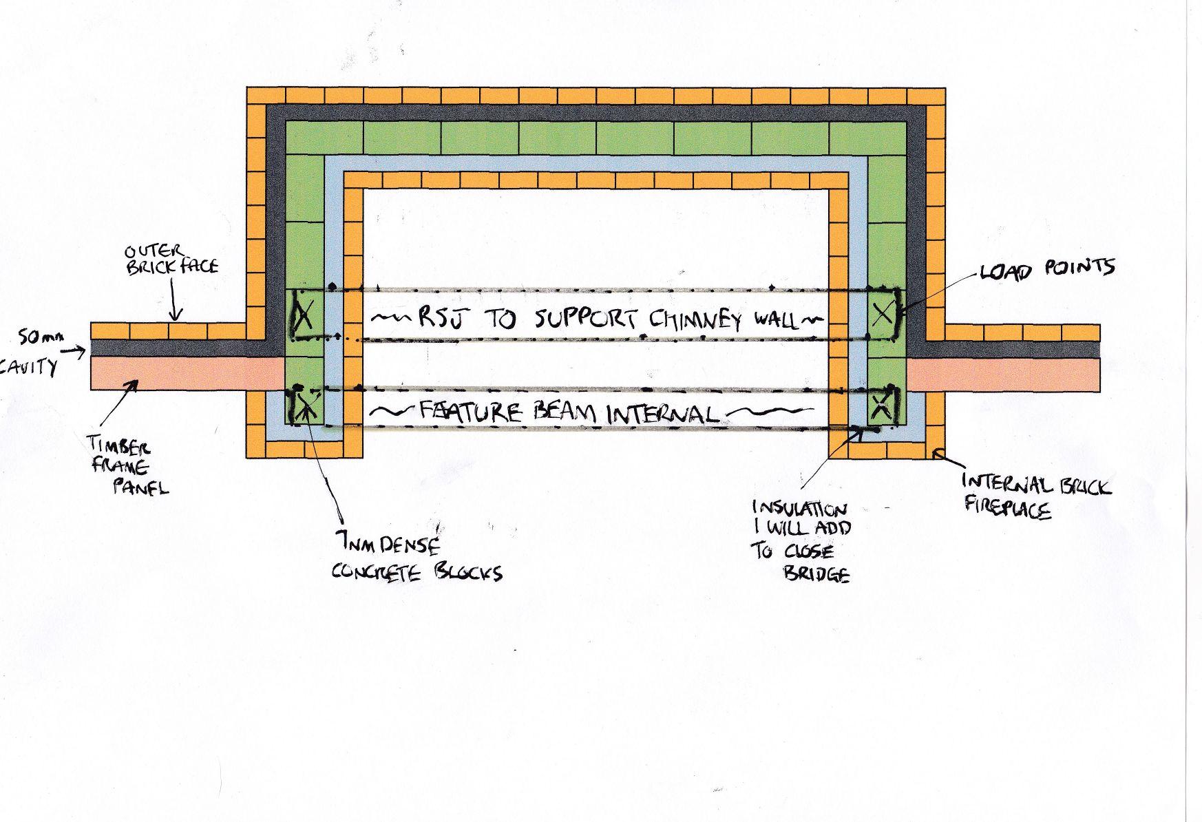

Ed_MK Posted July 20, 2018 Author Share Posted July 20, 2018 Well have i finally cracked it Is my design ok ? bricklayer is coming in a week and I have sent these to an SE who says he can advise me on RSJ requirements online-style ...no doubt for a few hundred quid ! Anyway ..taking into account what Peter and others said about thermal bridging and the like ... here it is ! Link to comment Share on other sites More sharing options...
PeterW Posted July 20, 2018 Share Posted July 20, 2018 You can lose the 50mm cavity around the outside of the chimney and add it to the insulation layer and job done. Link to comment Share on other sites More sharing options...
Ed_MK Posted July 20, 2018 Author Share Posted July 20, 2018 32 minutes ago, PeterW said: You can lose the 50mm cavity around the outside of the chimney and add it to the insulation layer and job done. hmmm ...how would i set that out Peter ? Also after the Lounge ceiling / fireplace opening ..the layout will change (as below) much narrower * I take it the chimney insulation can be omitted here as after the ceiling it is continuous ..? * but again how do i treat the 50mm cavity around the 3 sides of the chimney ..can it just be "closed off"? * also would you continue with the 7nm blocks up the stack to the top?...they are strong ...but the downside is if they have the Ancor Fixings drilling them would be FUN if i remember from the past projects Link to comment Share on other sites More sharing options...

Ed_MK Posted July 20, 2018 Author Share Posted July 20, 2018 2 hours ago, PeterW said: Need to draw the sections - doesn’t work like that... OK ....i didnt think it would be that easy. I think i will wait until the online SE gets back to me today/monday see what he says and provides i suppose i need it for later in case the BCO asks how i made the calc for the RSJ Link to comment Share on other sites More sharing options...
PeterW Posted July 20, 2018 Share Posted July 20, 2018 Standard HX lintel will be fine but let him come back. Should be no more than £50 Link to comment Share on other sites More sharing options...

Ed_MK Posted July 23, 2018 Author Share Posted July 23, 2018 Well I am probably agonising over this chimney design more than anything on this house LOL. The SE should get back to me today ..so at least I will know what RSJ goes in but ...I have redrawn the design and tried to use sections (as Peter suggested) Don't laugh.. but I am not sure the UPPER part of the chimney NEEDS a cavity ? also I am still not sure how to handle the transition area ..between sections A and B I put it all on this big PDF ...you can zoom in quite close to see text and stuff. Sizes and relations should be fairly accurate Chimney_Layout_Ed.pdf Link to comment Share on other sites More sharing options...
PeterW Posted July 23, 2018 Share Posted July 23, 2018 Top section doesnt need block and you need to lose the 50mm cavity around the fire back as before. Link to comment Share on other sites More sharing options...
