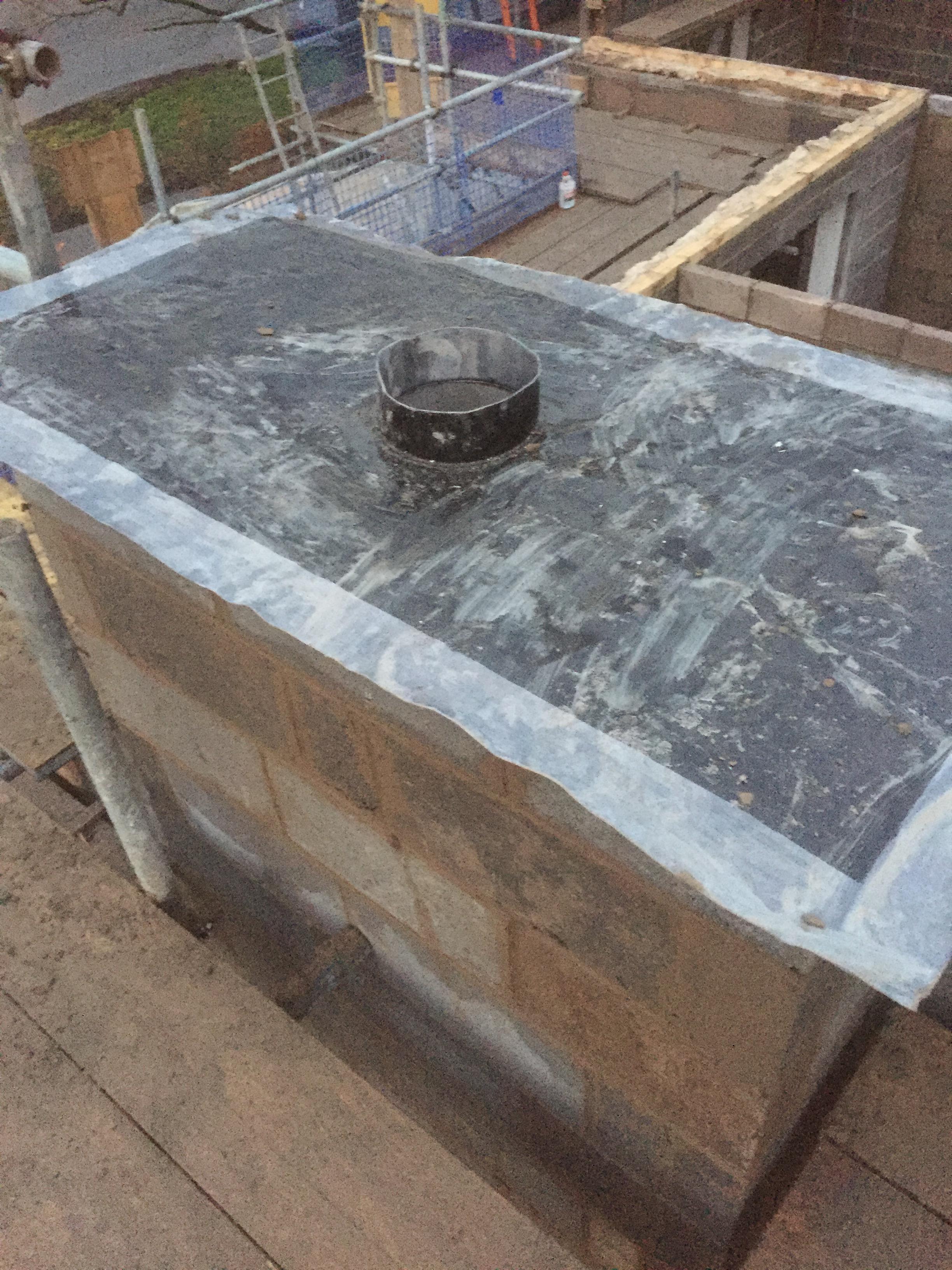

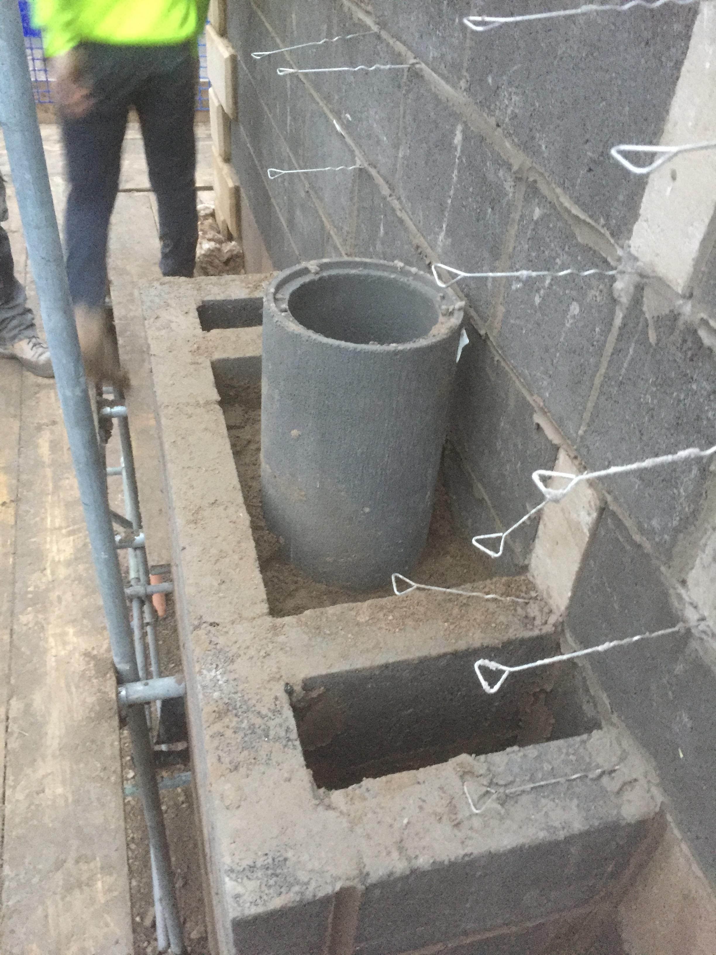

We have a very simalar chimney
and will instal a wood burner
We build in a liner kit and don’t intend using a flexible pipe
The chimney kit was designed through our local plumbers merchants Bends etc and cost about £400
The only thing that BC insisted on was that it was built in small stages and back filled around the liner with a 7-1 sharp sand mix to allow expanding and contracting
Perfectly smooth joints and loads of photos

Posted
They look like Dunbrik liners. I’ve used them, should have some sort of vermiculite and cement around them as an insulation layer unless the ones @nod fitted are different.
You have a choice with a built in liner - class 1 or class 2. Class 1 can be for anything including wood burners and solid fuel, oil and gas. Class 2 is oil and gas only.
For the small difference in cost I would fit a class 1 liner and ensure it’s sealed correctly then fit a gas cowl to the pot. It means in the future it can be swapped for anything and is not limited to just gas.
Posted
3 hours ago, dpmiller said:
Are those concrete flue pipes rather than clay?
Yes
Posted
They are Dunbrik
The flu guy said to use vermiculite or a very lean sharp s&c mix
He eeccomended the later
Not picture But we have two sharp angles He seemed to think it would hold everything together

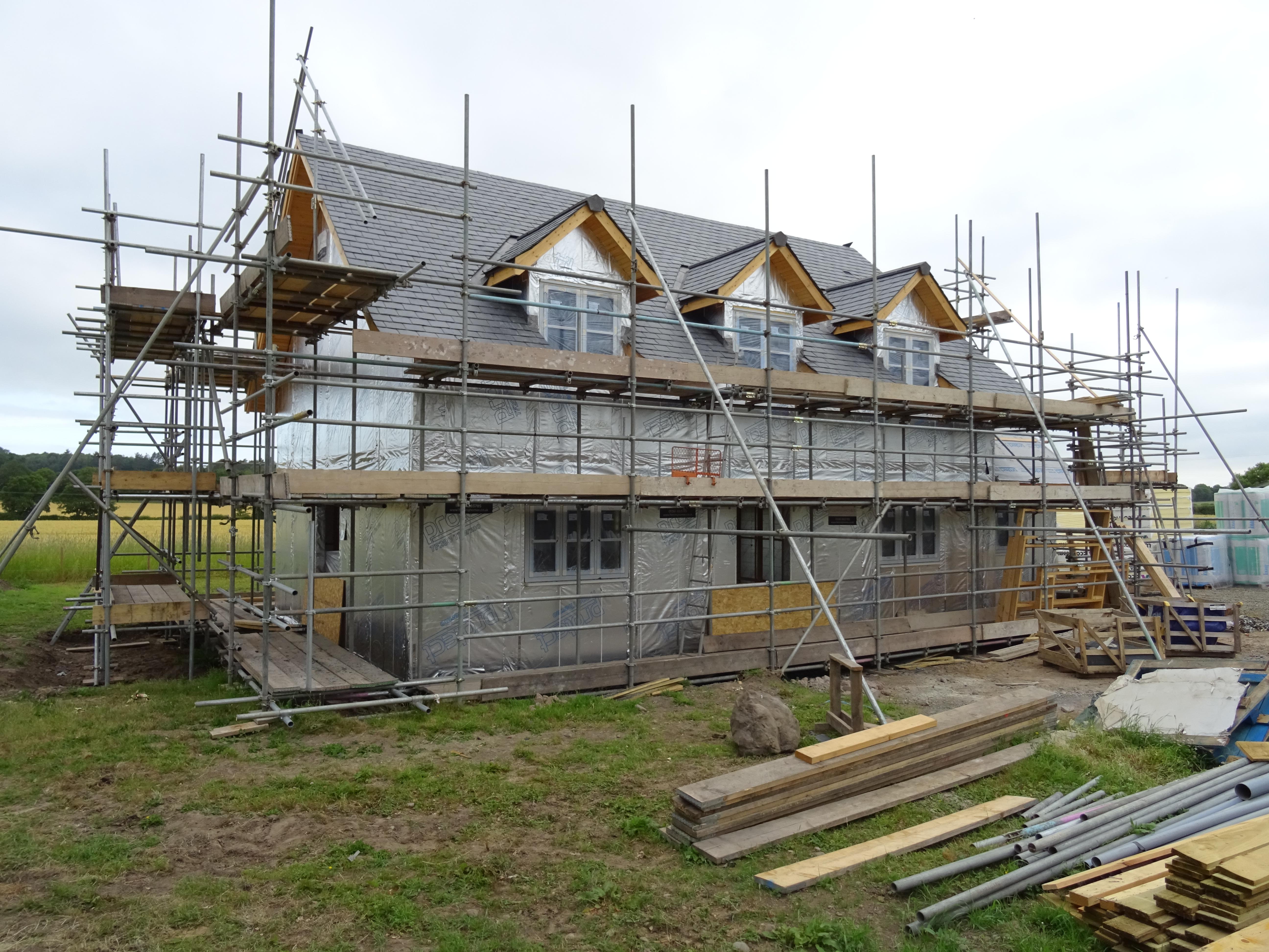

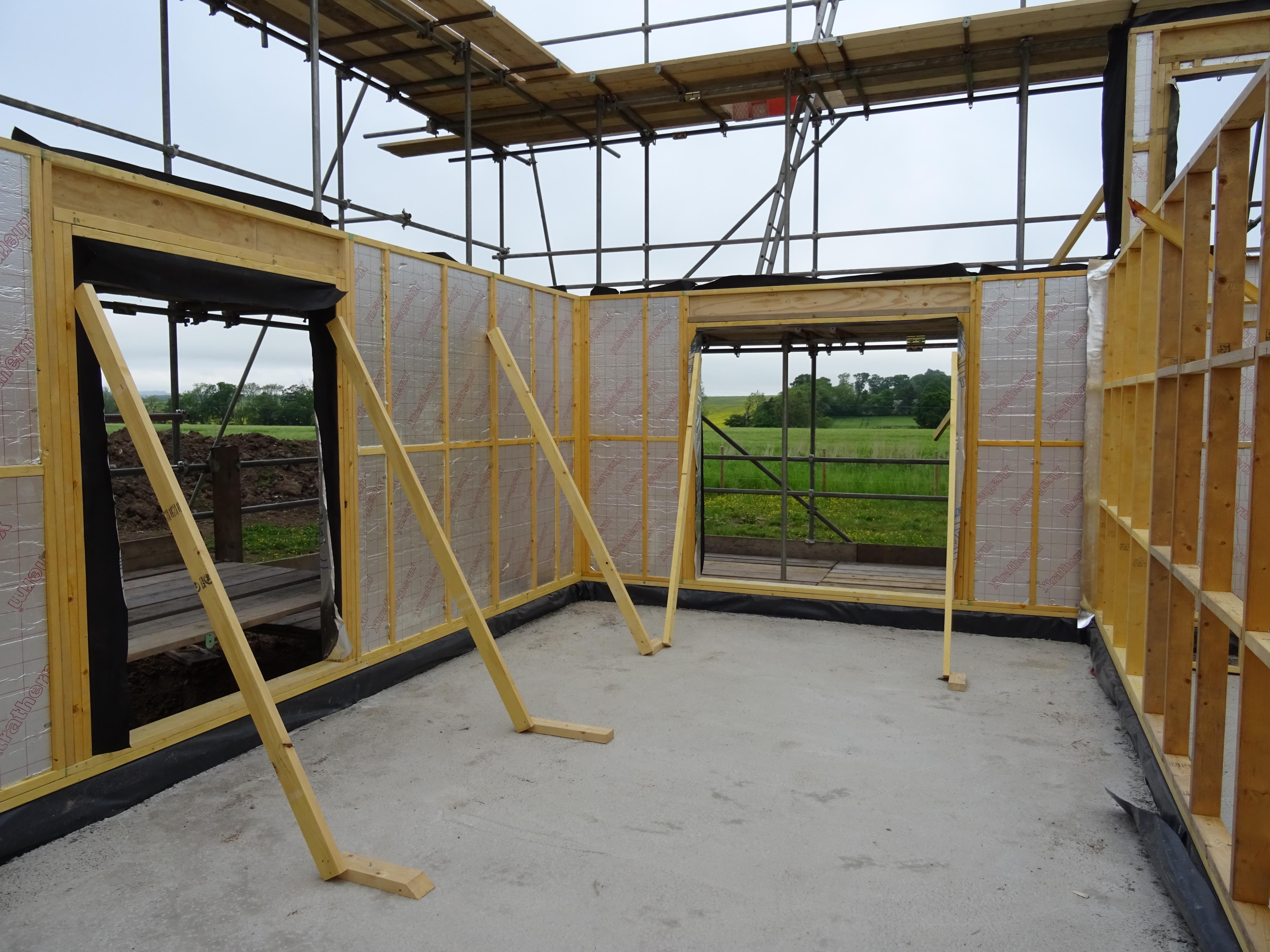

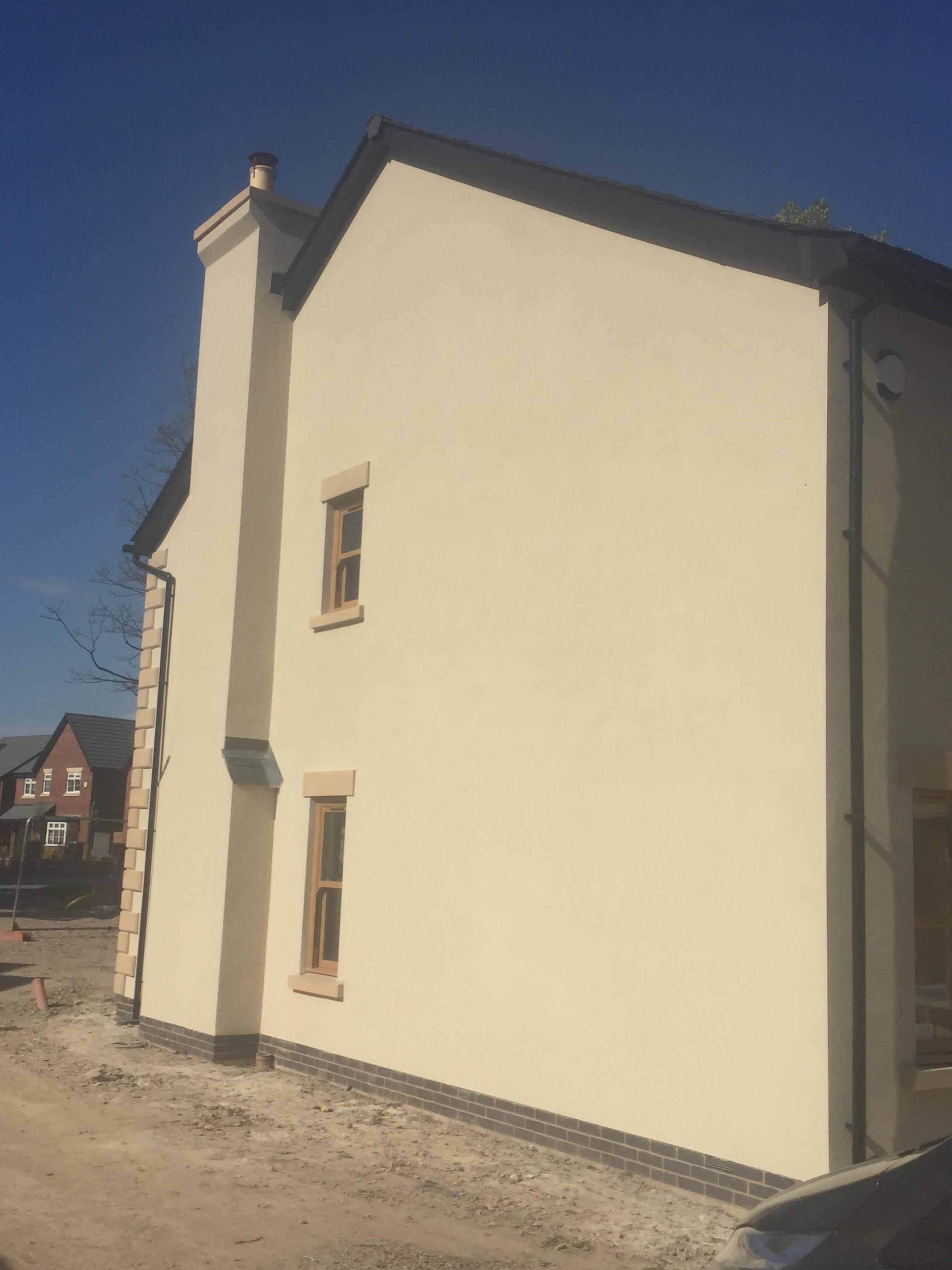

@Ed_MK I'm not sure this is going to be of any help just yet but we too are having an external chimney built which will house a WBS, so in a similar position to you.
The attached photos show the "hole" from the inside [left hand opening] and the external shot will show where the chimney will be built.
Our builder is planning to start the external block work this coming week. The guy installing the WBS will also be taking care of the following -
Supply & fit - 5kw w/b stove, 1 Fresh air kit, installation materials including liner, vermiculite,  Granite hearth, Wood  Beam mantle and HETAS Certificate.                                                               The Joiner will have to board up the "hole" as we will not be having the whole opening as a finished product if that makes sense.
Hopefully, once our work starts, some further photos will assist.
In a final attempt to offer something constructive - during our research stage we contacted Stoves on  line and they priced it all up for us and sent through some "plans" / diagrams of how it was to be fitted. Might be worth your while if time is on your side?

that a lovely crisp roof on there too!
how are you facing the dorma's ? ....render?
Yes they will be finished in K-Rend. The thing that is still up for discussion is how to finish off the boards - over hangs etc. Sorry not really up to speed with the correct terminology as yet !!
