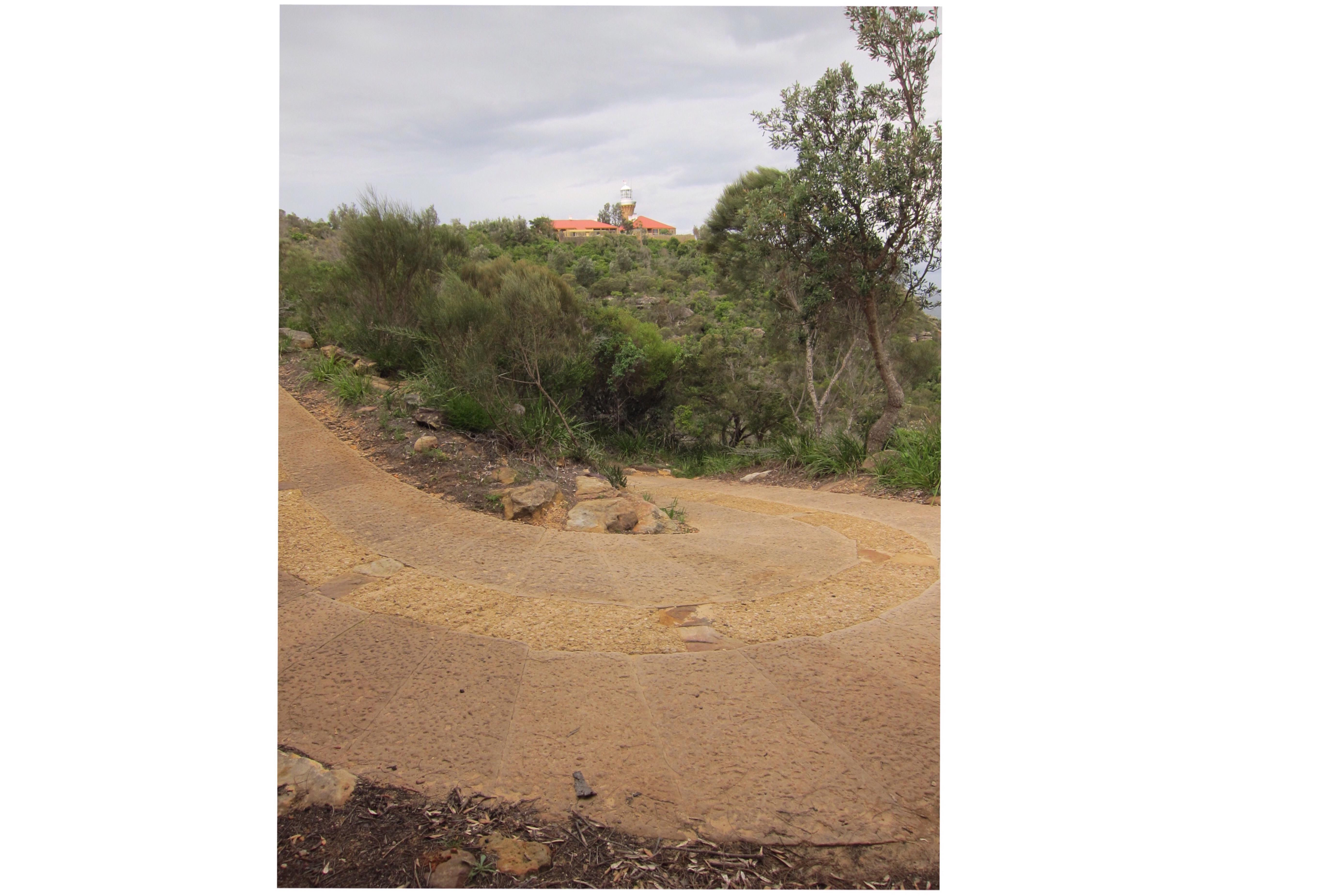

Cpd Posted June 28, 2018 Share Posted June 28, 2018 Come on now beef it up..... here is one I built about 7 years ago, 750 meters long with each block coming in at +800kg should look good in your neck of the woods. But seriously sandstone comes in all grades, this one was very hard and resistant to the salt erosion as it was right next to the ocean, we were driving over it with a tractor and a ton of stone hundreds of times without a problem. 1 Link to comment Share on other sites More sharing options...

Pocster Posted June 29, 2018 Author Share Posted June 29, 2018 11 hours ago, Cpd said: Come on now beef it up..... here is one I built about 7 years ago, 750 meters long with each block coming in at +800kg should look good in your neck of the woods. But seriously sandstone comes in all grades, this one was very hard and resistant to the salt erosion as it was right next to the ocean, we were driving over it with a tractor and a ton of stone hundreds of times without a problem. Lol I might struggle with 800kg a slab !! ? Link to comment Share on other sites More sharing options...
