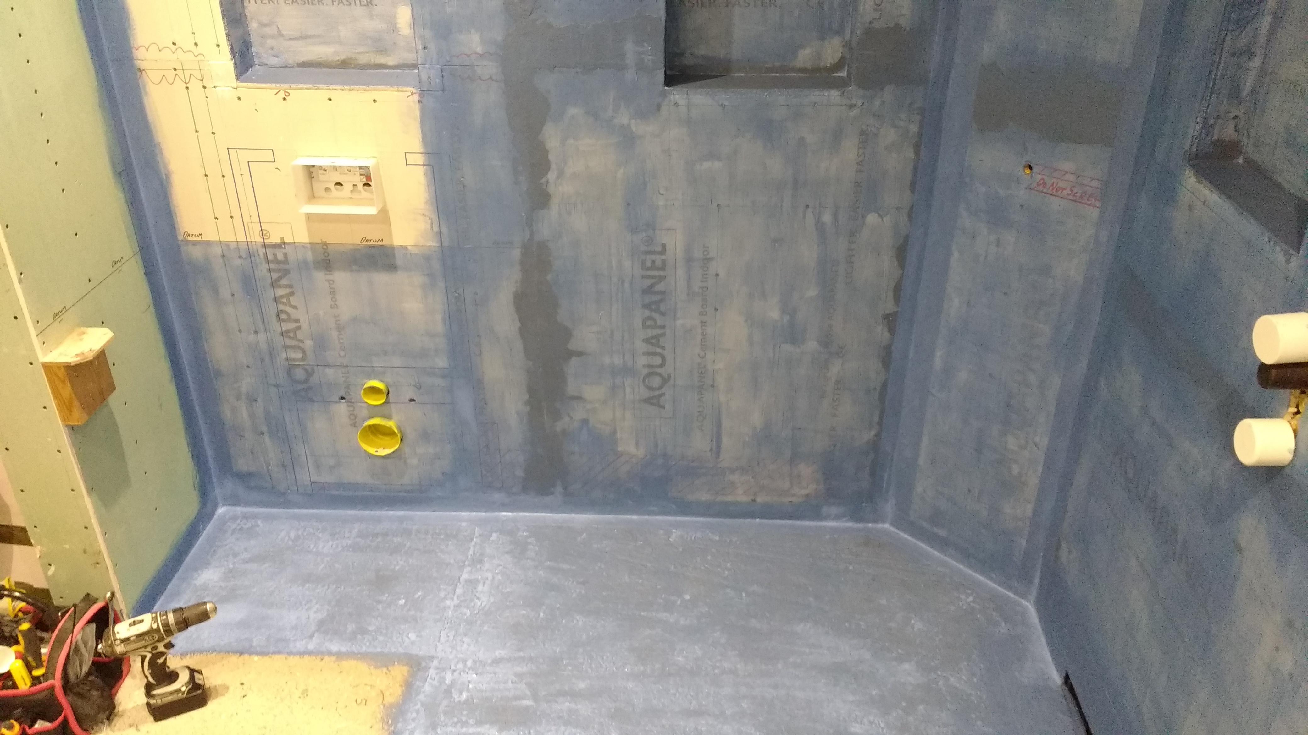

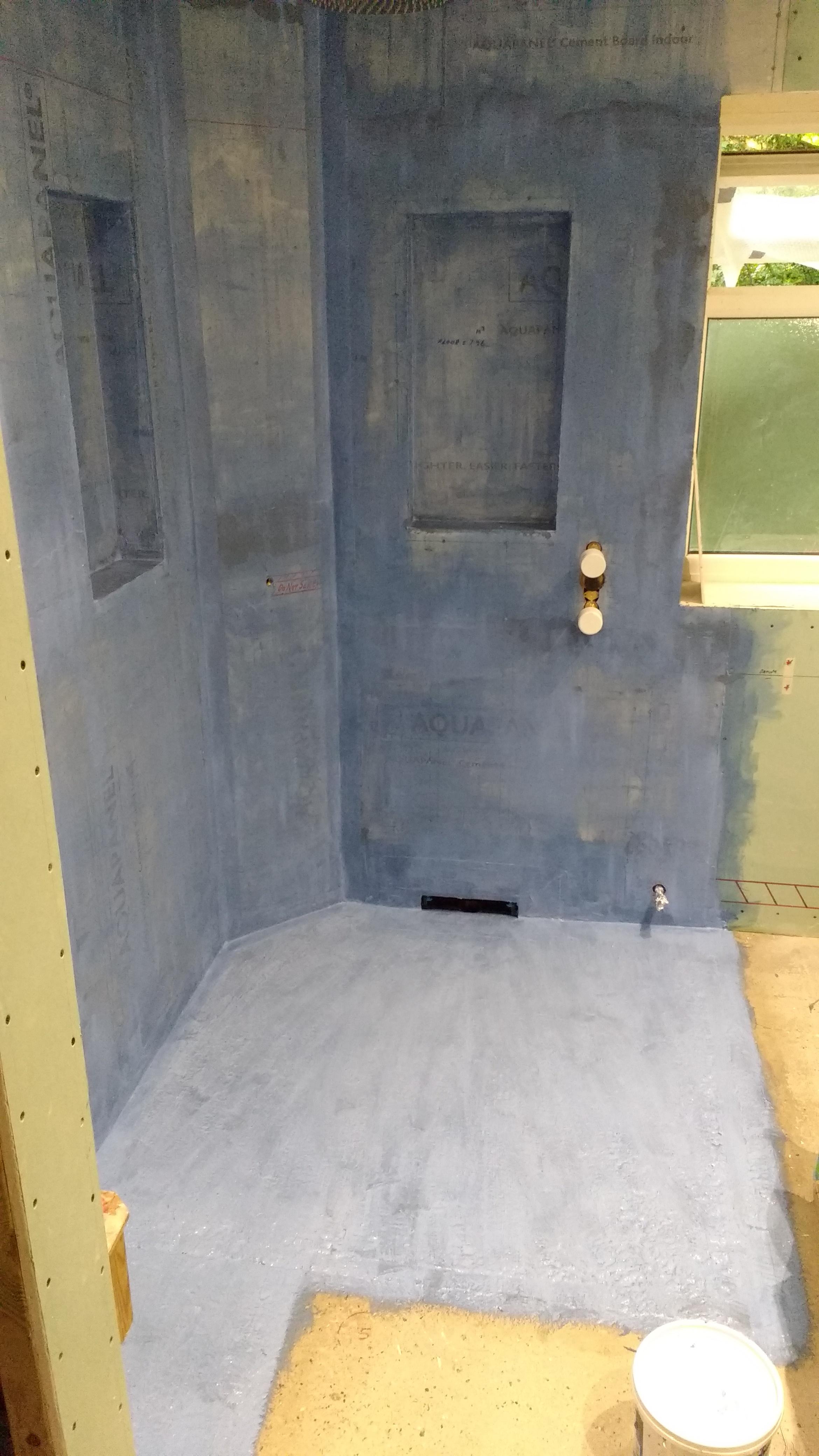

Onoff Posted August 1, 2018 Author Share Posted August 1, 2018 It's getting "bluer": No.1 son complaining of the smell so has retreated upstairs to his room which is unheard of! Link to comment Share on other sites More sharing options...
CC45 Posted August 1, 2018 Share Posted August 1, 2018 why have you stopped? Link to comment Share on other sites More sharing options...
Onoff Posted August 1, 2018 Author Share Posted August 1, 2018 33 minutes ago, CC45 said: why have you stopped? No more primer and just a little tanking membrane left. Waiting on the new 7.5m kit. Going to do the whole room I think. Link to comment Share on other sites More sharing options...

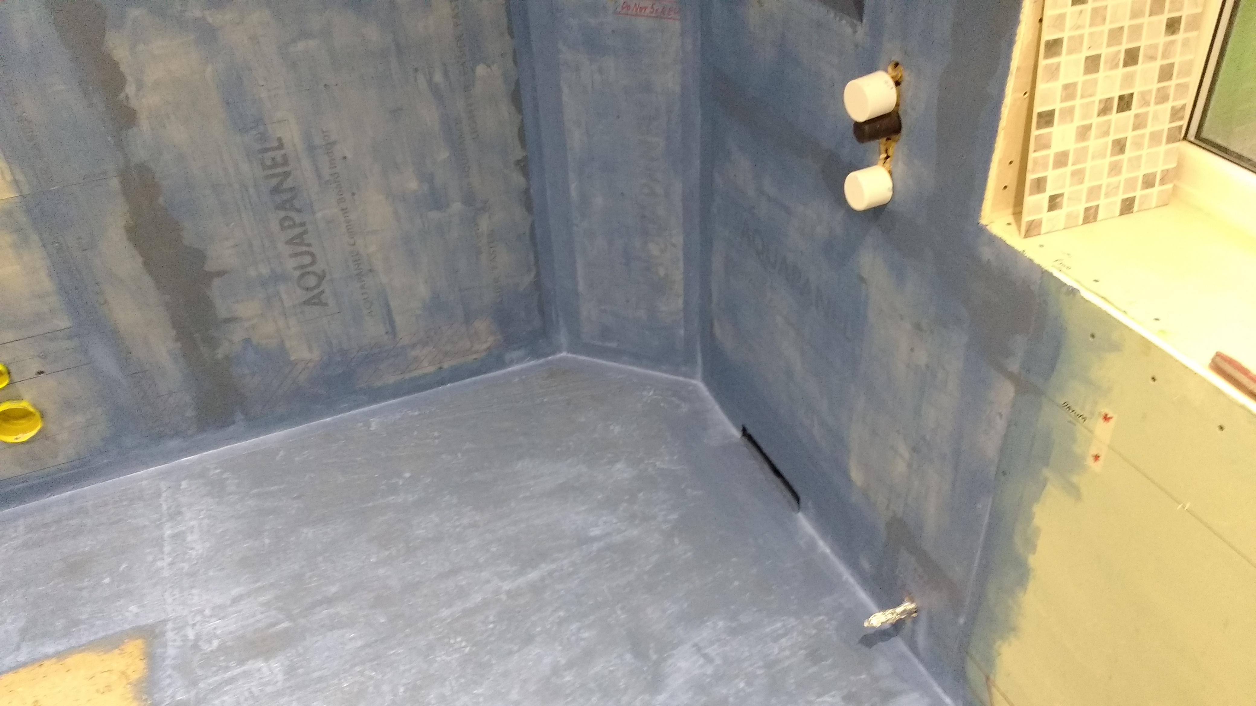

Onoff Posted August 1, 2018 Author Share Posted August 1, 2018 A couple more shots after 2 coats. Instructions reckon it wants to be 1mm thick... it's NOT...? Link to comment Share on other sites More sharing options...

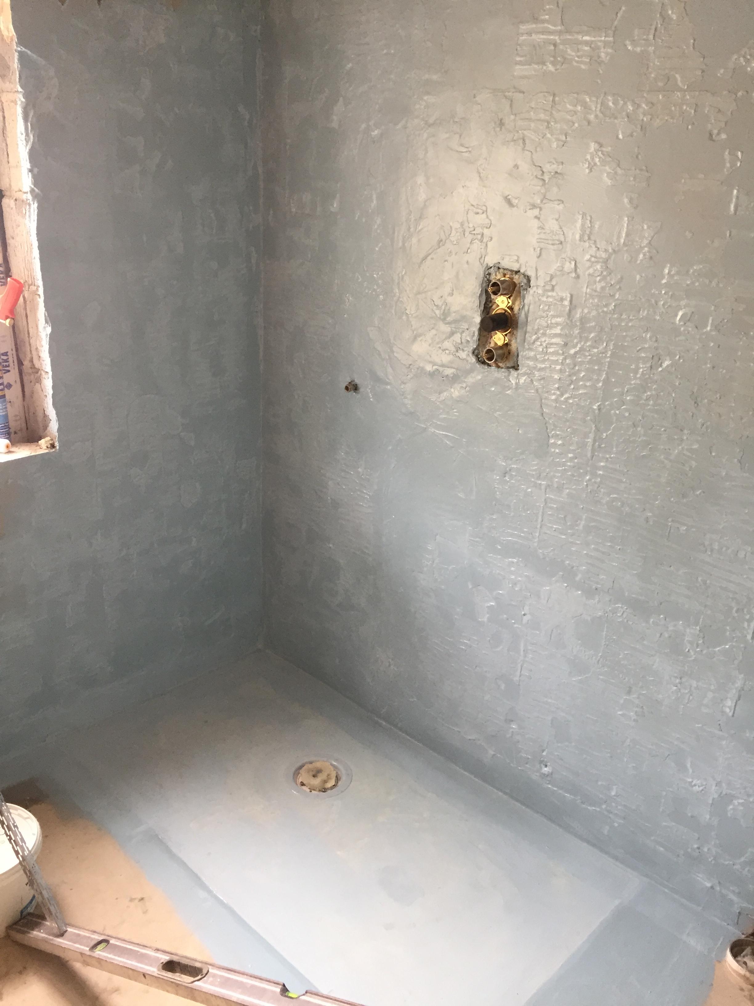

Nickfromwales Posted August 1, 2018 Share Posted August 1, 2018 (edited) 1 hour ago, Onoff said: @Nickfromwales, just realised, don't you usually apply tanking strip over the shower valve? I was going to then thought what's the point as most of it will be cut out anyway. Now I'm not sure... Bit confused tbh as sure before you've said don't cover it completely in case of future access needs. Also you said about putting an inverted U of Sika flex around it with the bottom open to allow drainage. Ditto the hose outlet on the mitted wall, any need for a square of tape over that? Cheers Yup. I did one and mummified the valve. Then I looked at it and thought wtf. I just did this : first coat of tanking on. Then i tiled it and dabbed a horseshoe shaped dab of adhesive from 8 o'clock to 4 o'clock, and as it's cementitious no water will be getting in there. By the time I pushed the tile on and displaced the adhesive I was sponging it away from the tile edge. Fackin Bombproof. Edited August 1, 2018 by Nickfromwales Put my o'clocks in order. 1 Link to comment Share on other sites More sharing options...
CC45 Posted August 1, 2018 Share Posted August 1, 2018 I put at least 5 coats of tanking on - its def no more than 2mm thick. I didnt do around the valve - will put some silicone around it underneath the tile and then again with the posh cover. Coming on now Mr @Onoff. Link to comment Share on other sites More sharing options...
Onoff Posted August 1, 2018 Author Share Posted August 1, 2018 3 minutes ago, CC45 said: I put at least 5 coats of tanking on - its def no more than 2mm thick. I didnt do around the valve - will put some silicone around it underneath the tile and then again with the posh cover. Coming on now Mr @Onoff. I don't get it tbh. I've done two coats over about 7.5m2. It's gone nowhere except on the wall and floor but it doesn't look that "thick". First coat I used the new 3" brush that came with the kit. For the second coat the 3" was too stiff despite being washed out. I used then a 2" brush. Pretty sure I read somewhere it doesn't appear to have "covered" but in fact has. Link to comment Share on other sites More sharing options...
CC45 Posted August 1, 2018 Share Posted August 1, 2018 I was the same - worried about it going on too thick and causing probs when tiling. No need to panic as far as my experience goes. Keep putting layers on. Link to comment Share on other sites More sharing options...
Onoff Posted August 1, 2018 Author Share Posted August 1, 2018 1 hour ago, Nickfromwales said: Yup. I did one and mummified the valve. Then I looked at it and thought wtf. I just did this : first coat of tanking on. Then i tiled it and dabbed a horseshoe shaped dab of adhesive from 8 o'clock to 4 o'clock, and as it's cementitious no water will be getting in there. By the time I pushed the tile on and displaced the adhesive I was sponging it away from the tile edge. Fackin Bombproof. What's that tanking membrane make then? Grey is it? Link to comment Share on other sites More sharing options...
Nickfromwales Posted August 1, 2018 Share Posted August 1, 2018 Same as yours ?. Shit photo in bright daylight. Link to comment Share on other sites More sharing options...
Onoff Posted August 1, 2018 Author Share Posted August 1, 2018 21 minutes ago, Nickfromwales said: Same as yours ?. Shit photo in bright daylight. Yours looks much thicker than mine... Was that on mrpb? Link to comment Share on other sites More sharing options...
Onoff Posted August 1, 2018 Author Share Posted August 1, 2018 47 minutes ago, CC45 said: I was the same - worried about it going on too thick and causing probs when tiling. No need to panic as far as my experience goes. Keep putting layers on. I'm doing another £40 on the extra 7.5m2 tanking and that's it! Link to comment Share on other sites More sharing options...
Nickfromwales Posted August 1, 2018 Share Posted August 1, 2018 11 minutes ago, Onoff said: Yours looks much thicker than mine... Was that on mrpb? Nope. On existing solid walls Link to comment Share on other sites More sharing options...
