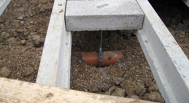

epsilonGreedy Posted June 25, 2018 Posted June 25, 2018 I am contemplating running a foul drain through the block & beam suspended floor void and then out through the foundation on the other side of the house plan view. The longest pipe section i can find is 6m. Do such pipes come in longer sections, I ask because I want to reduce the number of joints in such an inaccessible location?
PeterW Posted June 25, 2018 Posted June 25, 2018 6m is the max but may be on special order as 3m is the norm these days. 6m is also a pig to get at the right fall as you can easily get 150mm flex in a length if you pick it up in the middle.
epsilonGreedy Posted June 25, 2018 Author Posted June 25, 2018 2 minutes ago, PeterW said: 6m is the max but may be on special order as 3m is the norm these days. 6m is also a pig to get at the right fall as you can easily get 150mm flex in a length if you pick it up in the middle. Ok, I would be looking for a 10m section in order to get a joint free horizontal run, maybe my time would be better invested researching quality components and jointing techniques. I reckon this drain pipe will be mid air which implies some special support.
PeterW Posted June 25, 2018 Posted June 25, 2018 10m doesn’t exist in 110mm uPVC It needs supporting either on brick or block piers or supported from under the floor so you need that detail sorted before the beams go on if you are having beam and block. Is it the best route to go under the floor - what is on the BRegs drainage plan..??

Mr Punter Posted June 25, 2018 Posted June 25, 2018 I like the base of the stack radius bend supported on the foundation on mortar / concrete. You can support the pipework by suspending from the beam and block, but I would want to see stainless banding for this https://www.toolstation.com/shop/Construction+Materials/d210/Builders+Metalwork/sd2797/Stainless+Steel+Banding/p48657. 6m max for pipework because plastic expands / contracts and 10m is impractical.

Russell griffiths Posted June 25, 2018 Posted June 25, 2018 Don’t even consider that mdpe it is the most unbelievable awkward stuff to use 3m lengths with joins is the norm, don’t try and reinvent the wheel. The pic is a bracket you can use. I personally wouldn’t as no matter how close you place them over time you WILL get settlement and a small bow in the pipe i would want a full bed under the pipe for full support, either pea gravel or a lean mix of concrete i have four toilets going in and two of them are internal so no other way but to have pipes under the floor, I do not consider it a problem
