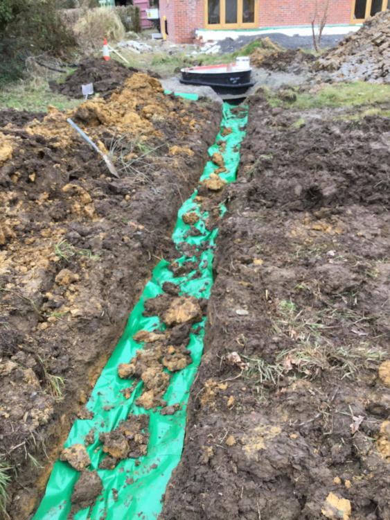

Ed Davies Posted September 9, 2018 Posted September 9, 2018 54 minutes ago, ProDave said: "rumbling drain" is a new expression to me? care to explain? Yes, was new to me, too, and didn't respond well to web searches. It's sort of like a French drain where the output of the treatment plant gets mixed with surface water and has a chance to clean naturally before it reaches the watercourse. Specification I submitted to building control attached. 57 minutes ago, Crofter said: The reasons for not using a soakaway would be if you don't have enough space for one, or if the ground conditions are unsuitable (e.g. high water table, slow draining clay soil, rotten rock which drains too fast). First question SEPA asked was “has a percolation test been done?”. For me the test had been on behalf of the vendor and found it didn't - there's solid clay just below the surface (on top of rock only about 500mm down). If the ground percolated they'd have wanted some sort of leach field/soakaway rather than going to a watercourse. Perihelion Rumbling Drain.pdf
