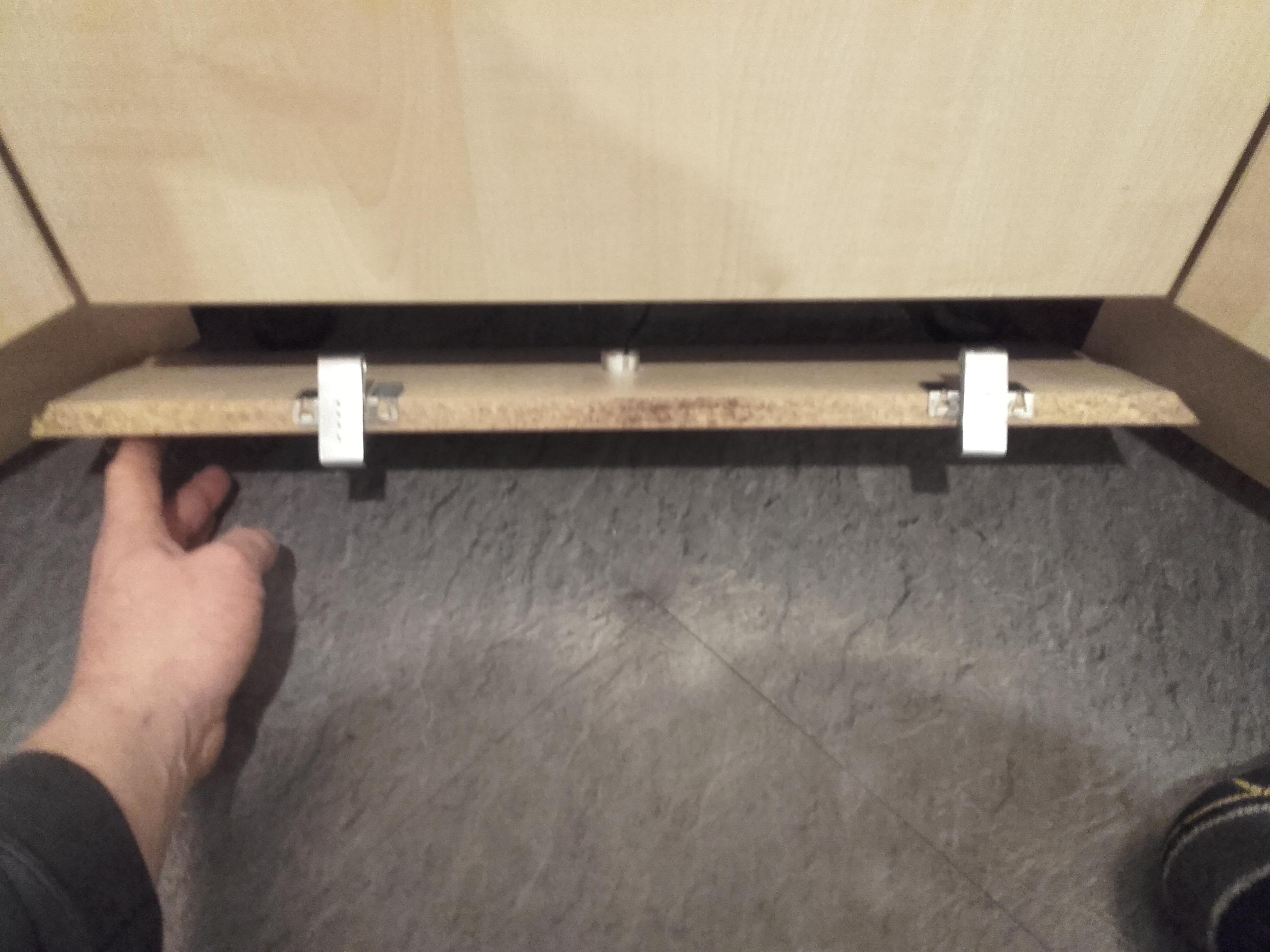

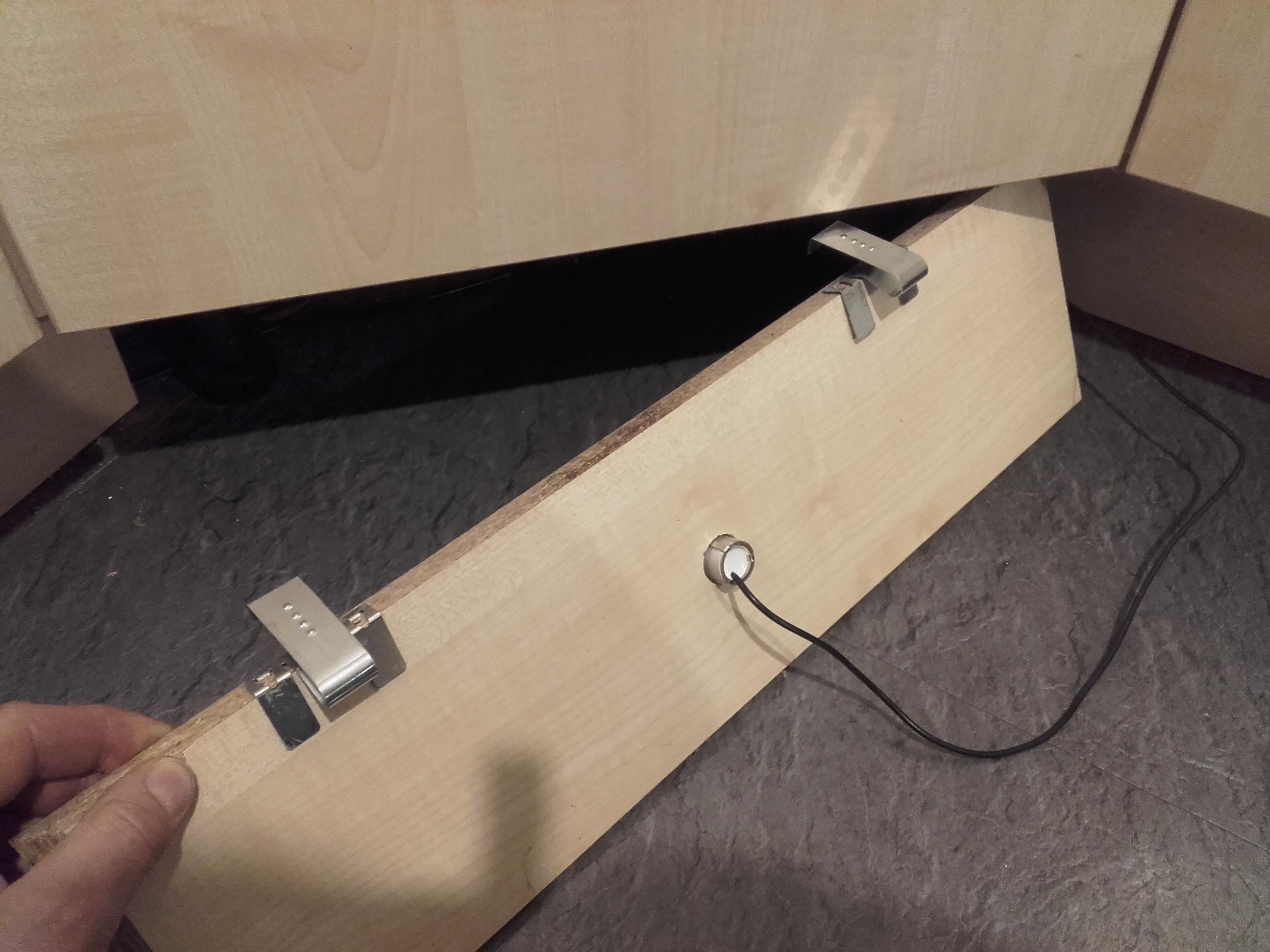

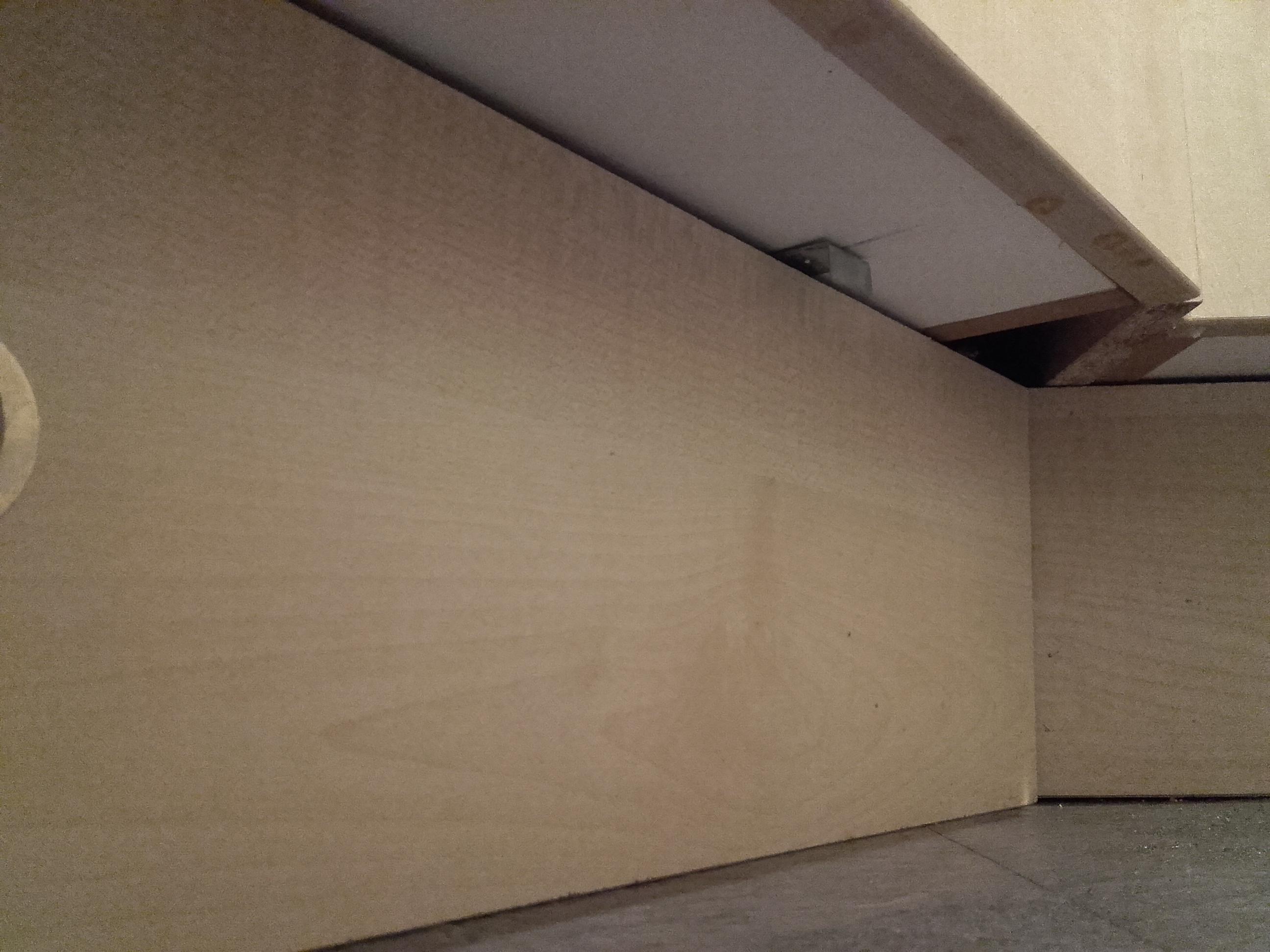

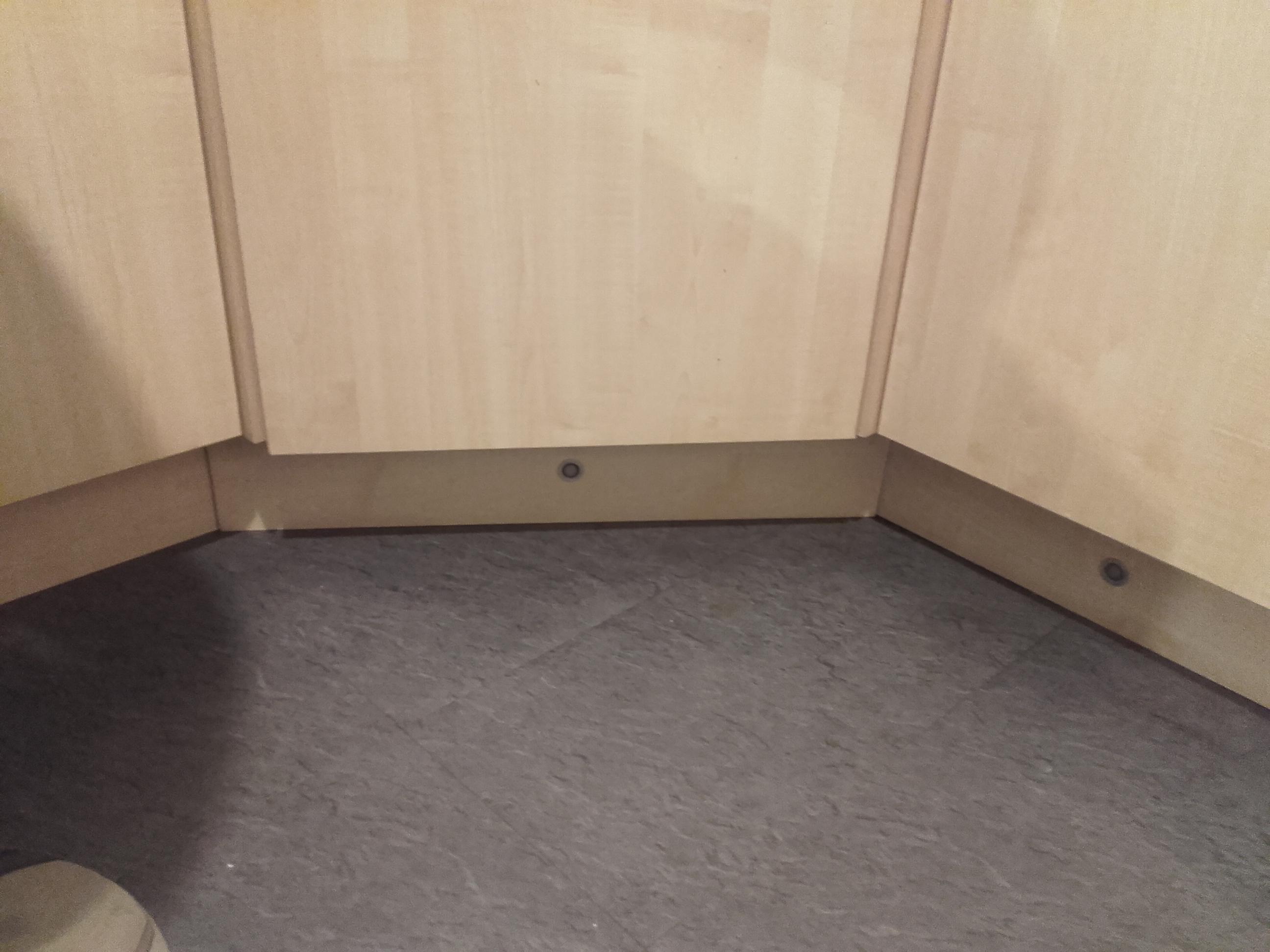

zoothorn Posted January 22, 2019 Author Share Posted January 22, 2019 @Onoff can you explain those plinth turbo clip things? New lino & skirting done (pics to follow) Im onto the plinths/ one of my final stages. So its what stuff to buy, & how to fix them onto cabinet chipboard 'edges'. A reminder of what I have to go with (older pic).. Link to comment Share on other sites More sharing options...
Onoff Posted January 22, 2019 Share Posted January 22, 2019 @zoothorn, you need to cut the plinths just right height wise. I cut mine a bit tight. Broke a bloody nail getting these pics! Link to comment Share on other sites More sharing options...
zoothorn Posted January 22, 2019 Author Share Posted January 22, 2019 So the clips: are they just a spring then, that squashes the plinth between floor & cab above-? And do I have to use specific plinth-stuff, bc of the thickness to use the clips maybe, or what can be used? Link to comment Share on other sites More sharing options...
Onoff Posted January 22, 2019 Share Posted January 22, 2019 (edited) 22 minutes ago, zoothorn said: So the clips: are they just a spring then, that squashes the plinth between floor & cab above-? YES Quote And do I have to use specific plinth-stuff, bc of the thickness to use the clips maybe, or what can be used? THEY HAVE A COUPLE OF SHARP POINTY PRONGS THAT EASILY TAP INTO CHIPBOARD. AS I SAID BEFORE YOU COULD BUY ONE V GRADE T&G CHIPBOARD FLOORBOARD AND RIP INTO STRIPS. PAINT BLACK? As I think I said before I've a bunch of magnetic catches that might work I was going to use for the removeable bath panels but with the tiles they're too heavy. You're welcome to them. Tbh they're getting in the way. These: https://www.ebay.co.uk/p/Access-Panel-DIY-Kit-Make-Your-Own-Any-Size-Tiled-Control-Hatchmu1/1762505231? PM your address and they're yours. Edited January 22, 2019 by Onoff Link to comment Share on other sites More sharing options...
